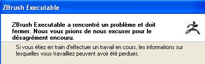

3 seconds after beginning the loading!
“zb.exe have seen a problem and must close” :rolleyes:
the funny of the story is that 3.1 works like a charm :cool:
3.5 3.r2 don’t want to run :eek:

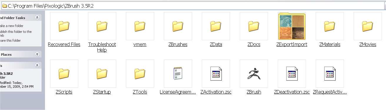

Does the Zbrush 3.5R2 folder can be anywhere and not obliged in the Programfiles folder?

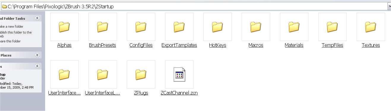

Check the zstartup folder should be a tempfiles folder
Support are these correct folders and files for the zb3.5r2 folder and zstartup folder?
](javascript:zb_insimg(‘158395’,‘Image4.jpg’,1,0))
Spaceman
That is all correct.
Paul
Ok, most of us had to build this folder for ZBrush to run without error messages.
By default this folder (TempFiles) should be empty.
ZBrush writes some temporary data during launch into this folder, but after each session it should be emptied out.
