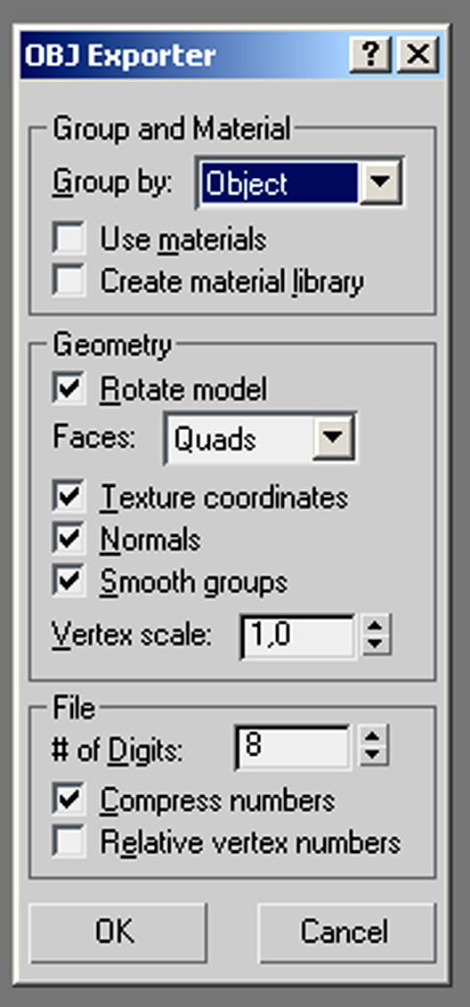

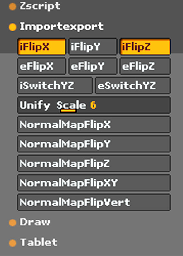

hello!!! I m a new zbrush2 user…
I’ve tried many things with import/export in zbrush2, I regularly use 3dsmax7
and i had the same problems…
I 've found a solution for obj export :
  • transform mesh in editable polylook
  • choose option “export selected” in file menu
  • choose file name with “obj” extention
  • look at here below screen capture, you can see that “relative vertex numbers” is unchecked:
  • import object using “tool” menu
  • concerning export: don’t make any change.
    ENJOY ! IT WORKS !
