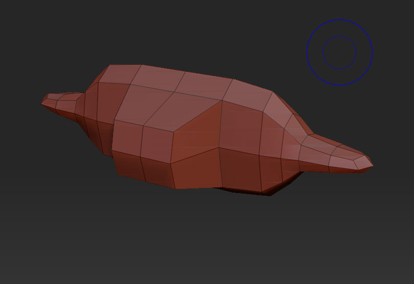

Doesn’t work for me either, which is very strange cause my other models, much more complex then this, are working fine.
Also it seems all the default models on the splash screen (Soldier, the dog etc) work fine with 100% sym, except for the sphere which gives 0% !!
Maybe it just doesn’t like simple models cause they insult it or something :lol:
lol … you know… you might not be crazy for thinking so because similar idea did spring to mind :cool:
Well it seems you are right, we both are not as crazy as you may think.
If i take that blob, and i do this to it, i suddenly get full symmetry.
So it is definitely looking for some sort of complexity minimum in the mesh. Damned if i know what though.
great find man! you’re right… if i do that i get full symmetry as well…

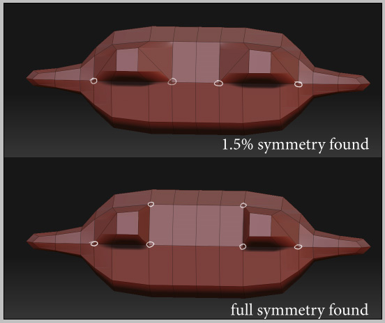

ok… that’s a clue… so what’s new in the model- it’s 5 edge pole!.. ie 5 edges that share same vert… you don’t have such a pole in startup sphere and you do have it in the soldier for example…
Looks like it’s designed to recognize anatomy to me. :wink:
hahah lol! :slight_smile: cool conceptual thinking there marcus! :slight_smile:
ok… it looks like it needs 3 poles to figure out symmetry…
with two poles i got 1.5% (ie those 4 verts out of 130 total/ 2… i get exactly the same value- 1.53846%) and with 3 i got full symmetry… see attached image…

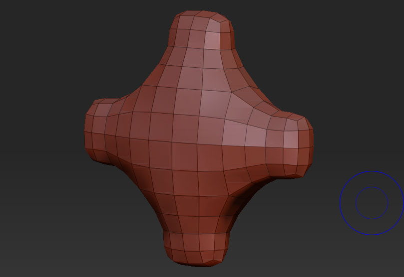

But wait, this also fails (and it has 4 poles)
bah!
at least it works if you make breasts for it… i tried :slight_smile:
perhaps you need more poles as you have more axis of symmetry (topologically wise)… your model for example has 3… and even though you probably didn’t activate all 3, perhaps that’s the way algorithm works
Hmm, looks like this feature don’t like models which symmetrical MORE then one axis? Or have radial symmetry?

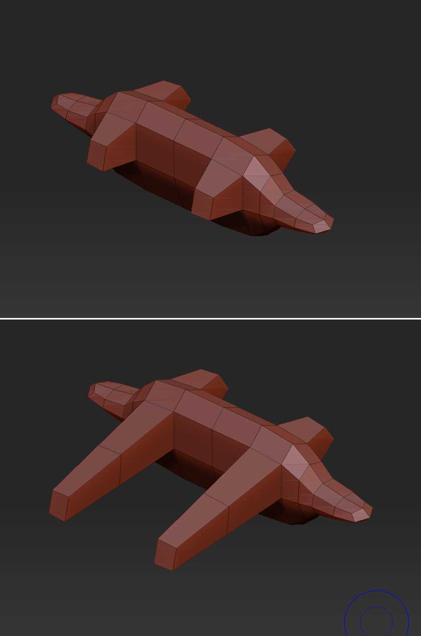

Could be… In this, the top one doesnt work (i get 1.6% sym) while the bottom one gives full sym !
Maybe it does indeed calculate the complexity on each axis independantly…
