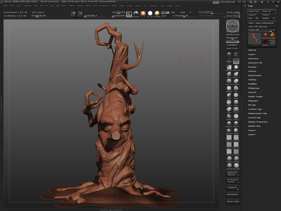

An update on the tree…
[VV]27083273[/VV]

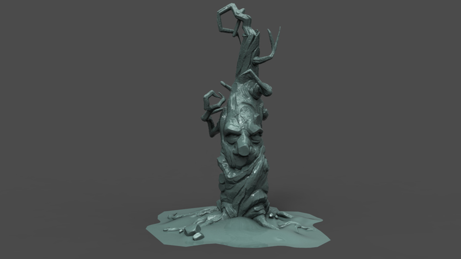

Here is a quick render test (Mental Ray) for the tree. I’ll try to finish up the sculpting and maybe do a quick polypaint on it too.
[VV]27101777[/VV]

Was mostly wondering what tools you use for what, but i somehow managed with pausing it every 3s, and noticing there is a hd option ;D Need to take another look at your ui ;f
But still i have no idea how you get those sharp crisp shadows, my shadows on matcaps always look blurry and crappy ;(
For tools I was using:
Dam standard to do the initial carve in and pull outs. If I want to accentuate a change of planes, I use Dam Standard with a negative setting on one end of the plane, and again with a positive value on the other end of the plane. If you like, you can use one of the polish or flatten brushes to flatten the plane as well.
For shadows, go in to the render tab, under BPR Shadows, set the blur to 1 and also try adjusting the intensity up a little depending on your needs. Hope that helps some. Let me know if you still need me to make a video (no trouble at all if you do).

what the hell man, i didnt even know there was a bpr render option. I always thought all those sss and transparency options were continuing the tradition of having broken and not working tools ;D
And i like how the dam standard brush dosnt even show up in the brush window, you have to find it ;D
thx, im gonna play around with all those fancy options, and see what they do.

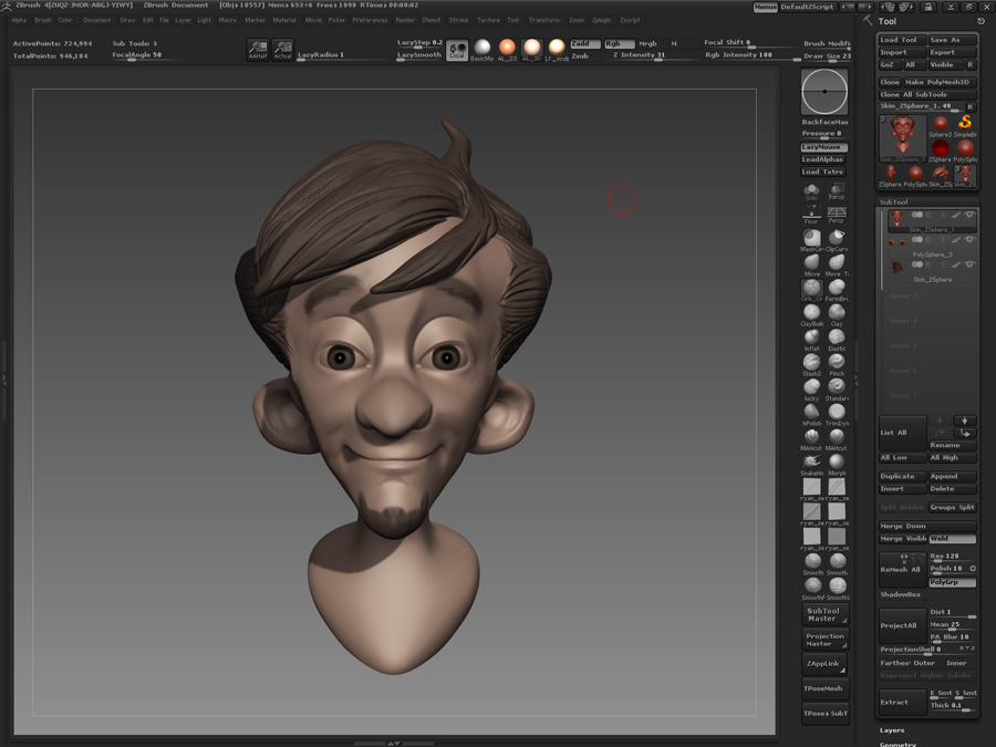

Here is a small update. I’ve been really busy @ work and on this little side project. Here is a quick 2D and 3D pass at a character design.
[VV]27691292[/VV]
