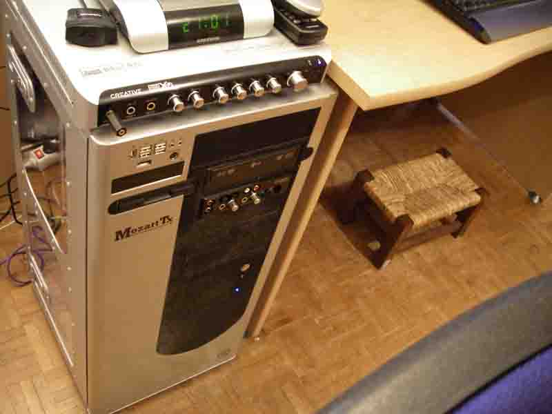

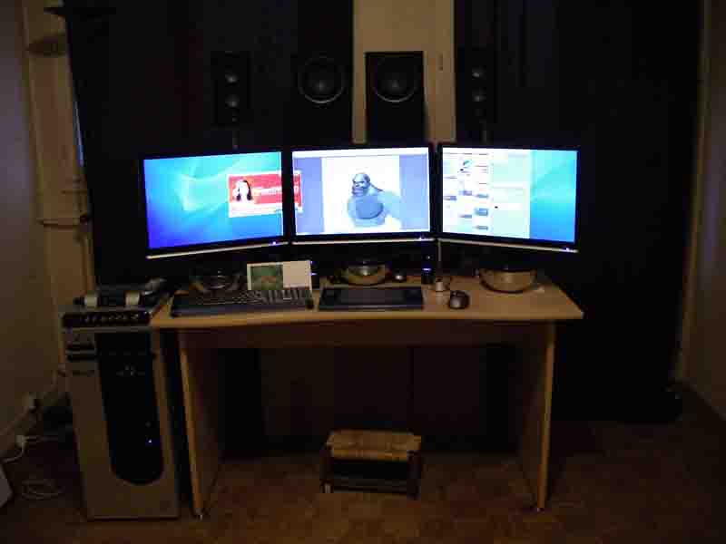

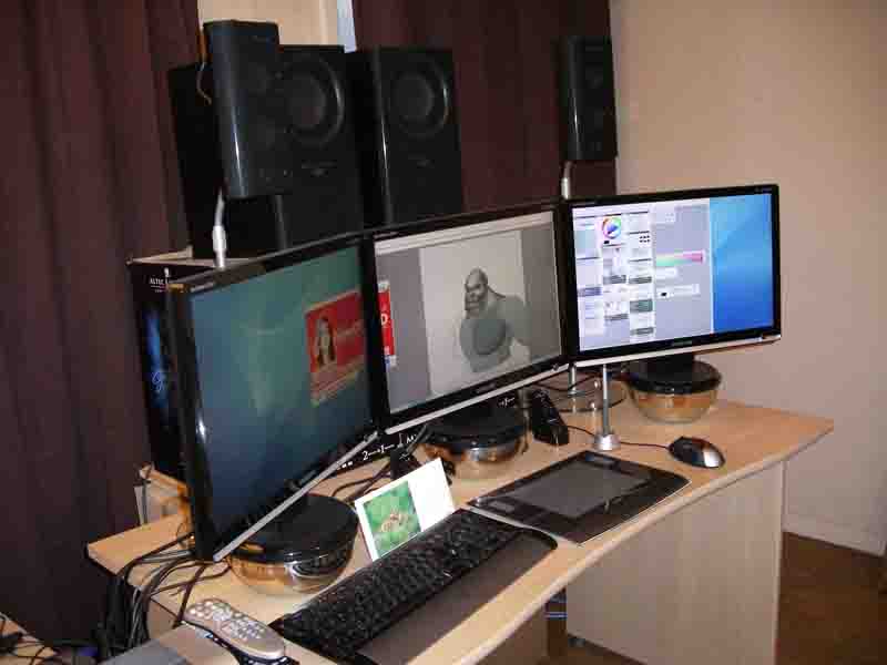

Here I send u pict of my computer.
Quad core e6600
4Go ram

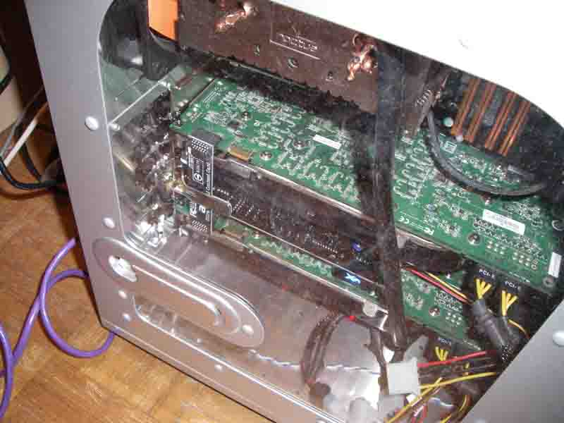

2X8800 GTX SLI
2xraptor 40go
MB Abit max
4 external hdd ( over than 1600 go store )
3x 22’’ samsung 226bw
Tablet wacom Intuos a5( I don’t recommend u a4, i used to have but finally it is very giant to a normal desktop…
I send u pict of my home system
2xthx system altec lansing

Hi paufer, I don’t recommend you to have 2xvideo card to work, because the drivers are not optimized to work with 3d soft. In my case working on 3 screen with zbrush doesn’t make any problem, but with other soft like 3dsmax ( for exemple ) it crash evertime. So even a small video card work well with zbrush, but for others softs, prefer work with professionnail card fully compatible with OpenGL.
