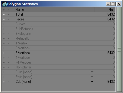

I am attempting to look at one of the models to check for ‘n-gons’, but I don’t see a ‘statistics’ panel. The version of Lightwave Modeler that I have is 7.5. Does the panel you referenced exist in this version?
Thanks again for all your help. I really appreciate the detail of your answers and explanations.

You’re welcome! I’m happy to help. The Statistics panel should be there in LightWave 7.5. Tap the “w” key and it should open up. The functionality of the Statistics panel hasn’t really changed over the past several versions of LightWave so everything I’ve described should work fine.

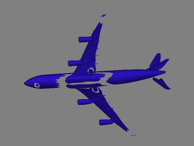

The ‘W’ key did toggle the stats window that you mentioned. I was hopeful that the model was going to contain ‘n-gons’ and that I could ‘fix’ the problem with the information you had provided.

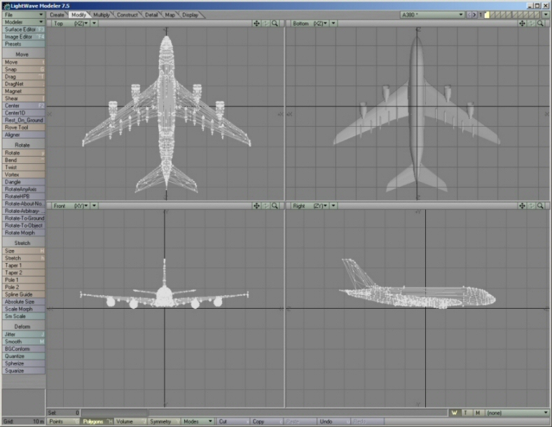

I’ll show you what I’m running into at this point and maybe there’s something else I should try…

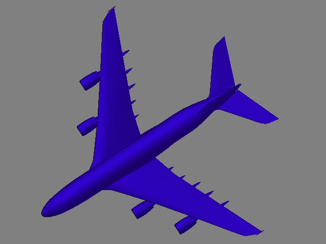

Here’s a snapshot of the model imported into LW:
To me the model looks ‘ok’ in LightWave (of course I have no idea what ‘ok’ would look like). It also looks ‘ok’ when I first import it into ZBrush. But even after just the first time I click the ‘Divide’ button portions of the model go blank. And this happens on every model I’ve tried so far (only 3 so far).

Hmm… Where did your boss get those objects? The model looks okay in the shaded mode, but the wireframe mesh is horribly triangulated. It looks like a low-poly version of a higher resolution object which has then been run through a Polygon Reduction filter. Ugh. Well, that will make things a bit more difficult but not impossible.
Okay, first things first. Don’t hit the Divide button. You don’t need to. The only reason to hit the Divide button is to add more polygons. More polygons are only needed if you want to sculpt details onto your mesh. (Sculpting involves the manipulation of the polygons which deforms the shape of your object. Painting (in this case) refers to the creation of texture maps which affect teh color and shading of your object, but not its overall form.) Since you only want to paint textures onto the plane, you don’t need more polygons. And therefore you don’t need to hit the Divide button. :slight_smile:
As an aside, the tearing you see when you do hit Divide may be caused by overlapping points that have not been welded or merged together. On a 3D object, points can occupy the same space, but that does not mean that they become fused together into one. Unless you tell the software to do so. If your plane has overlapping points (indicating areas that are not fused together), they may shrink when you try to divide the object in ZBrush. Try opening the object in Modeler and pressing the “m” key to bring up the Merge Points window. Accept the defaults (Automatic Settings) and press OK. A message will appear telling you how many points were merged. If it’s anything higher than zero, that may have been the problem.

As a quick note: the ‘weird streaks’ that you mentioned are exactly what my problem has been so far. When I drop the model in the Projection Master it looks good. When I paint in the Projection Master it looks good. But when I pick the model back up (exit Projection Master) it immediately gets the ‘weird streaks’ you described.

Since your object’s mesh is so garbled, it’s going to be difficult to paint it using Projection Master. You can try to clean up the mesh, but I think you’re going to find that it’s a losing battle. For this job, I would recommend using standard projections and using Photoshop to paint the textures. Below is an image that shows the basic process.
You’ll need to isolate the different parts of your object (i.e. the Fuselage, the Wings, the Tail, the Engines, etc.) and create different surfaces for each one. Then use the technique shown below to create textures for their top, front and side views. The technique below also shows how to blend the textures from each projection together to avoid stretch seam marks. The blending in this example is fairly noticable, but when you’re blending more similar looking textures the results are nearly invisible.

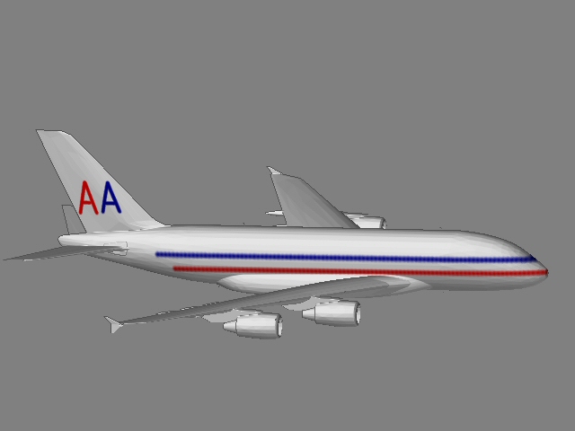

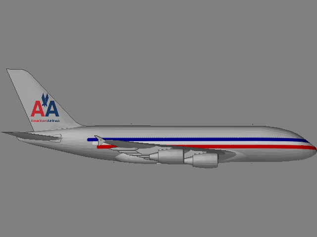

Just thought I’d post a couple of images showing progress so far. I did a really simple, quick and dirty paint job to test the process of creating the UVMap in Modeler, exporting to ZBrush and painting in ZBrush. Following is an image captured from ZBrush:
Excellent! I didn’t know if that would work with the mesh being so unruly, but I’m glad it did. Using an Atlas Map from LightWave is often the solution when ZBrush’s AUV/GUVs fail.

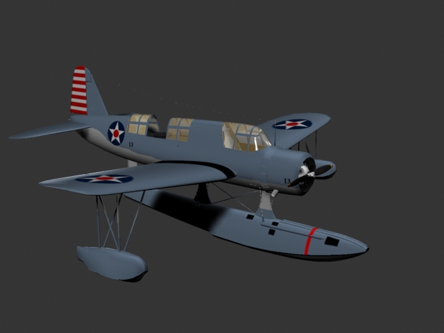

This is a pic of the plane that I am texturing in zbrush.
For the decals I use the zapplink plugin that allows me to take the painted model from zbrush to photoshop and place the decals on top where I want as a new layer. The decals ae the navy insig, tail stripes and numbers.
I continue placing the decals with projection master and zapplink untill I am all done. The next step will be to create the panel lines and rivets with the bump material. I dont divide this model because I get the same model tearing and I am using a bump map not a displacement map.

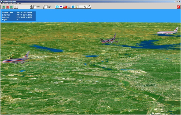

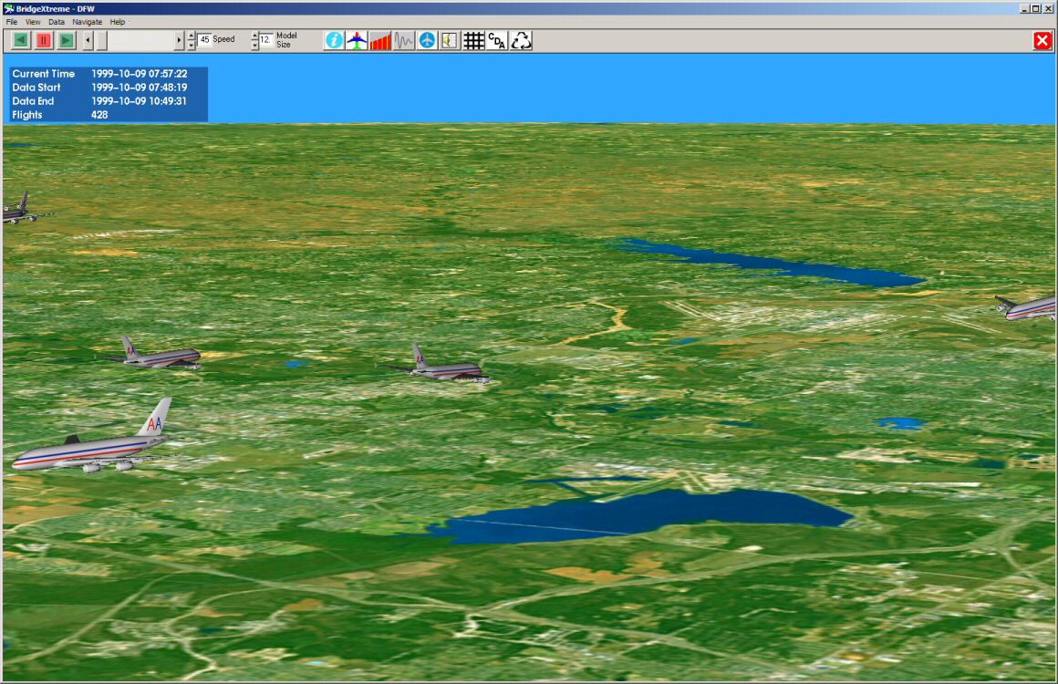

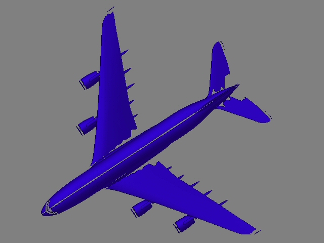

I’d like to show you a couple of very simplistic (but exciting to me) screen shots…
Here’s the model in ZBrush:
As I’m sure you’ve picked up on we don’t need very high resolution models / textures for the scenario we are in. I’ve even oversized the models in the animation environment for the sake of snapping screen captures.
I was completely frustrated at my inability to grasp these tools (LW and ZB). However, with your help I can see light at the end of the tunnel…
