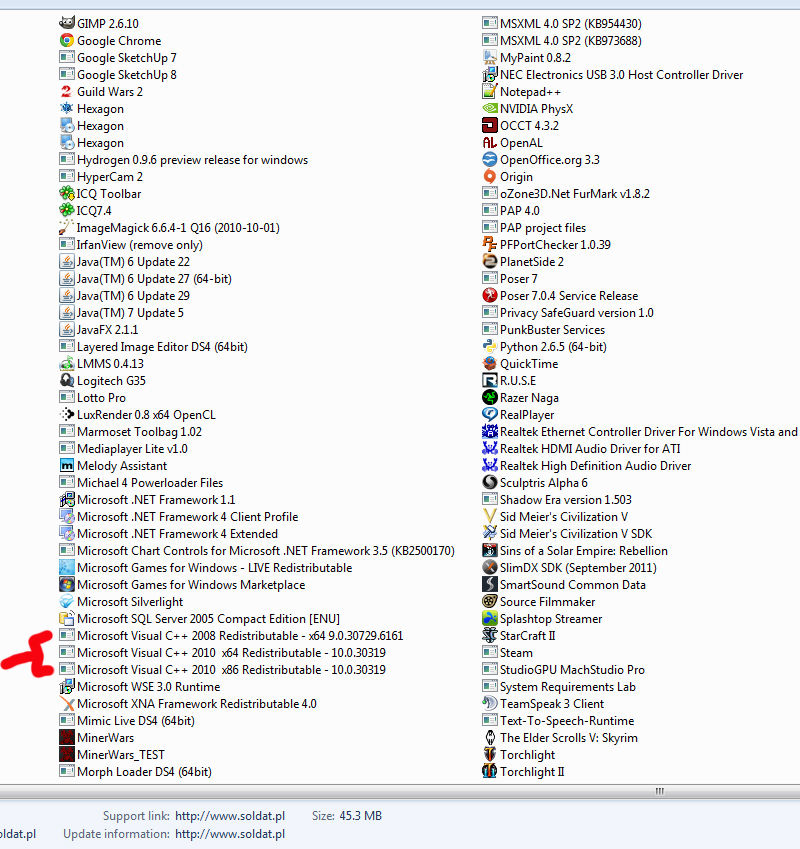

here is a snapshot of my control panel programs list. This is what was added after I ran both vcredist.
What is our next step sir?

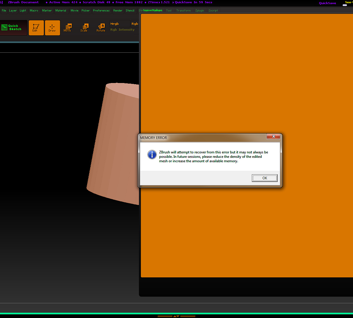

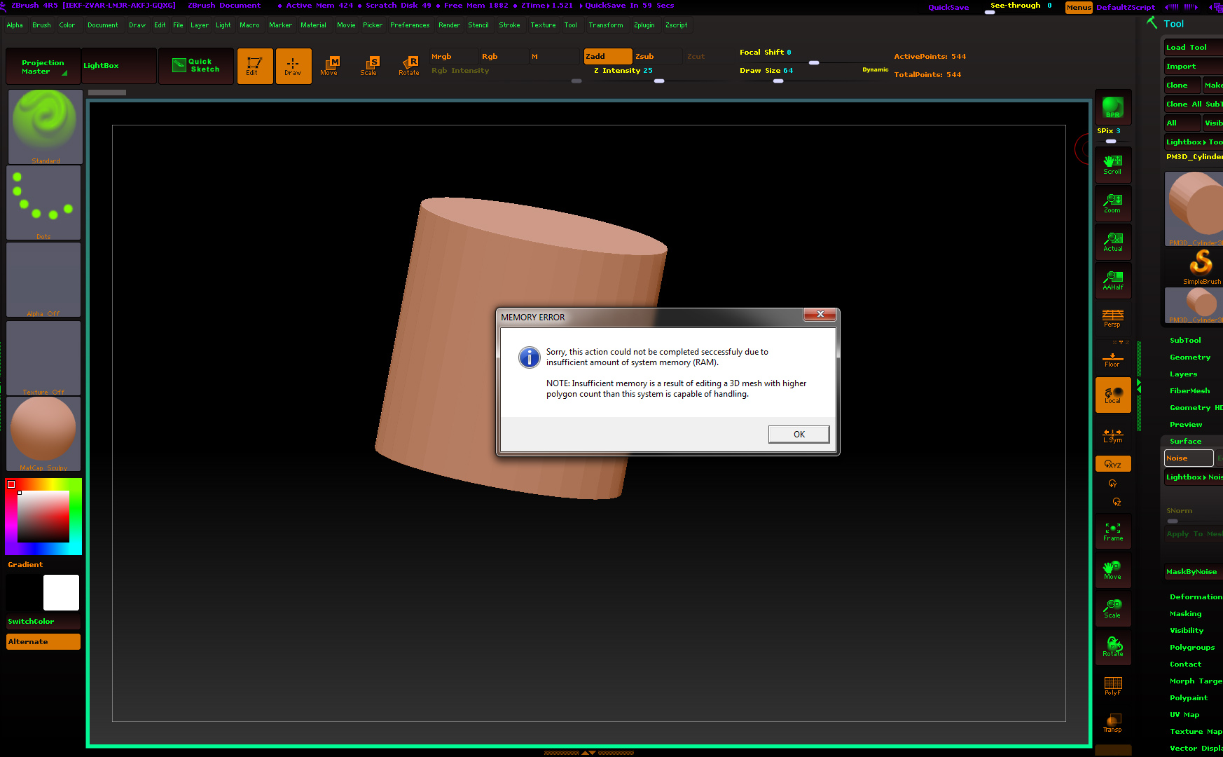

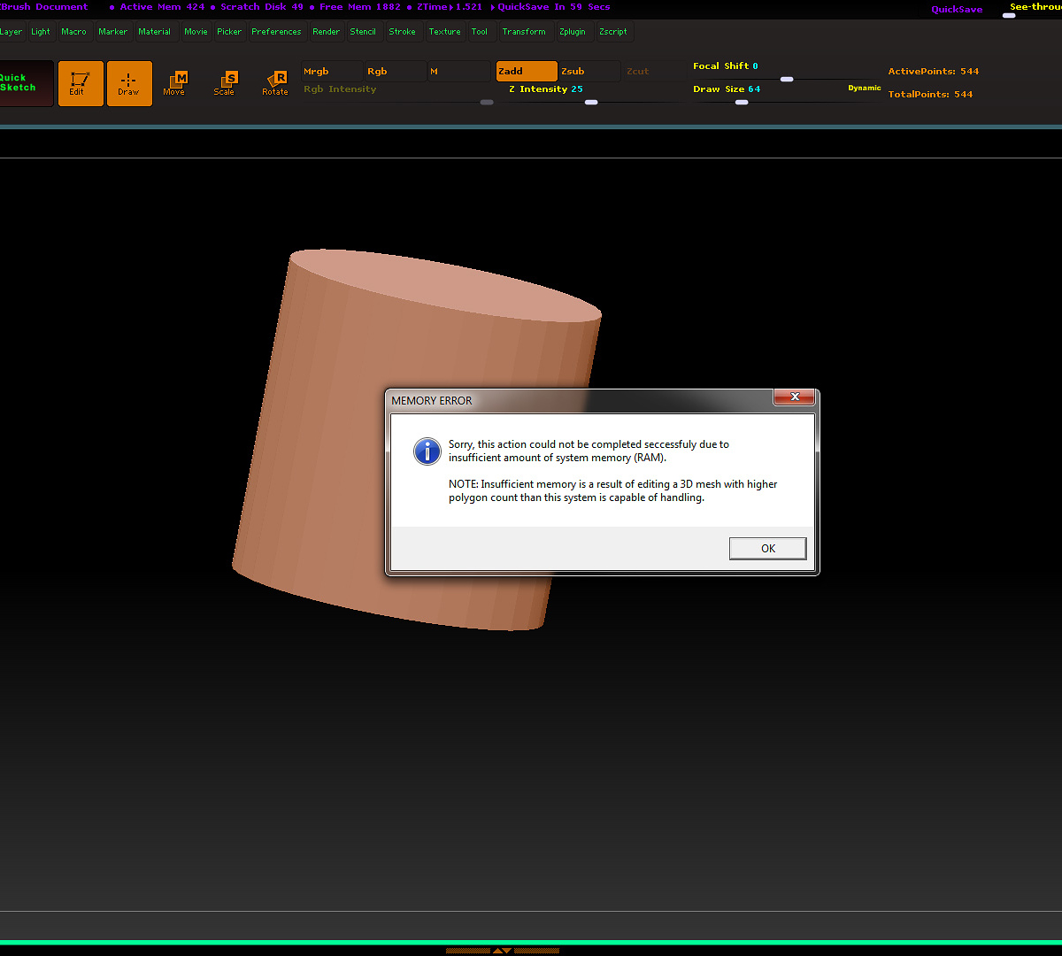

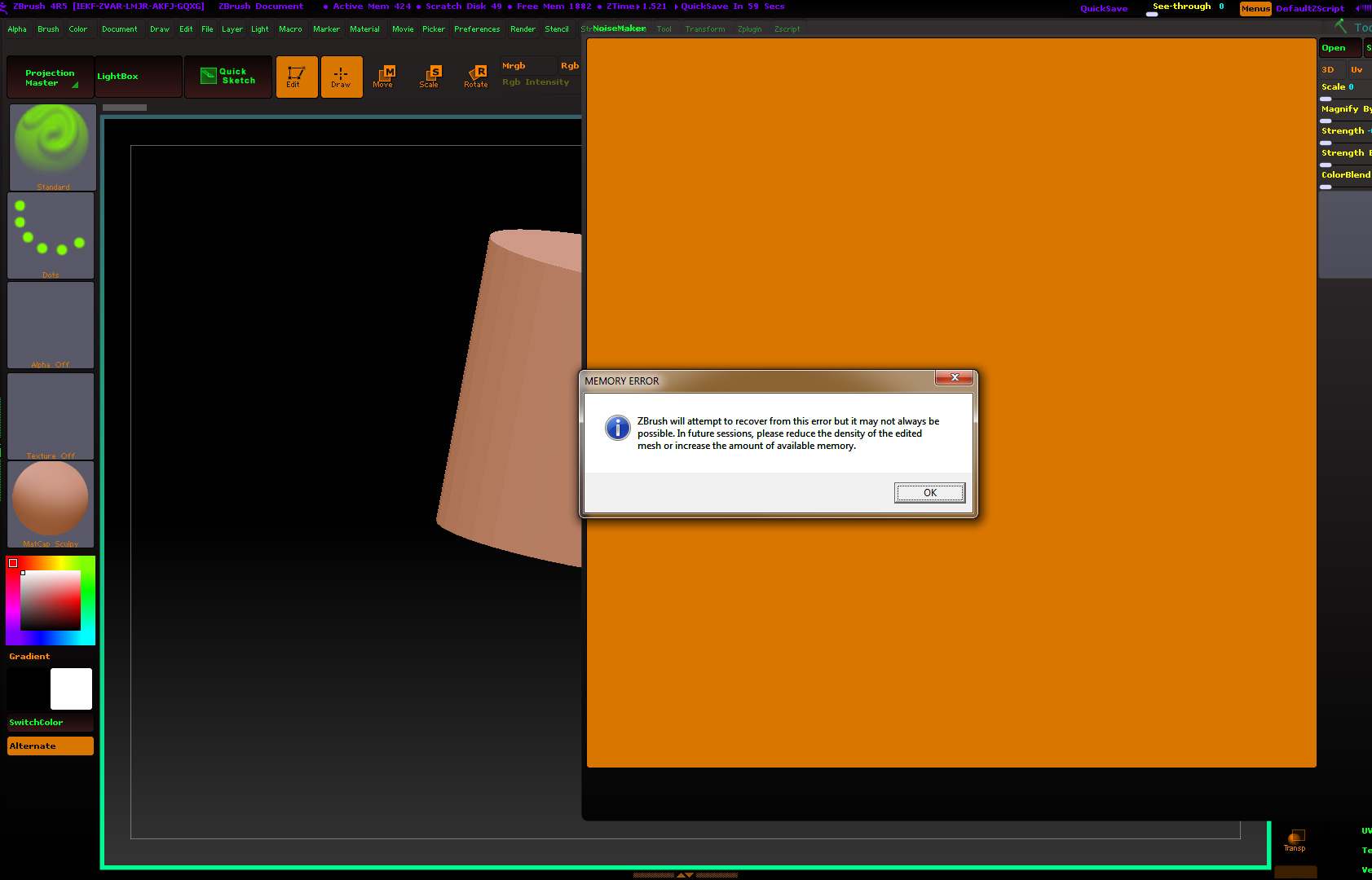

ok I had an odd thing happen while trying to reproduce the crash.
using the same steps above, Minus the Sub D, I got this window popping open:
This Mesh only had 1 Sub D.
then after hitting ok for the 2nd time Zbrush decided to crash on me…

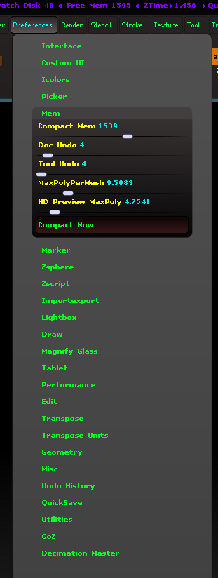

SO next I decided to take a screenie of my mem tab setting to show you what I have it set too:

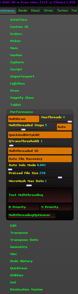

and in case this helps I took a screenie of my performance tab:
I went to look for today’s crash error and I was unable to find it in the Administrative events Log. Its as if Windows dose not seem to think this crash is worthy of logging :mad: grrrr. Gotta love MS…
so to reiterate, I have 4 gigs of ram, 64 bit OS, 4 core amd Processor.

The insufficient memory error, under the circumstances that you describe, indicates that for whatever reason ZBrush was unable to make use of the C:\Users\Public\Documents\ZBrushData\VMem directory. (Or if you’ve edited your ZBrushScratchDiskPath file, then whatever location you specified for the scratch disk data.) There are a few possibilities:
  • Your drive is getting really full.
  • Your drive is badly fragmented, so that although there is a lot of free space the chunks are too small for ZBrush to use.
  • Something is going wrong with one of your RAM modules. The best is to test with MemTest 86 – which is a royal pain since you have to remove all but one stick of RAM and then test them one at a time. You should run at least two full passes per stick.
  • There’s a permissions issue preventing ZBrush from writing its scratch data. This is unlikely as you would get the error every time you try to do anything.
  • Windows is going kaput. Depending on how heavily you use your computer, Windows is typically only stable from six months to about two years.
  • Spyware and/or viruses can be sucking up resources and playing merry hell with other stuff on your computer.
  • Your installation of ZBrush is corrupt, in which case a FULL reinstall (where you delete the ZBrush 4R5 folder and the ZBrushData folder before reinstalling) would fix the issue.
Those are the things I can think of off hand. The NoiseMaker crash is almost certainly a matter of a .dll issue. The steps I had you follow before USUALLY fix that problem. The only time that they don’t is when the problem is more fundamental. For example, if Windows didn’t let the C++ files uninstall properly then there can be a conflict when they’re reinstalled. The fact that you also got that random virtual memory error is what makes this particularly nasty. With what you were doing at the time that you got that error, I don’t think that virtual memory should have been necessary at all. The fact that ZBrush was trying to use the scratch disk for that implies that there’s a RAM issue. After all, virtual memory is only used when available RAM isn’t sufficient for the task at hand. But the fact that ZBrush then couldn’t even write to virtual memory escalates the issue. It’s conceivable that bad RAM could be at play in that ZBrush was trying to move data from RAM to disk but the RAM misbehaved and ZBrush threw the only diagnostic error it could. Or it could be that the problem is in the OS itself.
Now you said that you have multiple computers. Have you tried installing ZBrush on one of the other computers and doing the same things with the same files? If you get the same error on both machines, then there’s a problem in the files or in ZBrush. But if you get the error on one machine and not the other then either the ZBrush installation is flawed or the computer is.
Hopefully all of this info at least gives you a good idea where to look. At this point the only way to get to the bottom of the issue is to systematically troubleshoot. I would start with tests on a second computer to rule out ZBrush itself. Then move to a full reinstall of ZBrush on the problem computer. Then on to the deeper diagnostic things, probably starting with MemTest 86.
