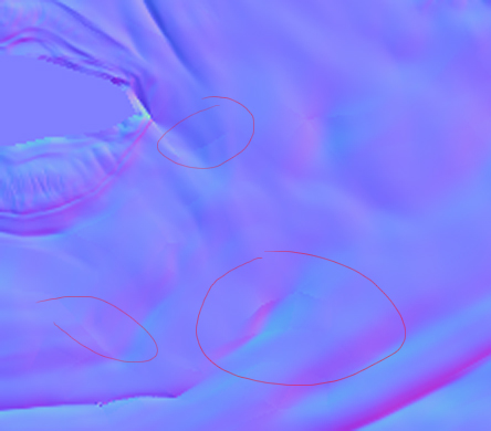

i m having an issue with NM from zbrush 4, i m getting some artifacts, and looks like its comes from the hard edges on the low sub-D mesh. and its doing to all the object i have tried on.
would if anyone have the same issue
[attach=219053]NM_test.jpg[/attach]

angrykid,
Are you using the Smooth UV option?

And onto his problem… would smooth UV fix that result in displacement meshes too?
If Smooth UV is the problem, yes.
