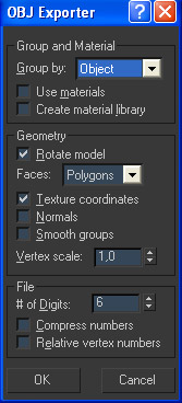

What did you enter at the OBJ export dialog in the “# of digits” field? There was my problem…
I solved the problem putting 6 on the number of digits

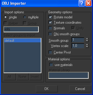

  3. import the obj to Max with settings: Single switched,Rotate model and
    Texture coordinates turned on

  5. export it with these settings: Group by: object,Rotate model and
    Texture coordinates turned on Faces:Polygons vertex scale 1 digits:6
