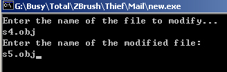

Hi upham, thanks for your ideas but I got tired of playing with settings in all these different apps just to export a file from max back into a zbrush subdivision model so I ended up writing my own little app and it does the trick.
It makes a whole lot of assumptions, so I don’t know how useful anyone else would find it, but it works on the models I’m using it on so far.
I tested it out by moving around some verts on my model in max then importing back into the zbrush subdivision and it works good.
If anyone would like to try it out you can leave me a message here and I will get back to you. I’m too embarassed to post it up :laughing:
I spent the past two days writing it, and it wasn’t quite as simple as I thought but it sure felt great finally getting it to work and testing it out and not seeing my model explode for once. :+1:
Aside from the all the quad vertex data being swapped around, max writes all the triangle data at the bottom of the file so that needed to be put back in order too.

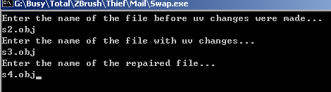

OK, I’m almost ready to post it up. I just gotta make a couple minor additions and write up a decent help file. I am able to move geometry around in max, and also change uvs and reimport into zbrush subdivision without exploding object. It was tricky :smiley:
Here it is. Using the two apps included in the file I can change my uvs and move geometry around in max and import back into my zbrush subdivision. There’s a short description of the process included. It’s not exactly a straight forward process but it’s the only way I’ve been able to do this. I’ve played with so many different apps trying to get this to work with no luck.
Let me know if you find this useful. I’d get a cheap thrill out of it :smiley:
I changed the instructions a little bit. There was an error in one of the steps. Also I included some pictures of max and zbrush settings to get things working. Thanks to Boa for helping me figure some things out.
OK I hope nobody is getting annoyed with me constantly replying to my own thread by now but after some more experimenting I realized not all obj files can be exported back into zbrush subdivision by simply converting to editable poly.
So once again my program is useful, at least to me :lol: Anyway I’ve made some changes to it. I’ve reduced the two apps into one, and made some other updates so now it works properly on editable poly and editable mesh objects in max. Before it would only work on editable mesh objects. It also deletes all the intermediate files it creates which were annoying.

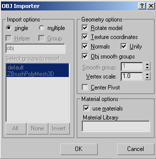

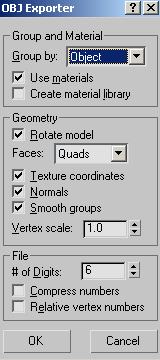

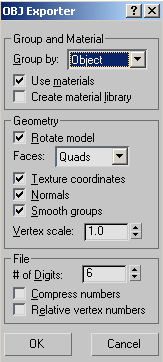

Yes andreseloy is correct. Turn off the groups before exporting from zbrush. Also turn off normals, and groups in max for both importing and exporting. This should get things working correctly. You don’t have to collapse the stack before exporting from max either, but it doesn’t matter.

I uploaded another zip file containing configuration pics between Max and ZBrush and added a bit of info to the read me as well. Same stuff as I mention here pretty much.
