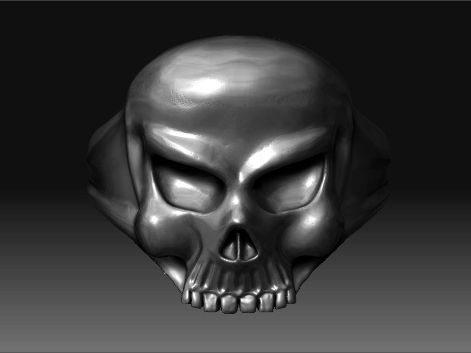

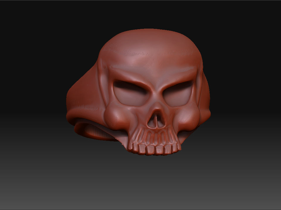

my first skull ring in Zbrush, not much details but for the first model I’m satisfied
small_orange_diamond:)
for your first model its not shabby at all:D

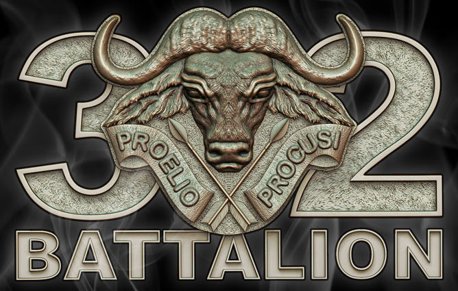

Here is a image I have just done for a book cover of one of South Africa old military units… I was wondering if I set this up as a dog tag type jewelry what would the estimated costs be in say silver and gold?
If its profitable, i am in contact with their veterans association and other military units associations, could be lucrative…
Regards Ziggy
It depends on the volume. The volume will yield the ounces you need. Silver will be a factor less expensive than gold. Rhino and other programs can give you the volume from the dimensions and the model configuration. Sterling silver goes for $22 today per troy ounce and 14Karat Gold for $42 per pennyweight. A pennyweight is 1/20 of a troy ounce. So a troy once of silver goes for $22 (casting grain) and the gold for $840 per troy ounce.
The volume of that depends on the specific weight of gold and silver.
The weight of 1 troy ounce yields a different volume for gold as it does for silver.
It’s late and I’m tired, so I leave it to you to fight yourself through the internets and fiddle the ounces and metrics and imperials and what not together.
Making that mold is simple and might cost you $60 for a master mold. You will be able to make a few hundred till that mold is shot.
Having the items made is pretty much the cost of the material and a bit of labor. It depends if simply tumbling is good enough to finish the items or is someone has to work on them. If the later is the case, the hourly charge of the service provider comes into play. A Chinese job shop might charge as little as $4 where a New Jersey Shop must charge about $65 to $95 because of the cost to do business here. Most likely they ship it out as well… Mail to Hong Kong from New York takes 5 days. Back and fourth… Faster than to LA and back.
