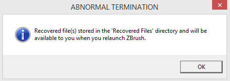

I just Installed keyshot 7.2, but it looks like there is a problem. After Shift+R nothing happens, keyshot doensât start, there is a message though
âUnable to connect to external renderâ
Not sure if that is a problem with keyshot 7.2 or Z2K bridge.
Strange thing is when I start keyshot first then Zbrush, it works but not the other way around.
It is frustraiting to shutdown zbrush, start keyshot then start Zbrush again in order to send a file.
I had keyshot 6 there before and Zbrush 4R7, but I uninstalled them both before I intalled Zbrush 4R8 P2 and Keyshot 7.
Is anyone else getting anythin like that or itâs just me?
Similar situation.
If KeyShot 7 is working now, then the rendering does.
But if the KeyShot 7 is turned off then ZBrush gives an error.
help please
