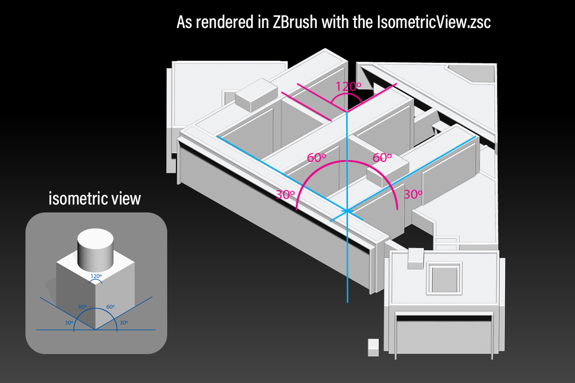

Still an WIP of some buildings I’m modeling, here a rendering I did using the IsometricView.zsc
Exactly what I’m looking for!!
Once again many thanks for both of you for the help.
All the best,
Alex
@AlexLt, That’s great, many thanks for sharing the result!
