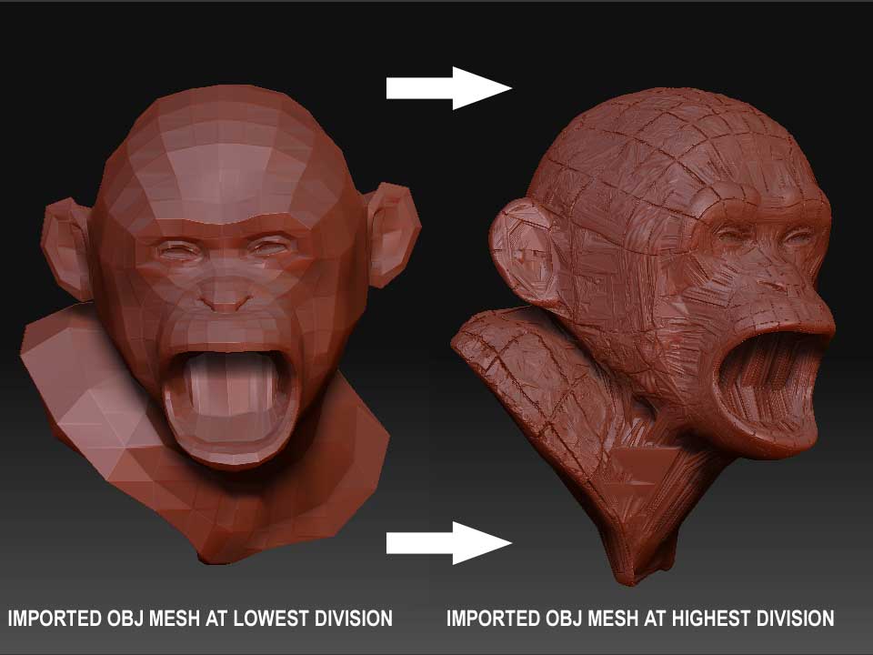

Thanks for answering. I don’t think it is a scaling problem, the mesh is as far as I can tell just the same. I have attached a sample of what the problem looks like.
I really appreciate any help I can get on this!:cry:
I have fixed the import problem itself from all the excellent advice in this thread, but it is the subD issue that really makes me flustered!
thanks again
p

If the scaling is off by even a small amount it will explode.
The basic solution is here.
http://www.zbrushcentral.com/zbc/showthread.php?p=368949#post368949
