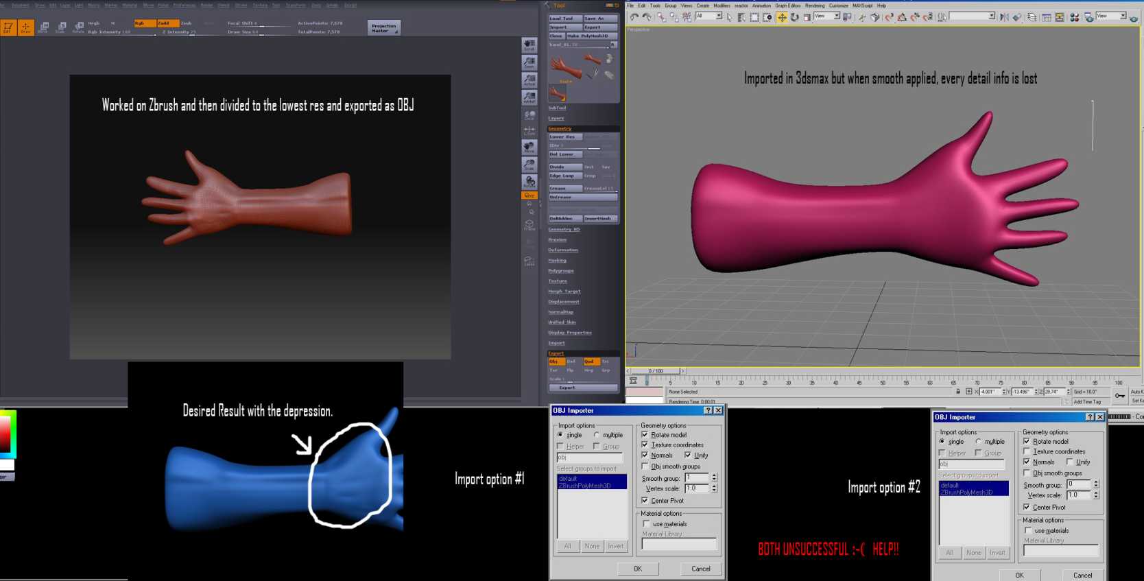

…Is it supposed to be in a displacement form like you guys discussed it in the begining or am is it possible the way I am attempting and just did something wrong. I have the print-screen, a pretty detailed of my problem below. Thanks alot guys…My solution I know is here
