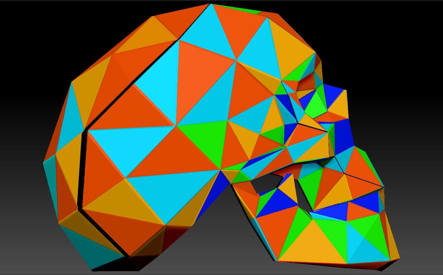

I was able to scale UVs as suggested & there was a definite improvement… lines are gone. Still getting unacceptable weird “mis-mapped” areas & noticeable gaps in between map groups. Sccaled the texture map all kinds of ways to try to match but regardless of alignment the “mis-mapping” still happens when I “create:new from polypaint”. Ideas?
Images show (in order):
- before UV scale with original texture map
- after UV scale with orig texture map
- after UV scale with scaled texture map
- after UV scale with polypaint
- after UV scale with “new from polypaint” texture

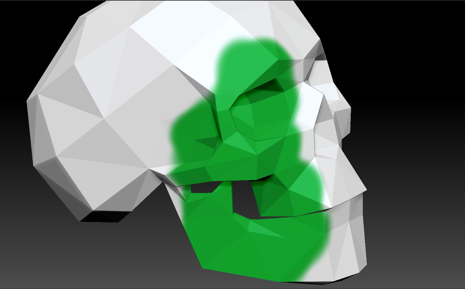

i’m thinking you have something like geometry folded upon itself in areas.
if you mask off random sections at a time and just use fill from the color palette to paint the sections different colors,
then do new from polypaint, the texture might come out clean. if it does then it should mean the geo is the issue.
