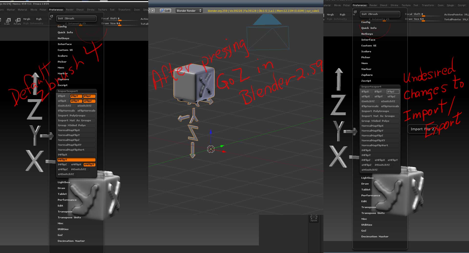

This GoZ for Blender is causing undesired changes in my Zbrush 4 Export/import preferances.
- My model is vertically inverted in Blender.
- The Export/Import options of Zbrush 4 are then changed undesirably
- I've attached a image showing the before in Zbrush 4.
- A model in Blender as opened with the GoZ button of Zbrush 4
- And the annoying changes in the Zbrush Export/Import preferances

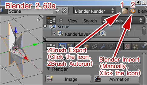

Seems to doesn’t work well for me.
Blender to Zbrush works really fine but Zbrush to blender just do nothing
(i mean nothing appear in my Blender Viewport while pressing GoZ).
Blender 2.6 Rev:41281 (not install, only archive)
Zbrush 4 RC2
Thank’s for your work
Hi bobyy.
Try as see below.
Damned ! Didn’t notice the blender icon :o
Thanks a lot for your help and have a good sculpt
bobyy

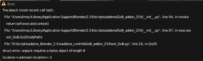

I’m getting an error when using the 2.3 script on my Mac (OSX 10.7.2). I downloaded the script and Extracted the ‘ZBrush’ directory contents to:/Users/Shared/Pixologic/GoZApps. Set the goz preferences in Zbrush to find my blender 2.59 app - all is good with the Zbrush part.
For the blender add-on component I placed the GoB_addon_259 folder and contents into “Macintosh HD/Users/imac/Library/Application Support/Blender/2.59/scripts/addons” and changed the init.py pathGoZ = “C:/Users/Public/Pixologic” to “/Users/Shared/Pixologic”. When I follow along the video with the rhino, I export out of Zbrush and then go to import into Blender with the blender icon in the header, I get this error:
What am I doing wrong?
P.S. Tried this with Blender 2.60a and received the same type of error.

it looks like the already compiled “ext_GoB.pyc” is relying on windows-specific filename paths. as opposed to generic path variables to be passed in, or even mac specific paths with structures like “(uc/Users/designusername/Library/Application Support/Blender/2.60/scripts/addons_contrib/GoB_addon_259/)”
I’ve performed the same fixes to init py as Dougt mentioned. And am able to send objects TO ZBrush from blender, however, I am not able to reImport the GoZ data back into blender when clicking on the blender icon in the menubar(within blender). I get the same error, which looks like its arising from and “D:” drive based file path, that looks to be hardCoded into the “ext_GoB.pyc” file. Has any one found a means of defining the filepath that “ext_GoB.pyc” is attempting to use? This looks to be the last glitch preventing OSX usage of GoB that brings the mesh back into Blender.
Hello Mac users,
We found with doug some mistake in ext_GoB.pyc
use the new attachment file for Mac.
All paths are only in the “init_.py” file.
So edit this file is a good thing, the default path is for Window.
Two lines need to be modified is the “init.py” file:
line44 pathGoZ = “C:/Users/Public/Pixologic”
and
line126 os.system("{0}/GoZBrush/GoZBrushFromApp.exe".format(pathGoZ))

after installing the new “ext_GoB.pyc” you posted, I was able to use the same(edited) init py that I changed previously, and am now able to bring GoZ objects back into Blender; so now all seems to be working well with GoB! Thank you!!!
