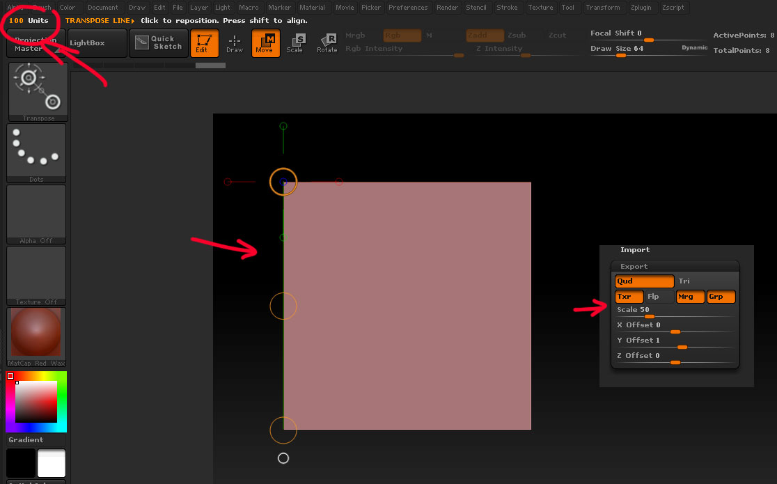

Here is a simple cube for you to test. It is created in modo at 1m. My default units are in centimeters.
Thanks, that’s perfect. When I import this into ZBrush then the Transpose line gives a measurement of 100 (see image) which is correct for a measurement of 100 cm in your original. I imported using FBX with auto-scale on, as with the standard installation of the plugin. The Tool>Export sub-palette shows that ZBrush has scaled the cube down to 1/50 on import and will scale up by 50 on export. This is what I’d expect.

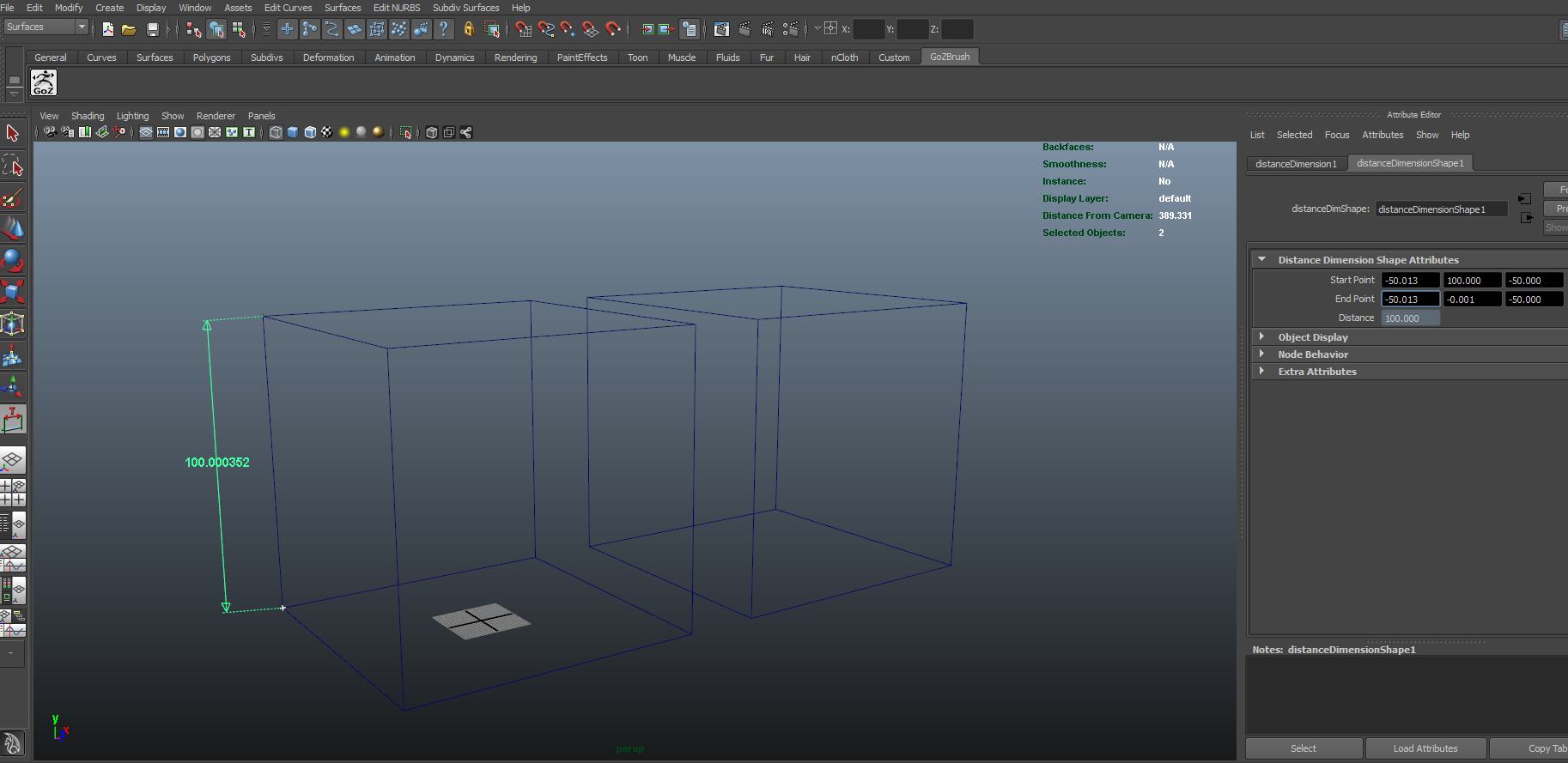

The second image shows both cubes imported into Maya. The one on the right is your FBX from Modo, and the one on the left is the same cube exported as FBX from ZBrush. As you’ll see, the cubes are the same size and measure 100 cm (cm is Maya’s default unit).
So this shows that if FBX files exported from ZBrush are coming into Modo at the wrong size then there must be a setting you are missing. I don’t have Modo, so I can’t test but in Maya, for example, you need to check that the units are the same or the appropriate scaling is applied.
