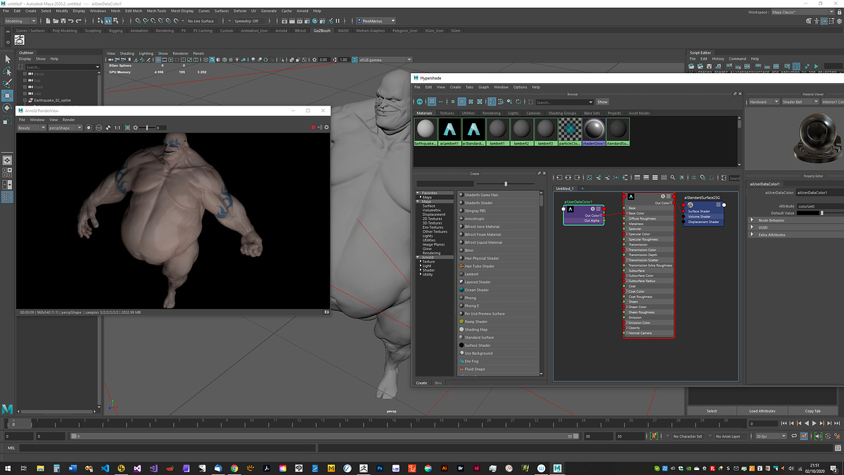

Polypaint is working fine for me in Maya, following the video you link to.
You can also quickly turn on the vertex color in Maya like this, after importing the FBX file:
  1. Make sure Smooth Shade All is on, then right+click on the mesh and choose “Assign new material”
  2. Assign something like Maya Surface>Lambert material.
  3. Select Mesh Display > Toggle Display Colors Attribute.
There’s more detail about this here: https://knowledge.autodesk.com/support/maya/learn-explore/caas/CloudHelp/cloudhelp/2020/ENU/Maya-Modeling/files/GUID-789B35EA-BDBE-4B82-81E3-75FB611FC96C-htm.html
