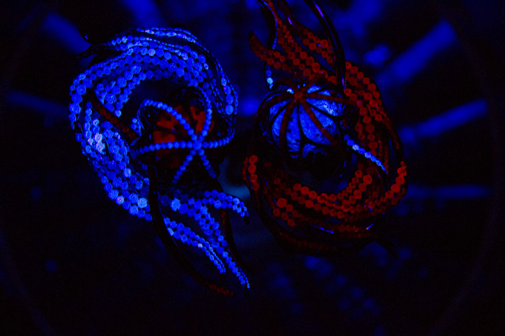

Another pic for you guys.
The Jellyfish rings have a party trick. Real Jellyfish are sometimes bioluminescent, so for the jellyfish rings I used fluorescent rubies and diamonds so that under UV light they glow!
