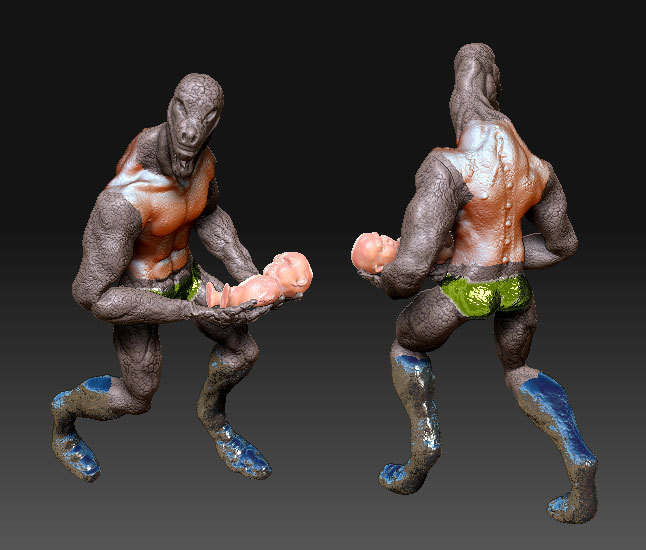

Here’s a test. Base materials using Ralf’s grey and sculpy mats. (The two models are one, after inserting smaller subtool geometry.)
Where the test shows here are the other painted over materials: new skin mat for torso, gel type for pelvis, default chrome for feet and legs.
[attach=63600]mcgee_zmattest.jpg[/attach]
Now if only we cold make smooth transitions between materials.
