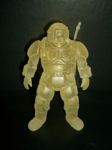

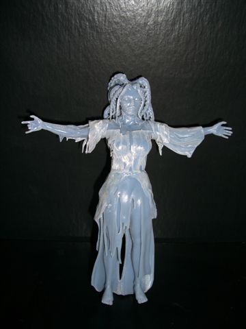

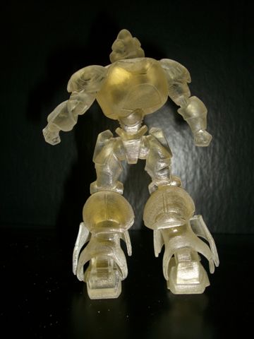

I’ve been following this thread for a while now and decided to chime in now that another company has been mentioned. I don’t want to take from Josh’s thunder. Josh, you have provided a lot of great information that has helped inform a lot of the individuals on this forum as to the possibilities of Additive Technologies and I would love to speak with you about some of your work with your polyjet.
GROWit is a rapid prototyping, now better known as Additive Technologies Company in Southern California. We have been working on new ways of creating less expensive, more accurate, custom avatars and models for people all over the world and have come up with some great solutions. We primarily use Polyjet and Z-corp for avatars for many of the same reasons that have been mentioned, but we also offer SLS, FDM, SLA, and a new great metals process called Direct Metal Laser Sintering (DMLS).

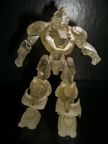

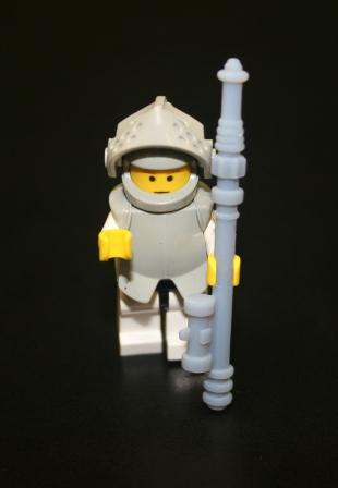

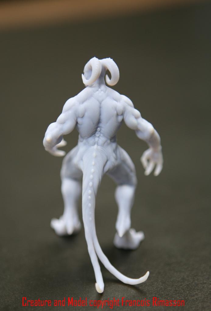

Here is a bit of the work that we have done.
Attached is the document “The Basics of Growing 3D Models”. We have been continuously modifying it to help with preparing files for additive technologies.
Because of the high resolution files that are produced from z-brush, we have created an ftp link to load files that are larger than 20 MB.
http://www.growit3d.com/upload/
We typically run files that are larger than 80MB to capture all the detail that is in the model. But we don’t recommend going much higher than 100MB.
We have received a lot of questions lately about the last portion of “The Basics of Growing 3D Models” about models containing only one solid object. Technically the model doesn’t have to be sent as one solid objet, but if our software cannot re-mesh the multiple solids / shells into one single solid, with just the press of a button, then the file will be returned with a few helpful hints to fix.
Please let us know if there are any questions about this technology that have not yet been answered. We would like to provide the opportunity for everyone to get a chance at producing their own model! Send us your model and we’ll let you know how much it will be based on the technology and size.
Keep up the great work of keeping this forum GOING!!
The Basics of Growing 3D Models low res.pdf (274 KB)

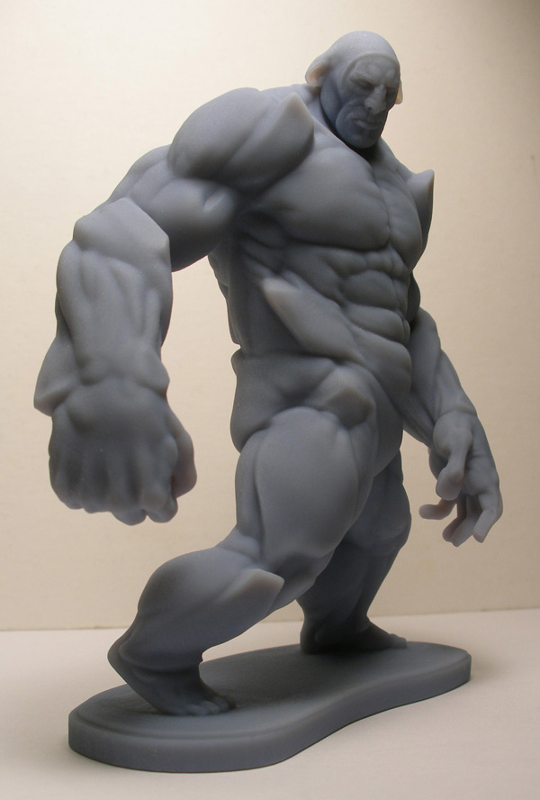

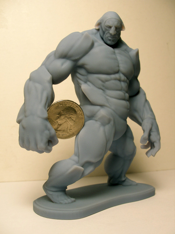

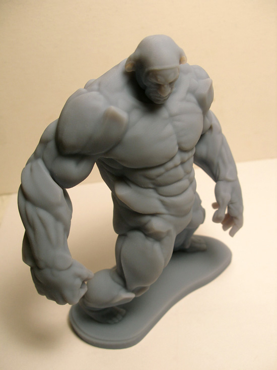

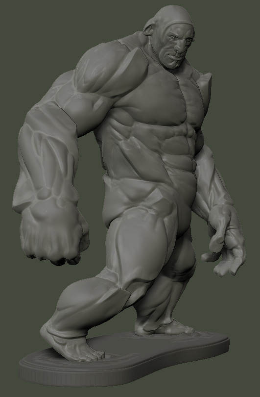

I had my zbrush model sent out to be made into a physical piece.
The images here are of a 5 inch tall prototype. This print was made by the guys at Growit3D.
Contact: David Gurrola
Let me know what you think. I am more than satisfied with this piece!
-Jeff
The Print:

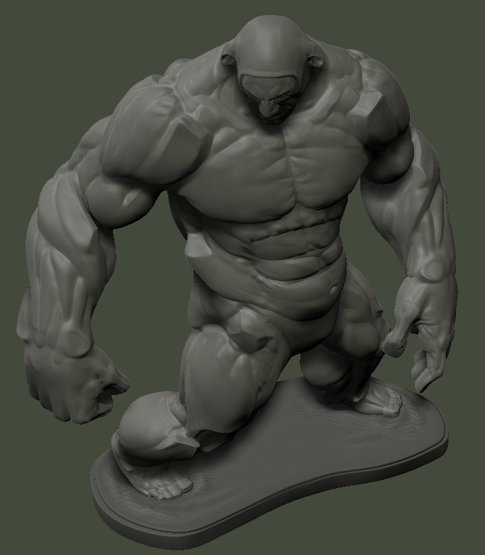

This is the link to my sketchbook thread with all associated pics.
http://www.zbrushcentral.com/zbc/showthread.php?p=466039#post466039
I hope you like the work. Growit3D did a great job. I had the print in my hands in one week after I sent out the approved obj file. Super clean print!
