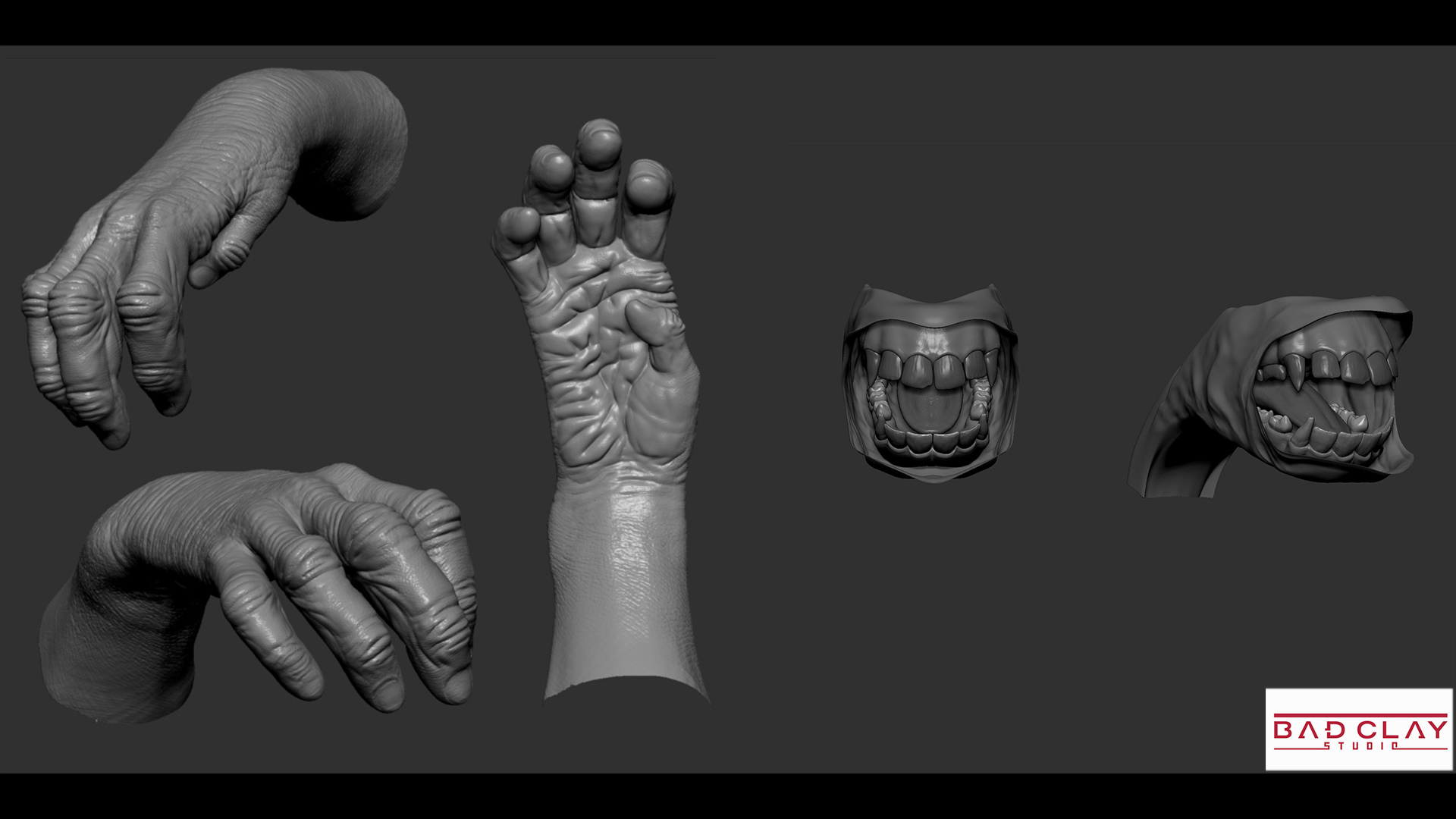

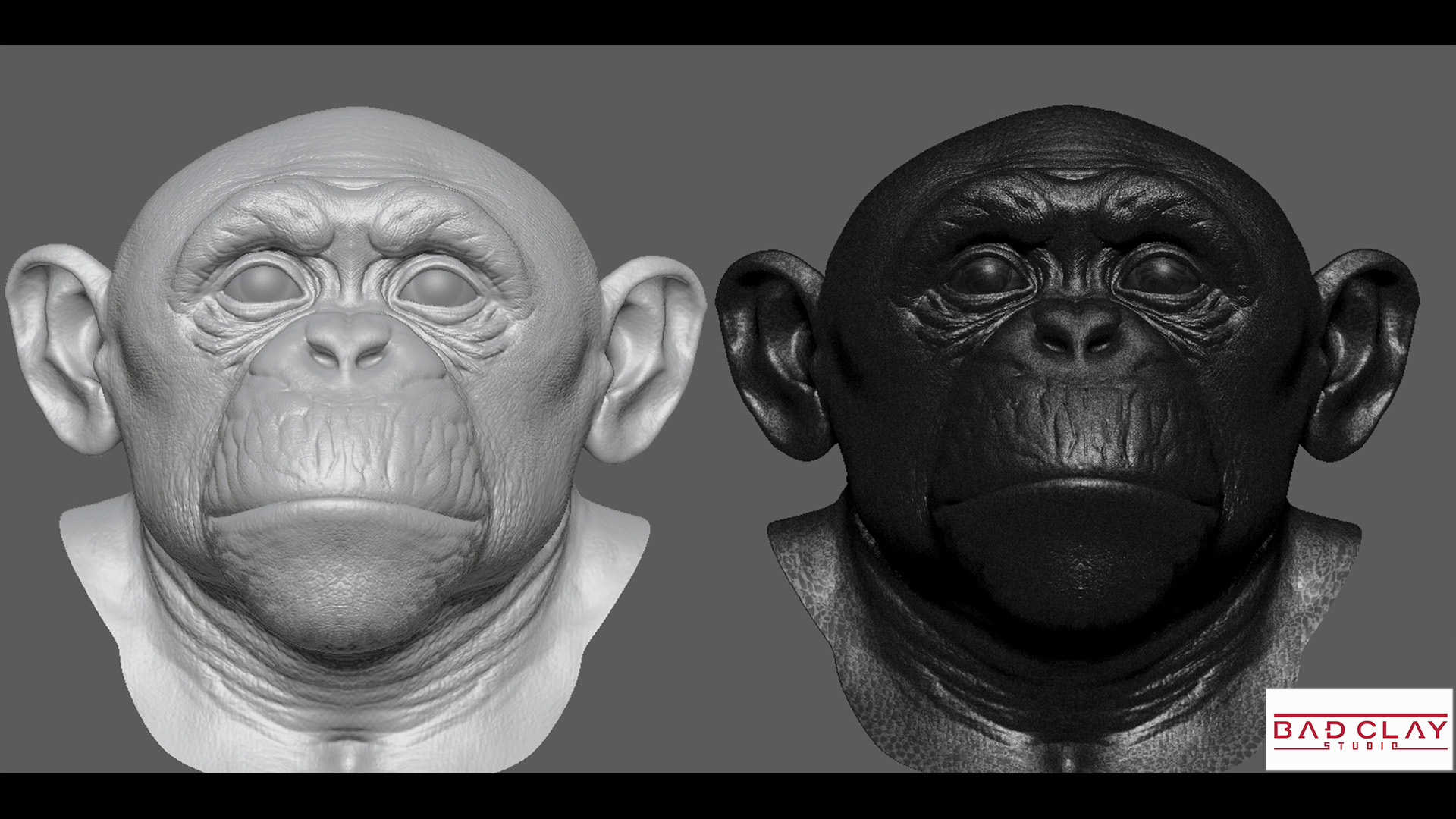

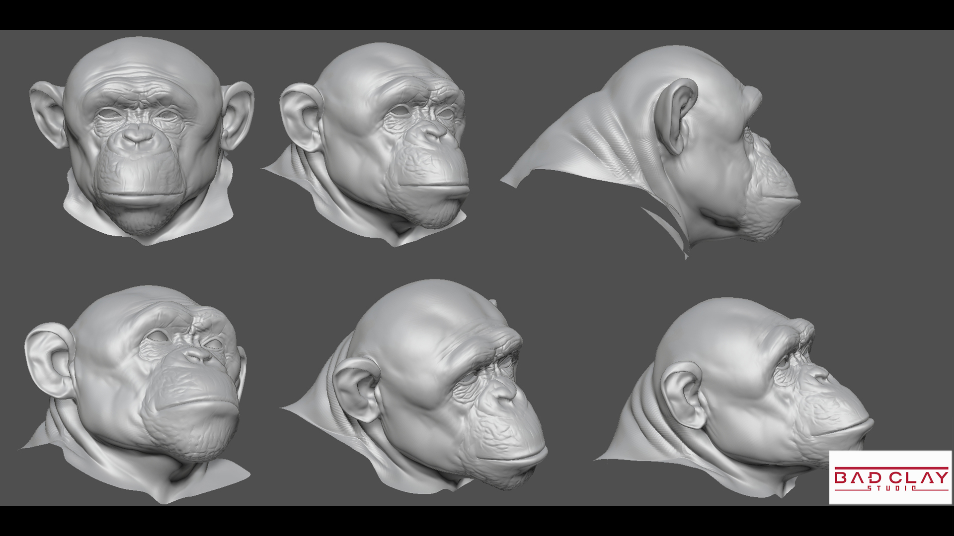

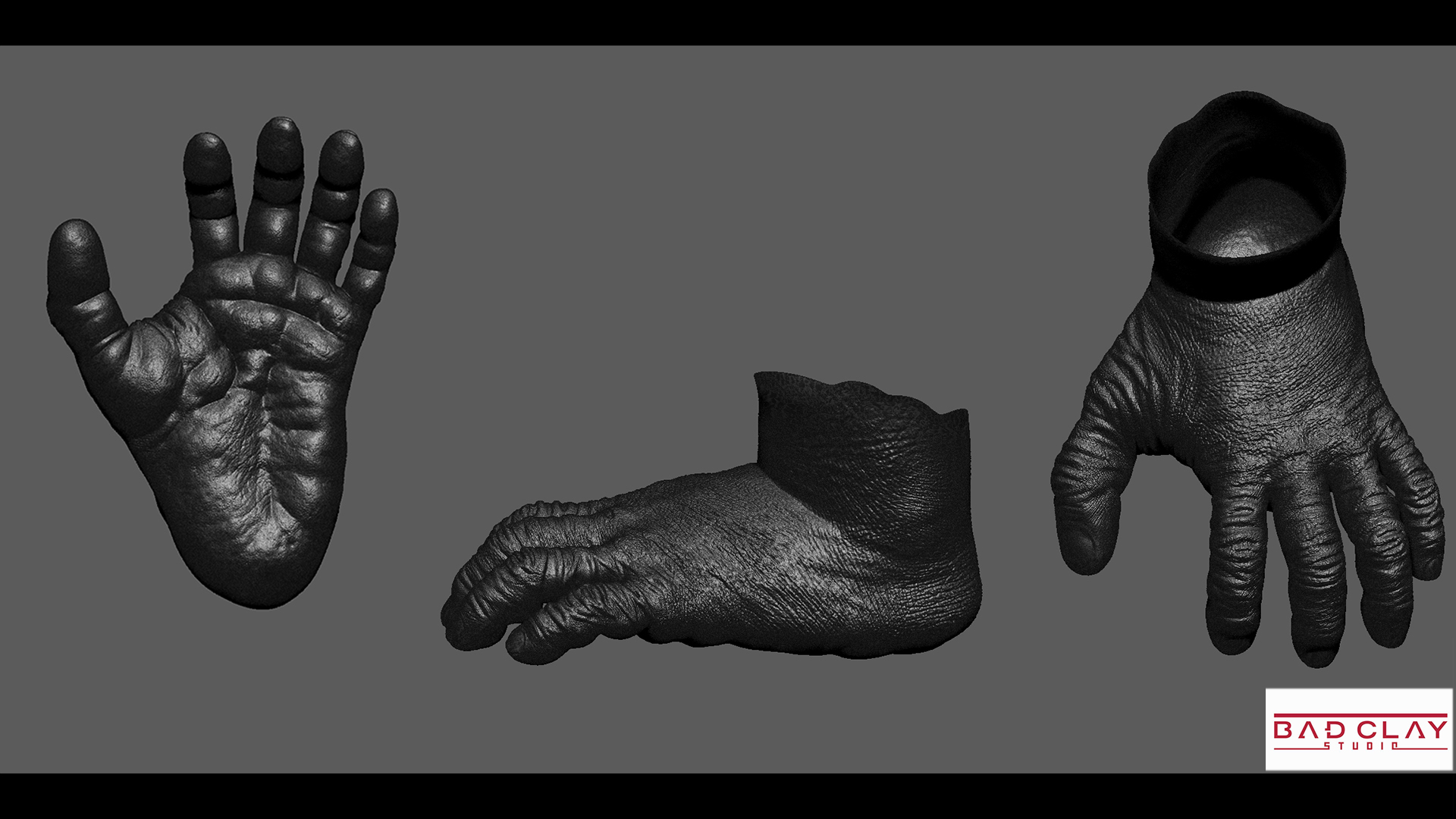

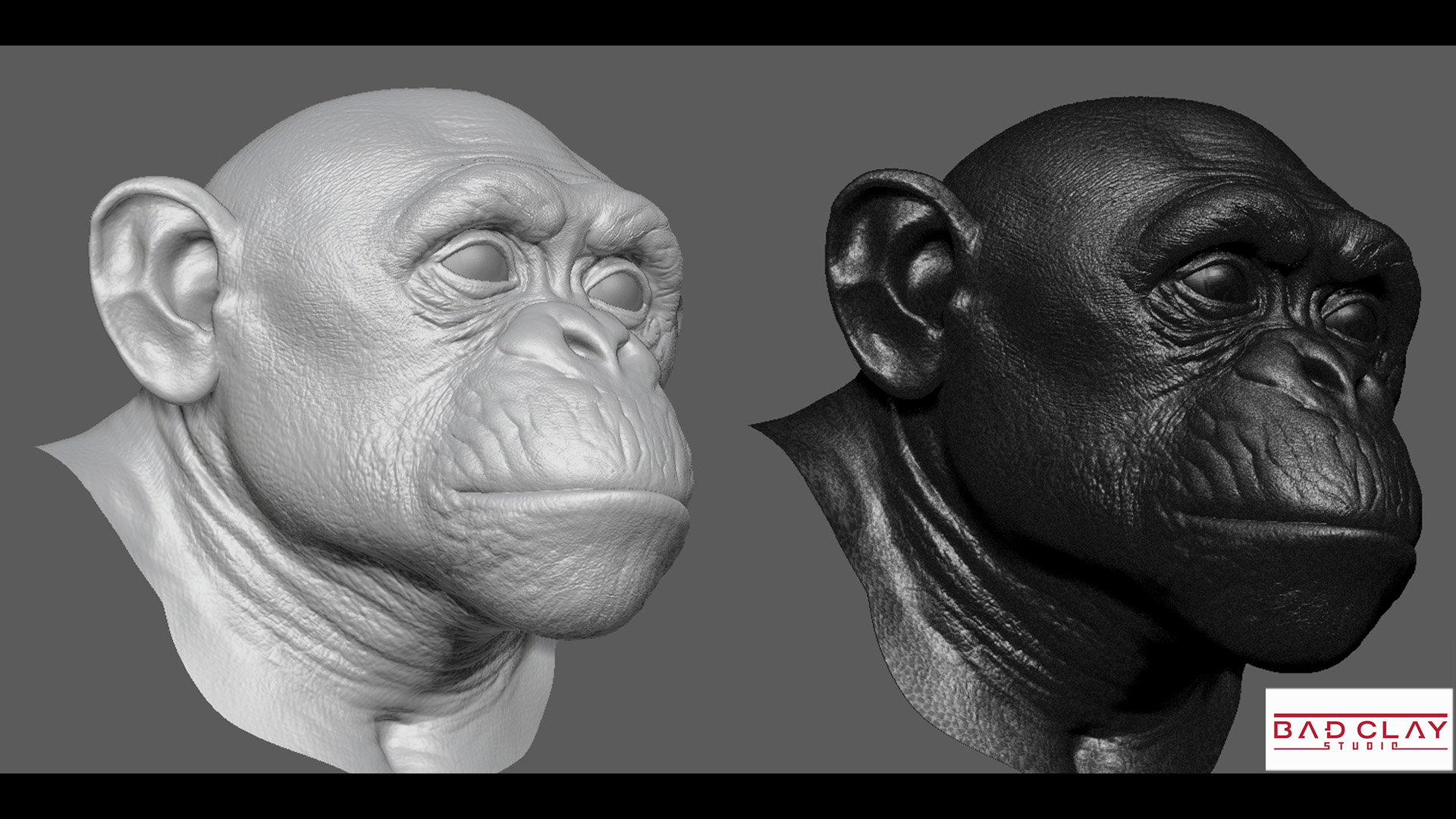

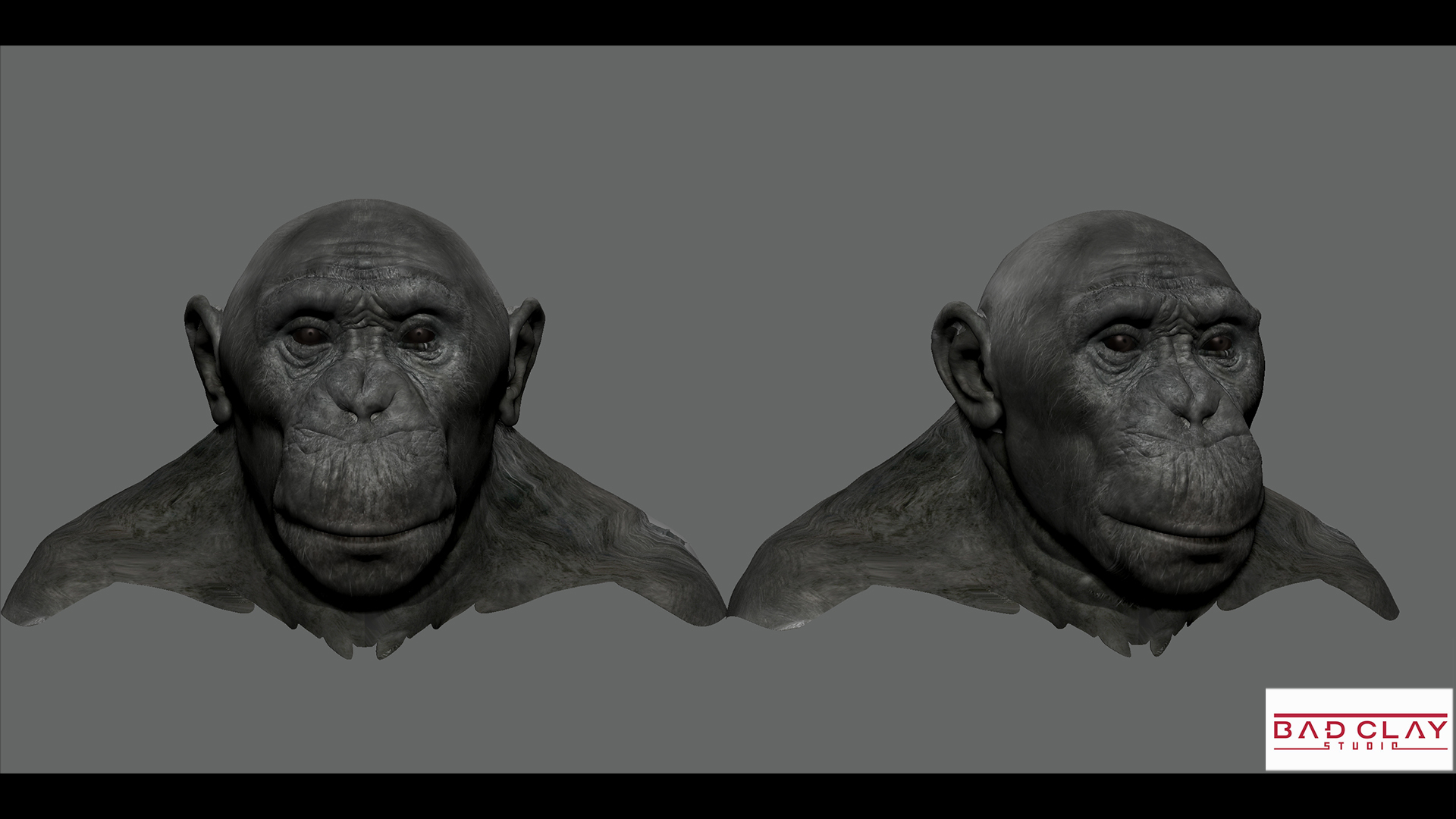

After checking all our proportions , it was safe for us to start going more into the details , we put much of our work on the feet , the face and the hands as those part will not be covered by fur , and will also because each different wrinkles will give a different identity and personality for each monkey .
We use Zbrush alphas and sharp brushes to almost exagerated the wrinkles , as we know by experience that the SSS will smooth everything naturally and it will let the option to NKI to reduce the strengh according to the distance they would be seen.

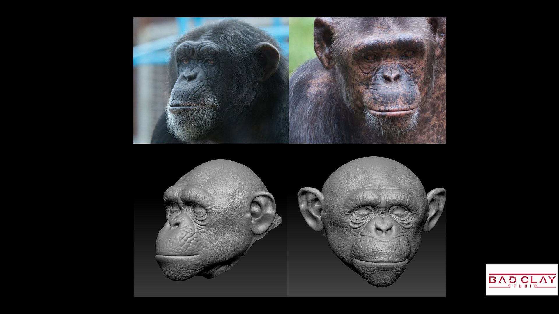

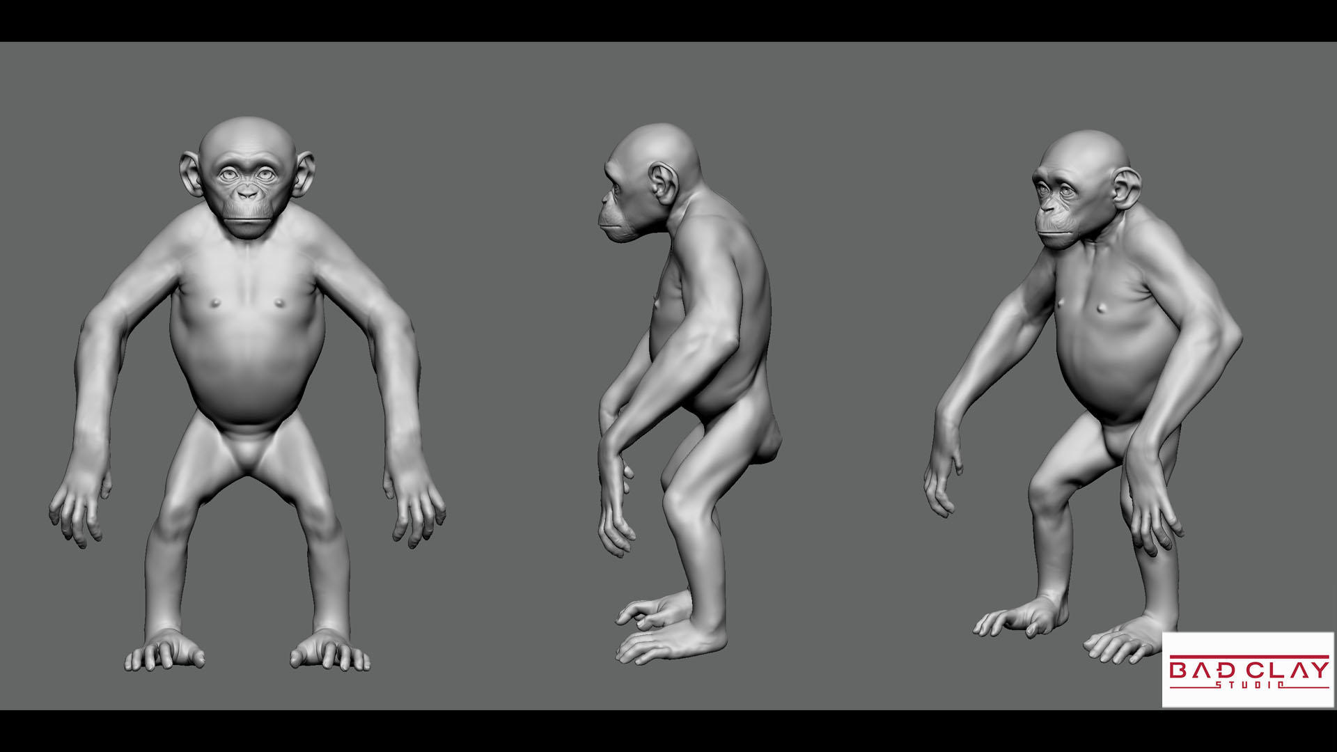

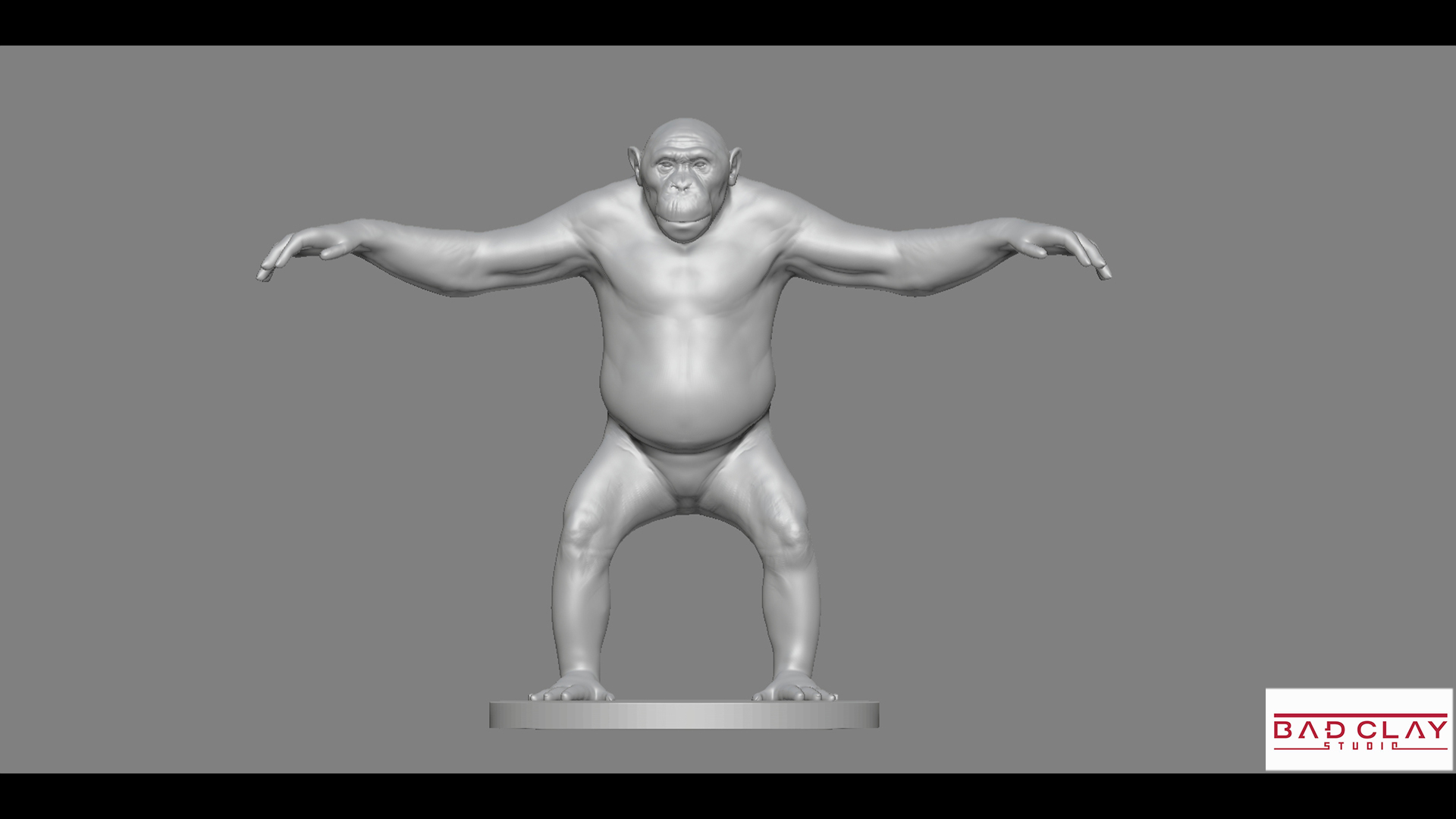

We used all our references to make some quick sculpt that would help us to make more variations and start to test some posing.
Dynamesh was used to start the sculpt we quickly turn the dynamesh to a lighter version with Z-remesher that allows us to make some transpose and manipulate lower resolution geometry to make a first presentation of the monkeys.
It was important for us to know that it would work on posing as it will define the final look of the chimpanzee , according to their proportions and gesture.
So we didnt want to go any further before knowing that it would look right for situation the monkeys would be put on.
We use Zbrush alphas and sharp brushes to almost exagerated the wrinkles , as we know by experience that the SSS will smooth everything naturally and it will let the option to NKI to reduce the strengh according to the distance they would be seen.D5.jpgD4.jpgBody.jpgD6.jpgD3.jpgD1.jpg

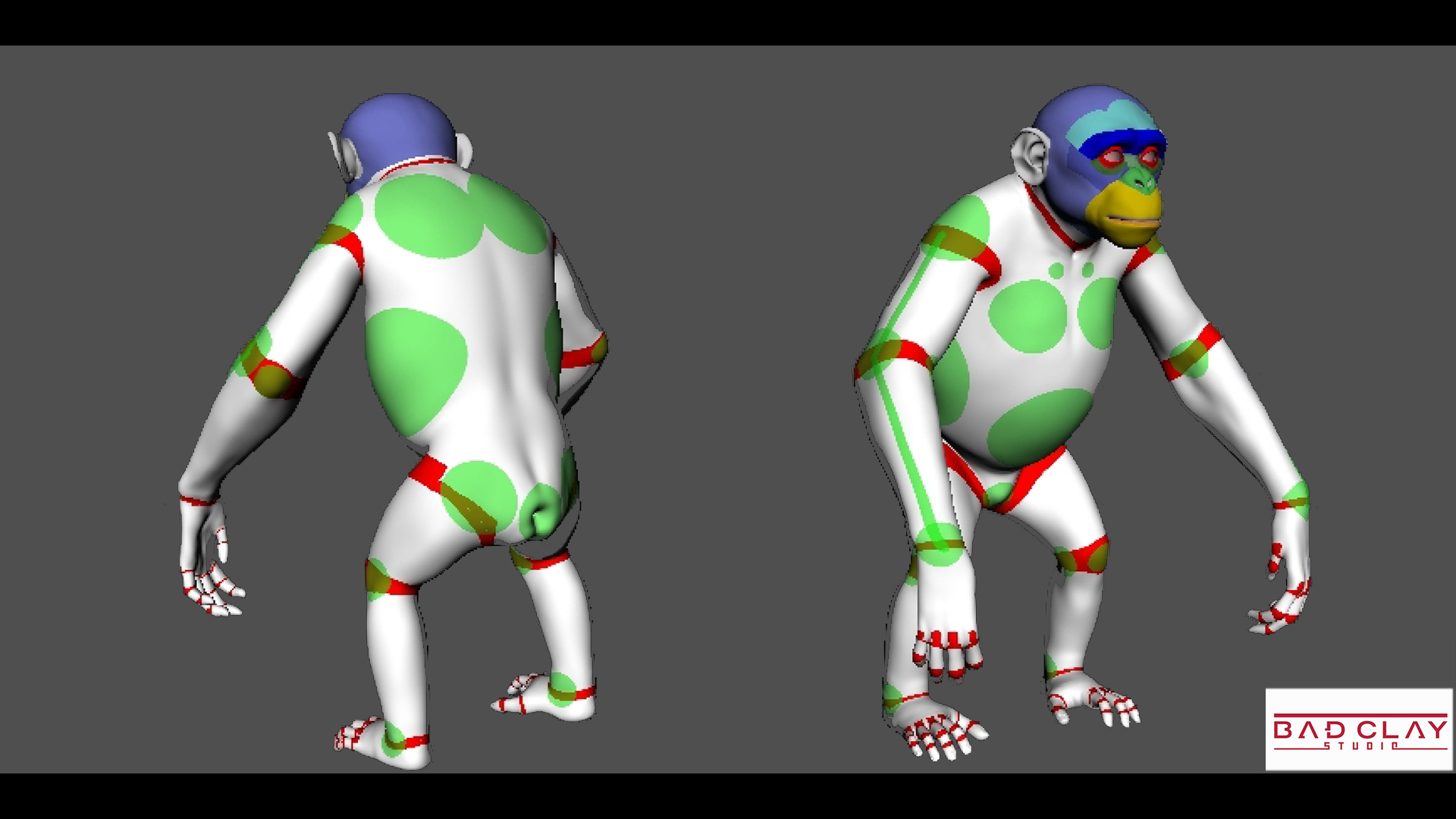

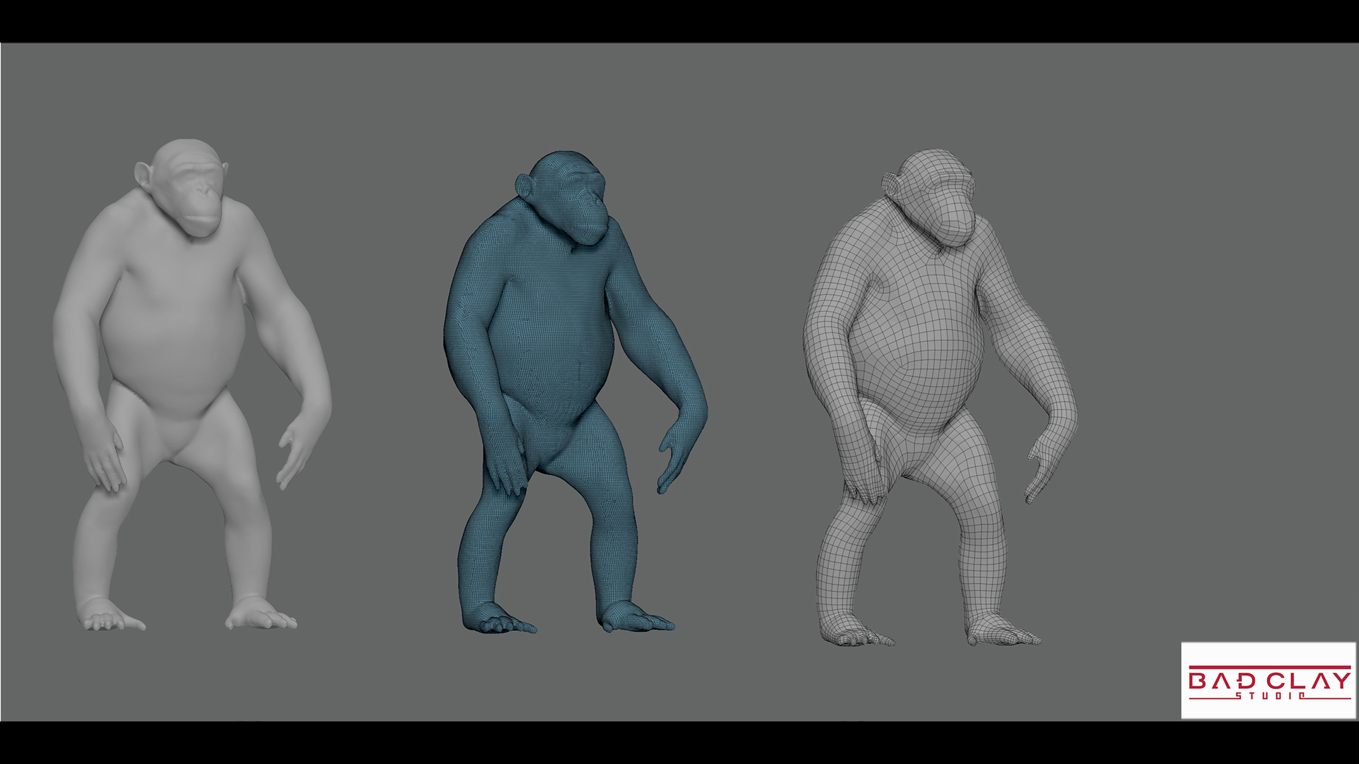

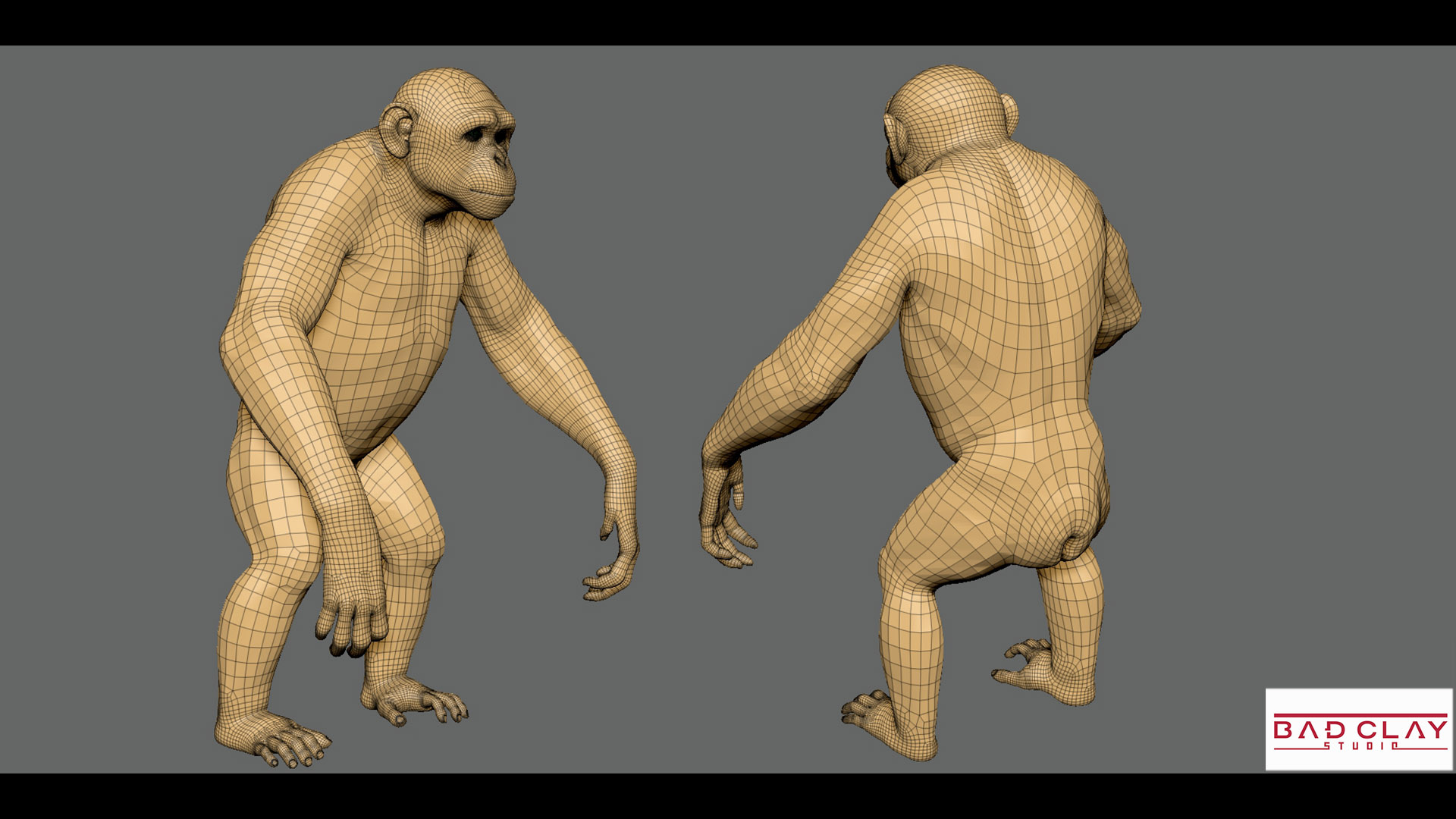

When we started the project , NKI asked us to make only one unique model for all of them to give optimise reduce the time spent on rigging.
It sounds scary at the beginning but “project all” function made everything goes smoothly for that part , we just rescaled all the monkeys match the scale of the most important one ( oscar) , and then use a layer that would compensate the different volume that would be extract as a blendshape later on to be on top of the skin deformer.

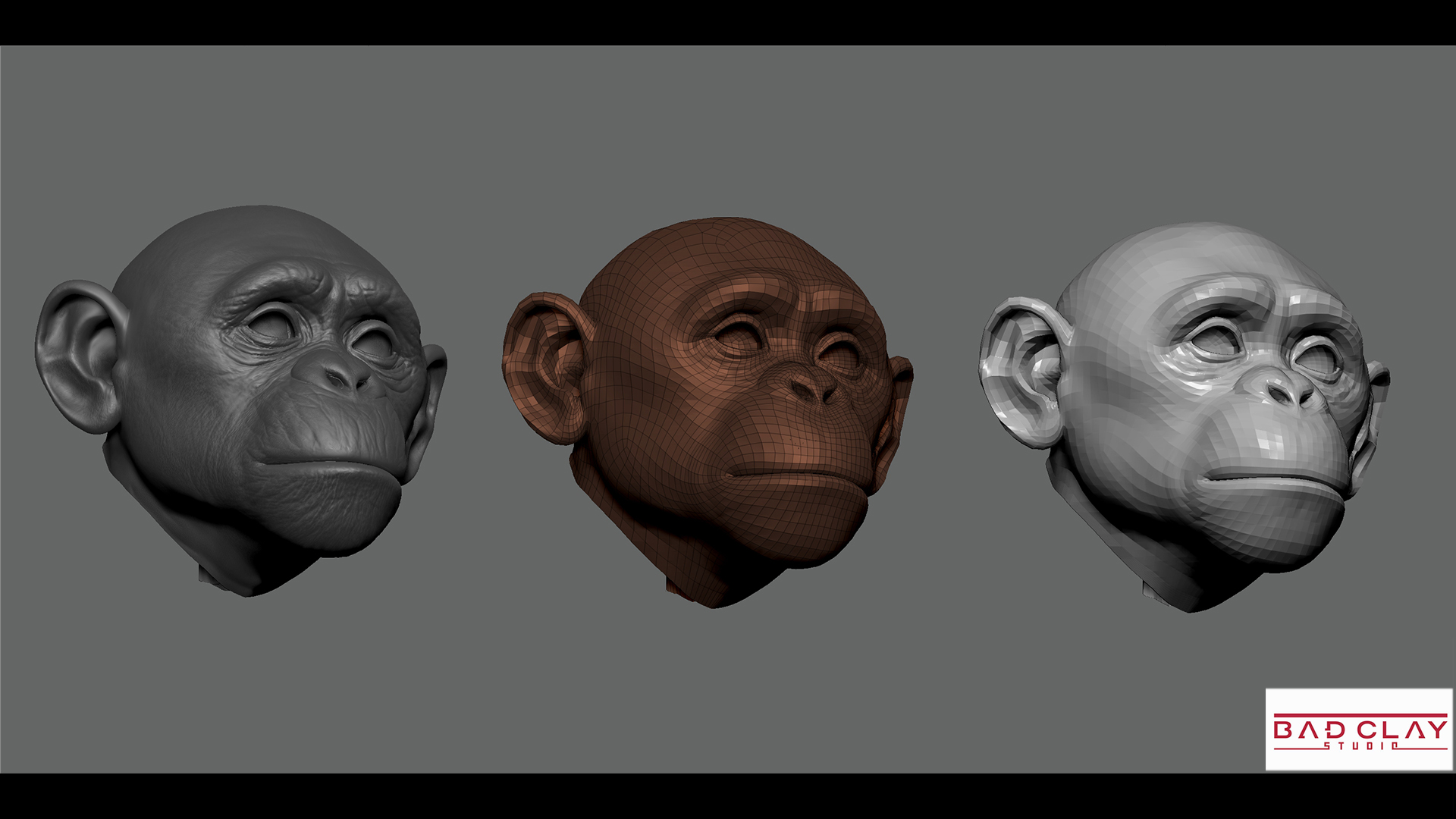

We kept all the high frequency separately , as they could be extracted on their respective Ztools without affecting the final result.

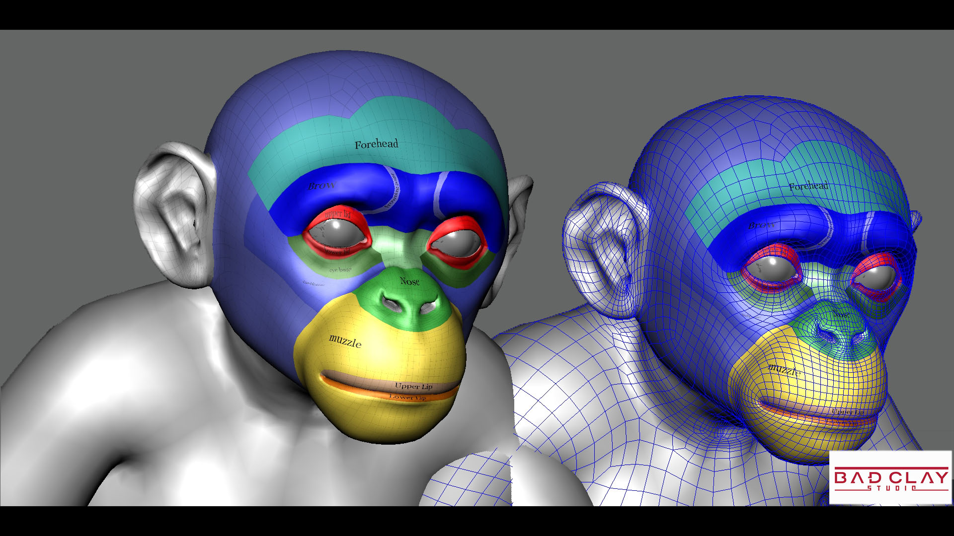

Aera map help us to keep the integrity of the topology around articulation aera for all variations.
Polygons are grouped to keep the integrity of al delicate aera ( eyelids, lips border , muzzle ect)

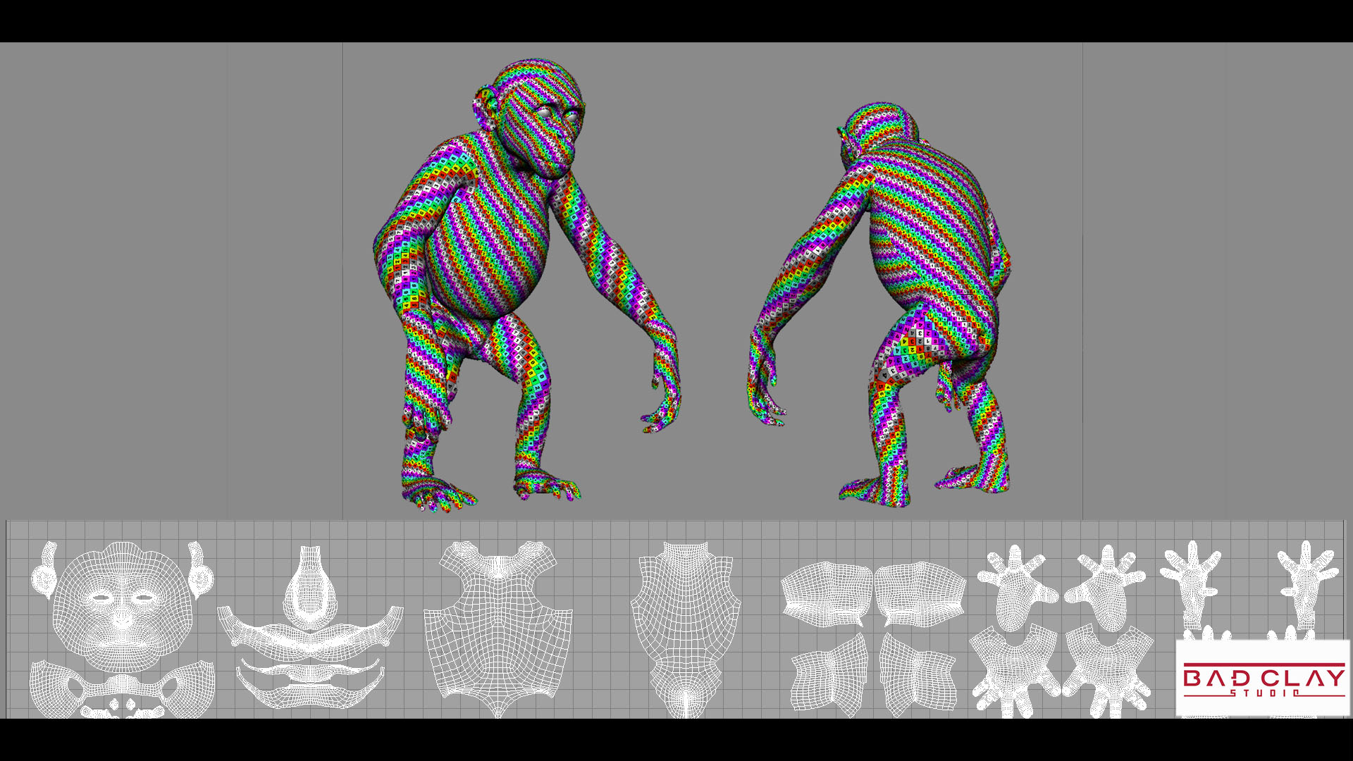

High resolution topoly made on top of the final sculpt , all monkeys will share the same topology.
We also kept the same UVs for all the monkeys to make sure that any texture package could be easily switched to a monkey to another and give flexibility to the client.
Tey can decide wich texture or color tone they want to give to the monkey according to the shots…

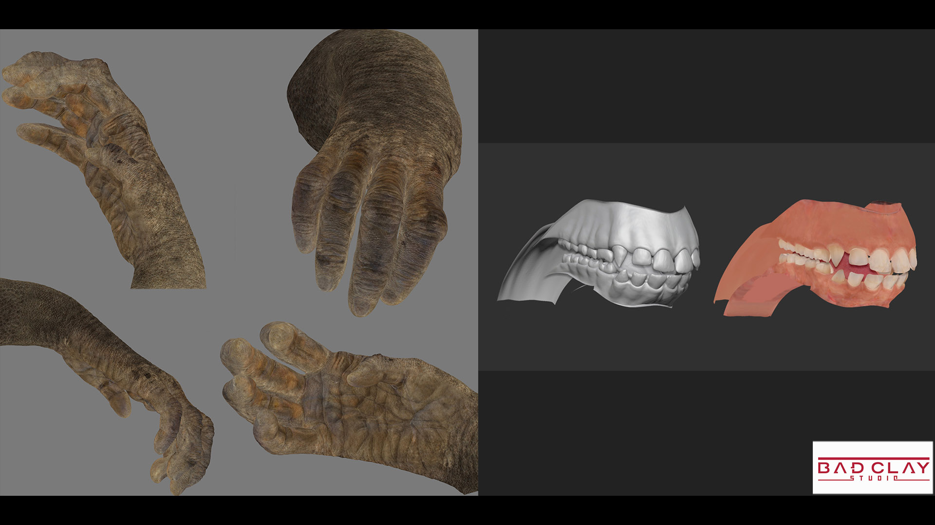

Each monkeys has 7 textures of 8 k per channel , we created color , specular , SSS and displacement map for every monkeys.
Texture work was a mix between photo projection and hand painted for the variations.
first test of texture projection made in Zbrush from “Zoo” ape.
We made some variations on the displacement maps as well according to client Casting and give each monkey a differerent identity.
Color Variations for the main Charaters.
We use Hi-resolution Photograh and hand painted to generate and project our textures.
Uv Check stage , of our seven 8k textures.

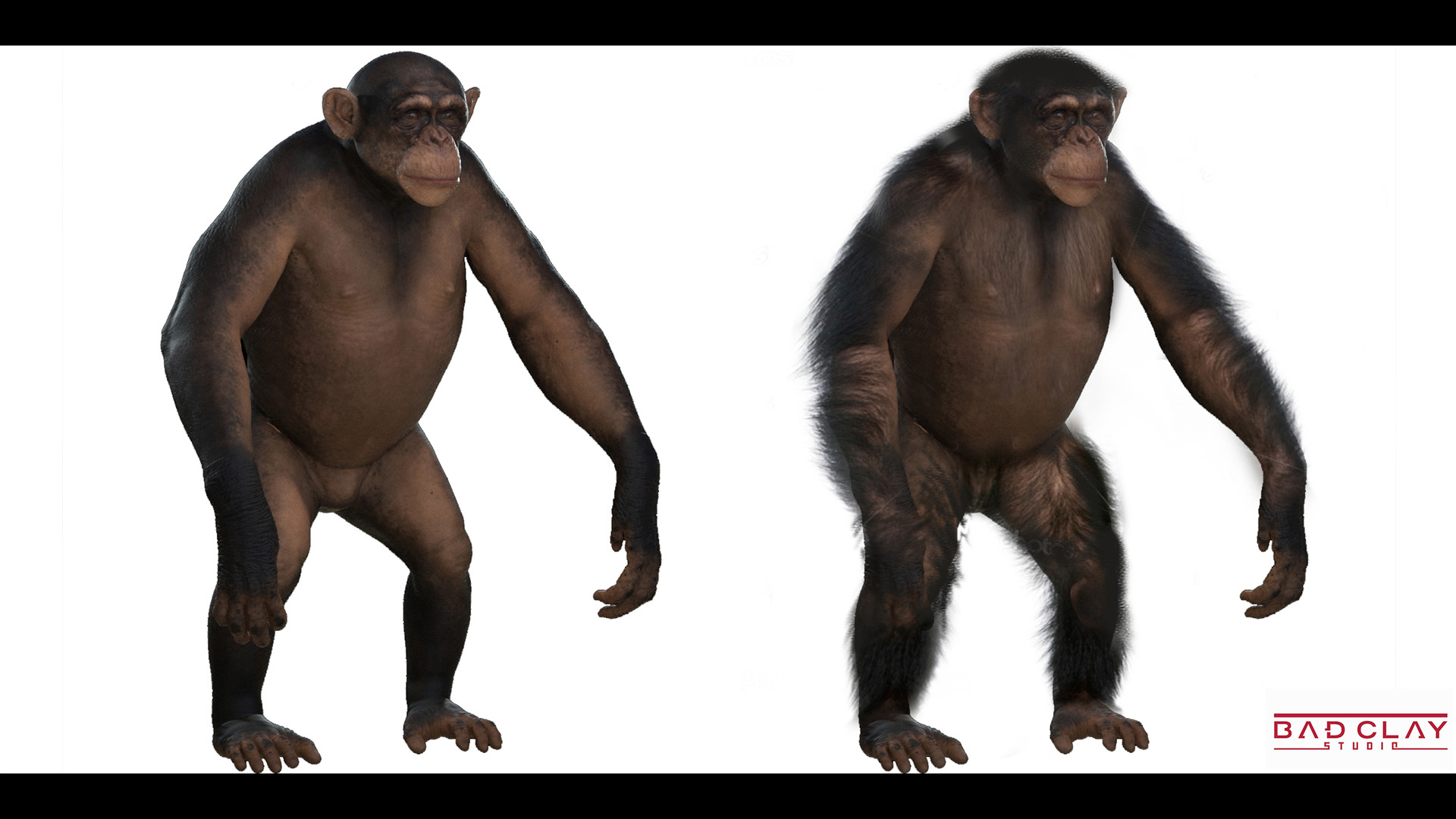

As Bad Clay Studio wasnt responsible for the fur system , we internally test all our textures and displacement by rendering them in a proper lighting and also make a mockup of the fur to have a idea of the final look .
Fur mockup :
We use Zbrush alphas and sharp brushes to almost exagerated the wrinkles , as we know by experience that the SSS will smooth everything naturally and it will let the option to NKI to reduce the strengh according to the distance they would be seen.D4.jpgD6.jpgD5.jpgD3.jpgBody.jpgoscar_sculpt01.jpg

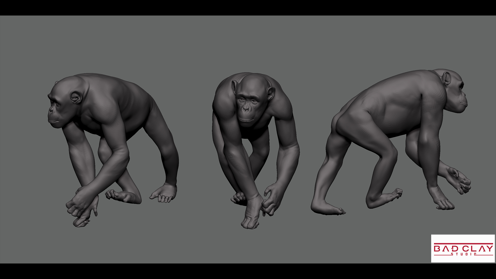

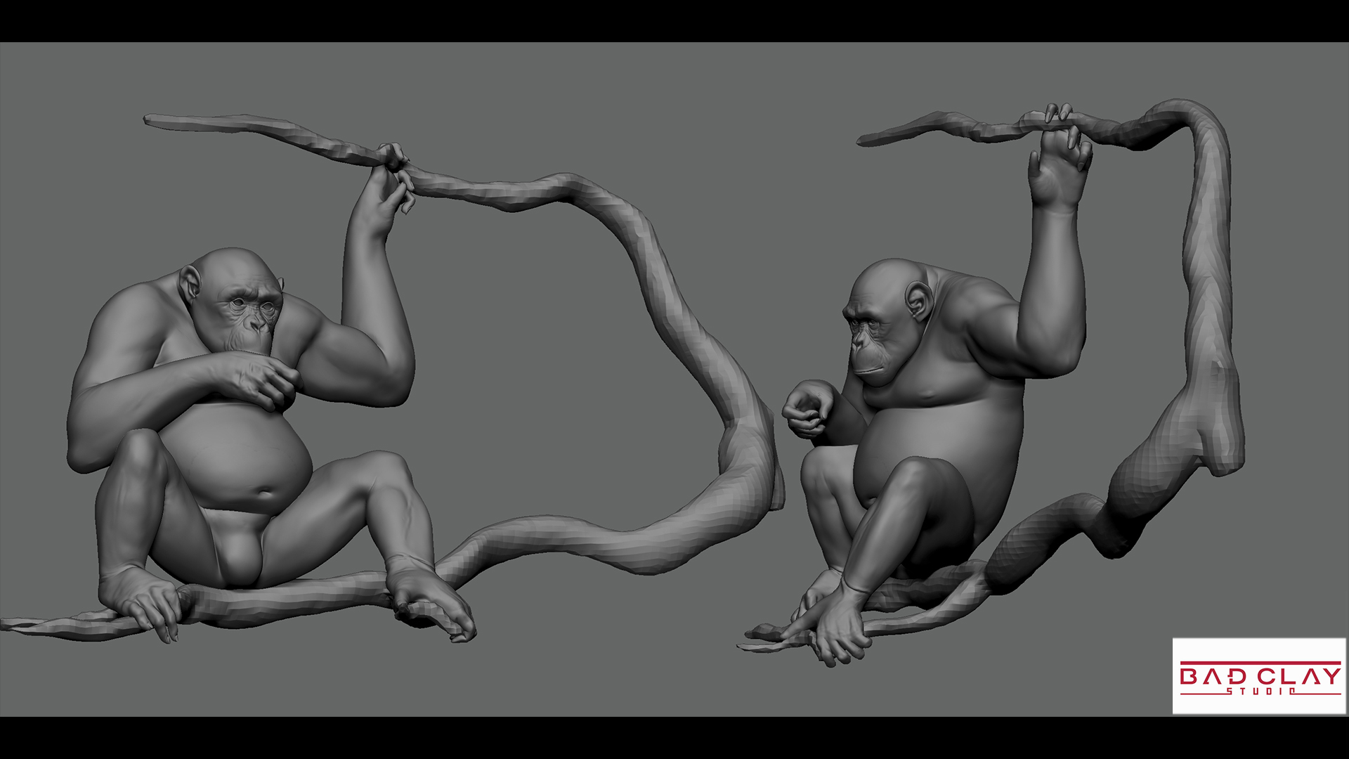

So we didnt want to go any further before knowing that it would look right for situation the monkeys would be put on.P1.jpgP2.jpgP3.jpgP4.jpgsculpt.jpg
