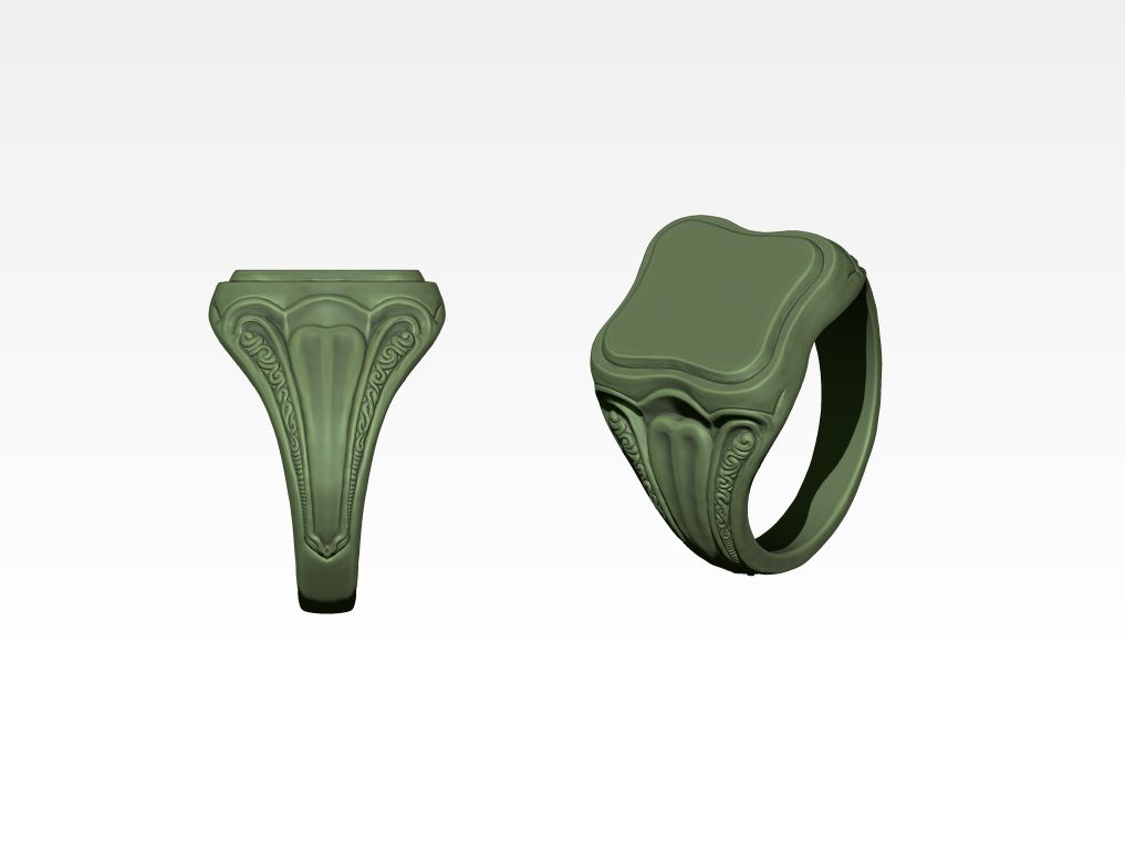

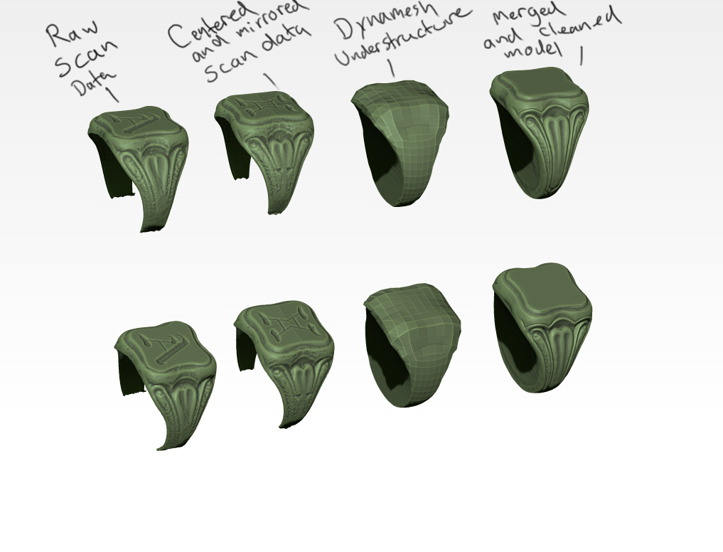

Got this job for a local jeweller. He had a really old ring he wanted me to scan and clean up so he can have multiple sizes for production. I thought i would post a bit about the joy of working with scan data. Finished piece in zbrush and a pic of the process.

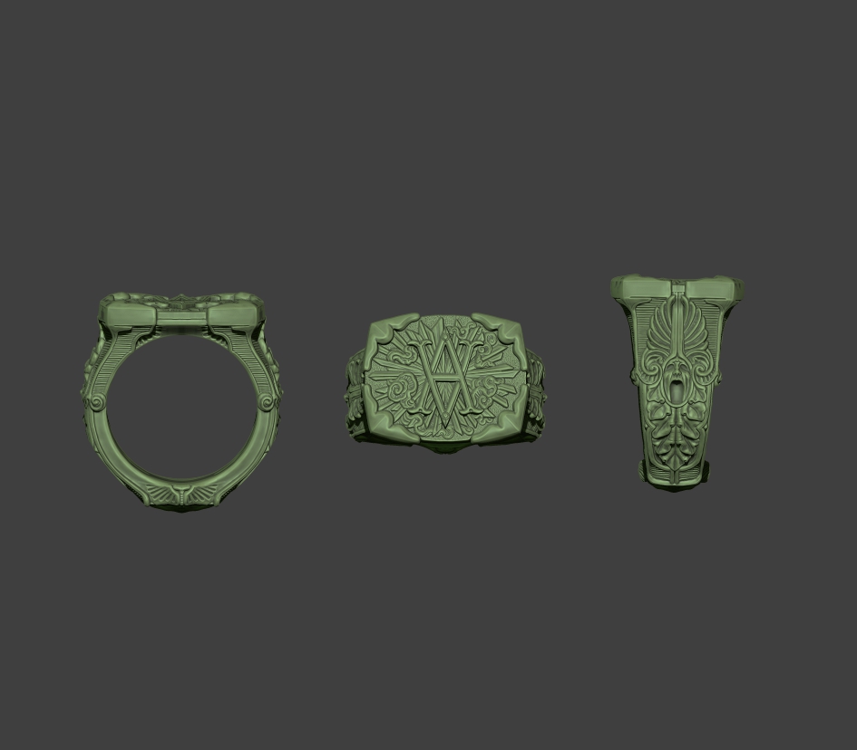

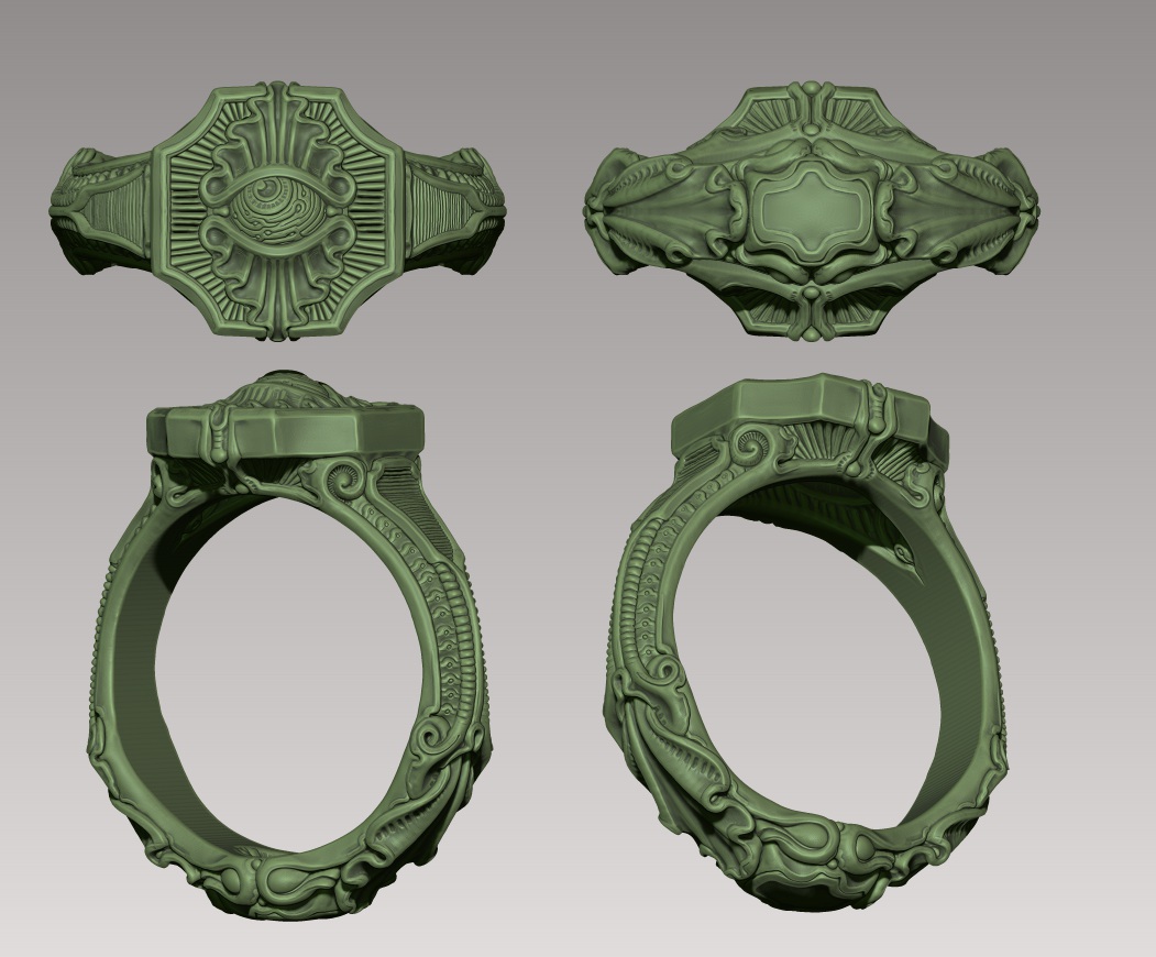

Hi All
Signet ring made for my brand. It’s gonna be a 2 metal piece, i’ll get some pics up after it’s cast.

Hi all
New ring. the final piece is going to be 2 different metals. looking forward to casting this one. Thanks for looking.

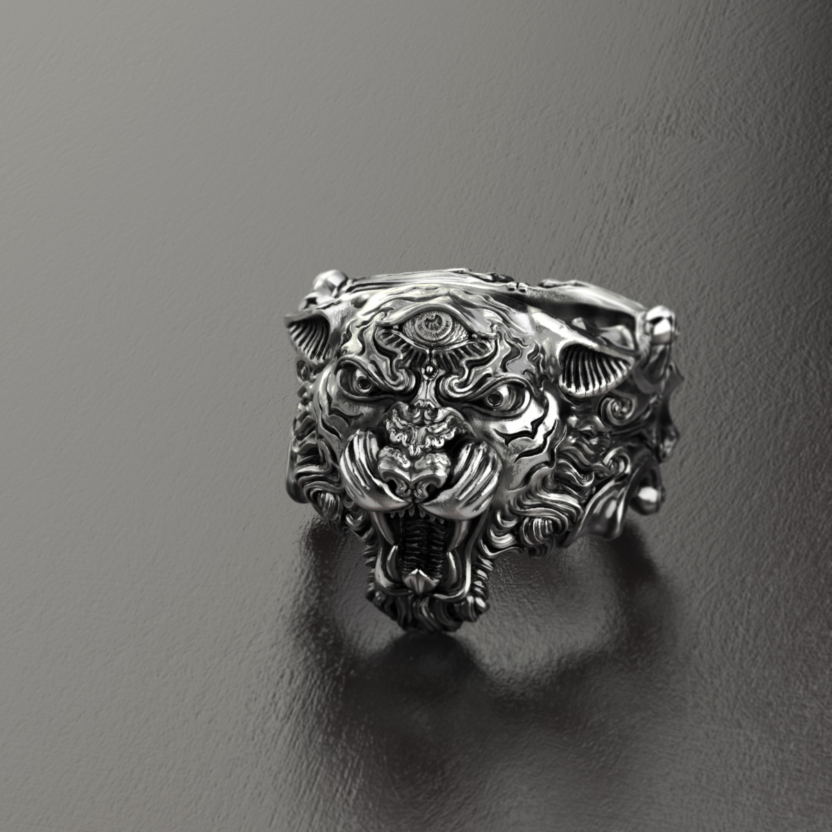

Below is a keyshot render of my Baroque tiger ring. When i get around to take some proper pictures i’ll post them aswell.
I’ve also included a bpr from zbrush. Thanks for looking

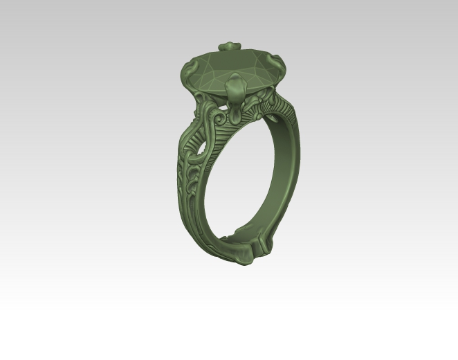

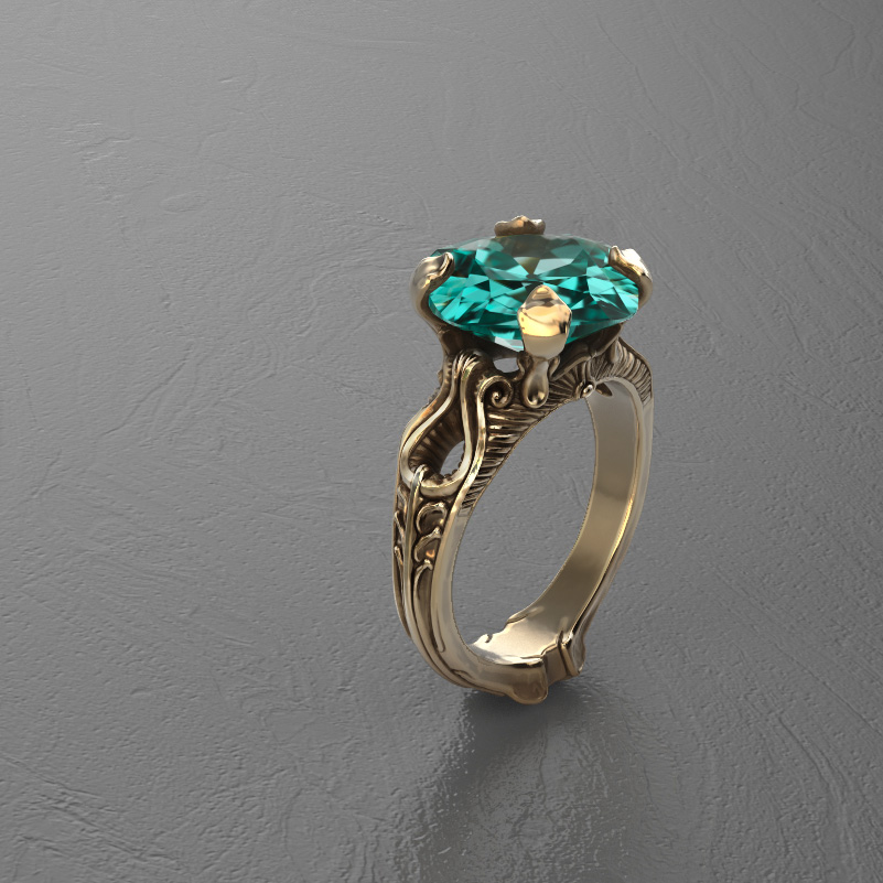

Hi everyone.
New Solitaire ring. Will cast in 18 K gold and set a cusion cut aquamarine. Zbrush screenshot and a keyshot render. Thanks for looking.
really cool work
ooo nice looking work. nice shoulder work. keep it up

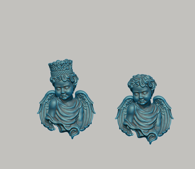

Hope you’ve all had a great start to 2017, haven’t posted in a while so here goes. First comission of 2017, cherub pendant.
Gonna be cast in 18k gold. 15mm tall. Thanks for looking.
