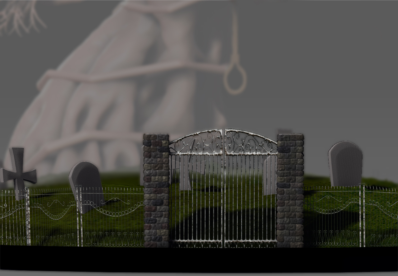

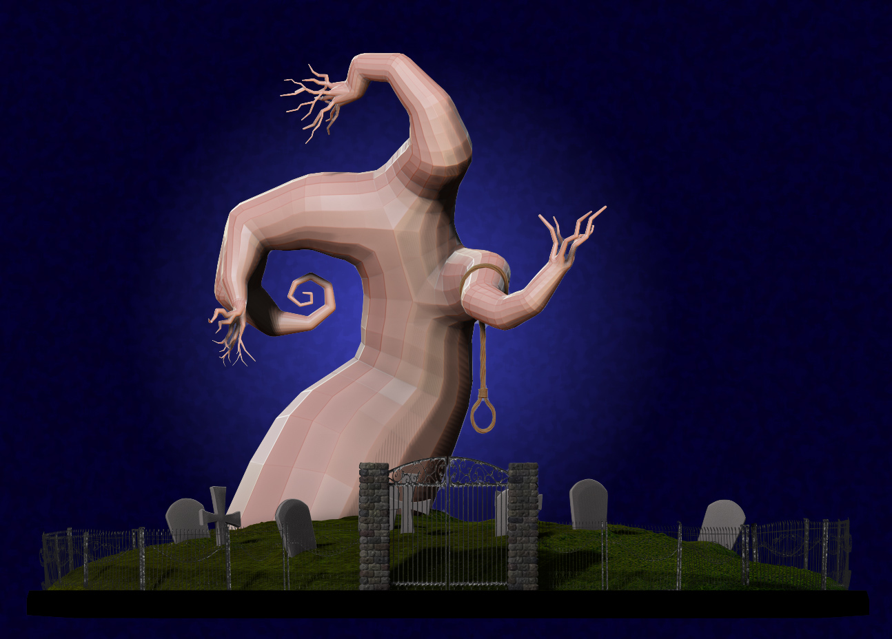

Hey guys, big-ish update from me here. I decided to take the scene in a little bit of a different direction. I agree that the tree was a little out of place with a more simple scene like that, so I decided to revamp it and start on a new less complex but just as spooky tree. I’d like to eventually print this scene and hand paint it once the tree is worked on and the rest is done. C&C would be much appreciated :slight_smile:

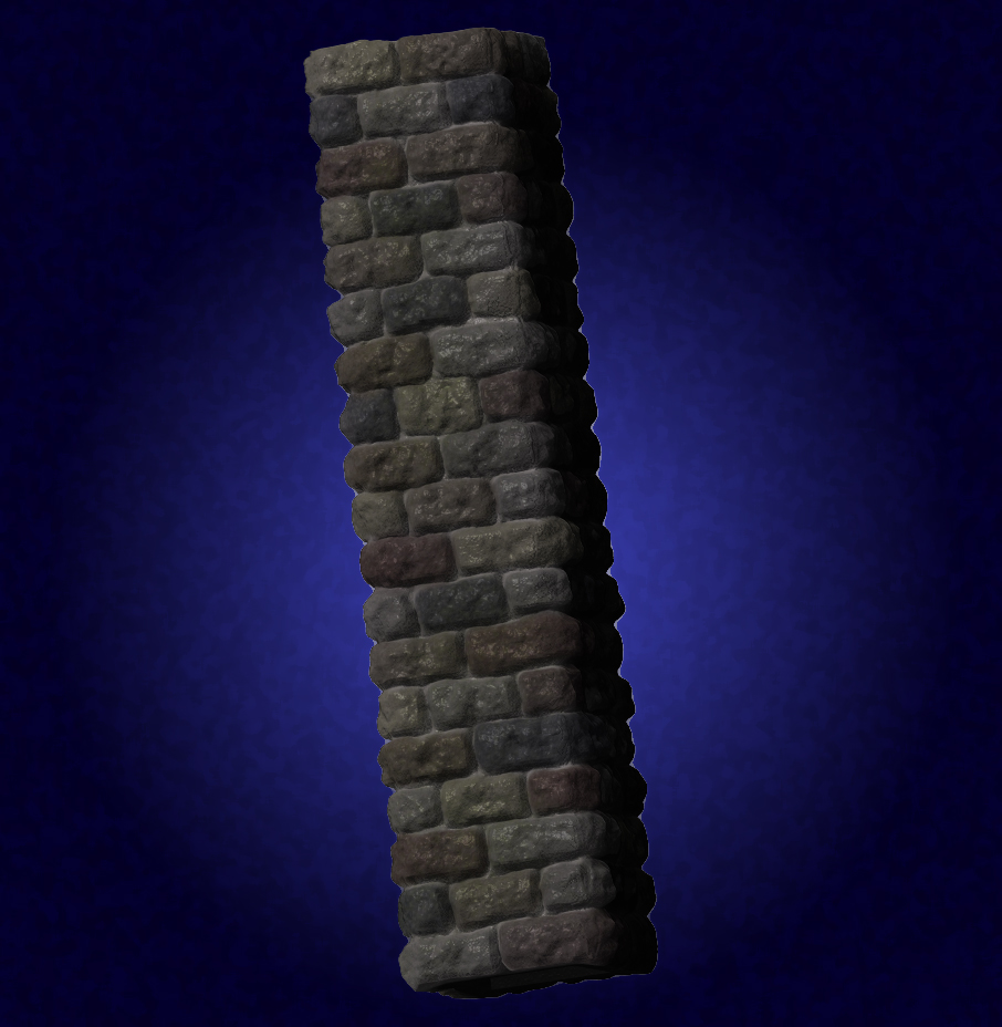

Closeup of the start of the fence statues. The bricks took awhile but were really fun to paint and sculpt!

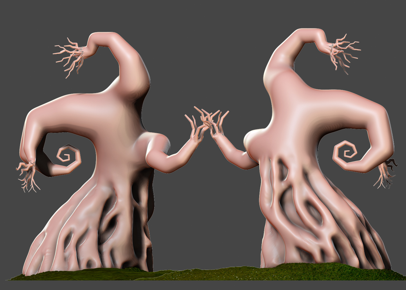

I think I’m finally making some progress :slight_smile: not sure where to go from here on the tree though as far as detailing the upper half. Hope you guys like it so far

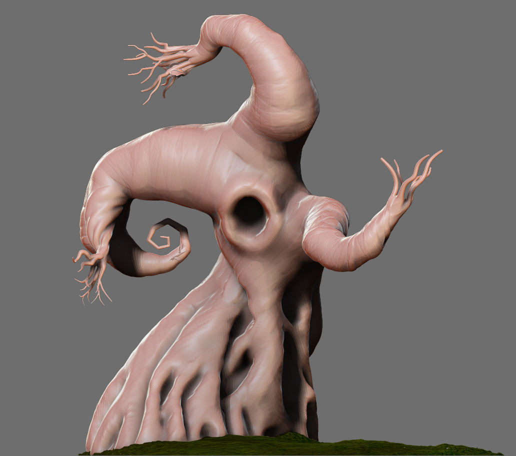

Update from me, not sure where to go with the upper half now:

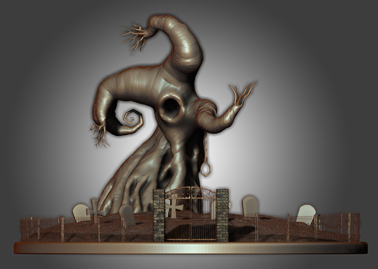

Finishing up some of the environmental stuff that’s going to be in the scene, and a small update of the tree also. Hopefully somebody can offer some comments or criticisms as I feel like I’m not really sure where to go next.
I would love to see a face on this tree, eyes,nose, mouth. I’m not sure what’s your plans tho.

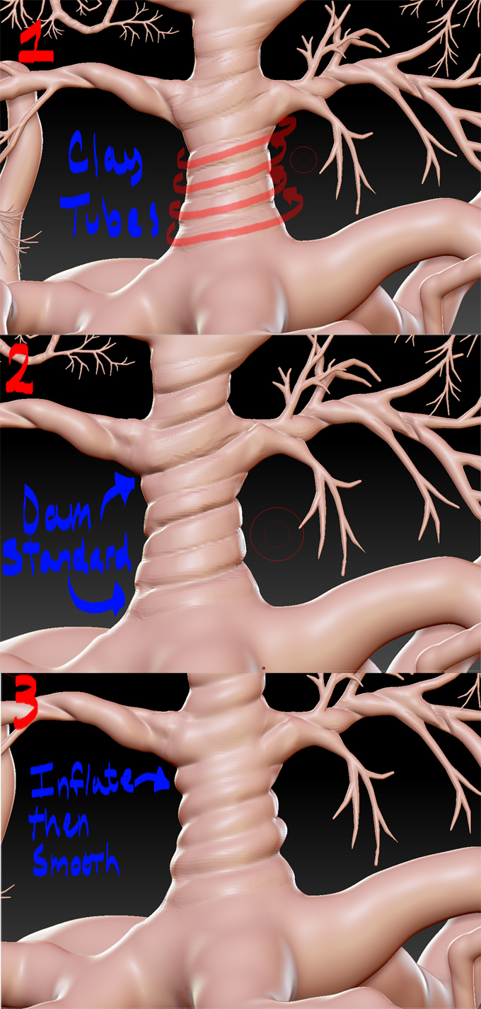

thats really cool bro! my question for you looking at your progress is I how did you give the whole tree that initial gentle twist in one of the first shots? :+1:
@idlemind thanks man! :slight_smile:
how I got the twisting was actually quite a long manual process, though I’m sure there are more simple ways in other packages. What I did was take the Clay Tubes brush to create a rough pathway for all of the twisting, then I took the Dam Standard brush with a slightly lowered intensity and traced the outsides of that pathway to create grooves. After that I smoothed inbetween the Dam Standard strokes to make it much cleaner and more subtle, and then used the Inflate brush with a very low intensity, around maybe 6 or so to puff up between the grooves. Hope that was clear enough, I’ll add some pictures a little later explaining the process better if necessary :+1:
Sorry it’s so quick and dirty, I only have an old file of this version of the tree so the topology is terrible :o
Hope it helps!
Alright, I see thanks alot. I was just thinking if there was a way to do that with sliders and buttons I needed to know that! Your short tutorial there still taught me something. that was much appreciated. adding that little twist to the mesh at exactly that point in your process was a very cool move.

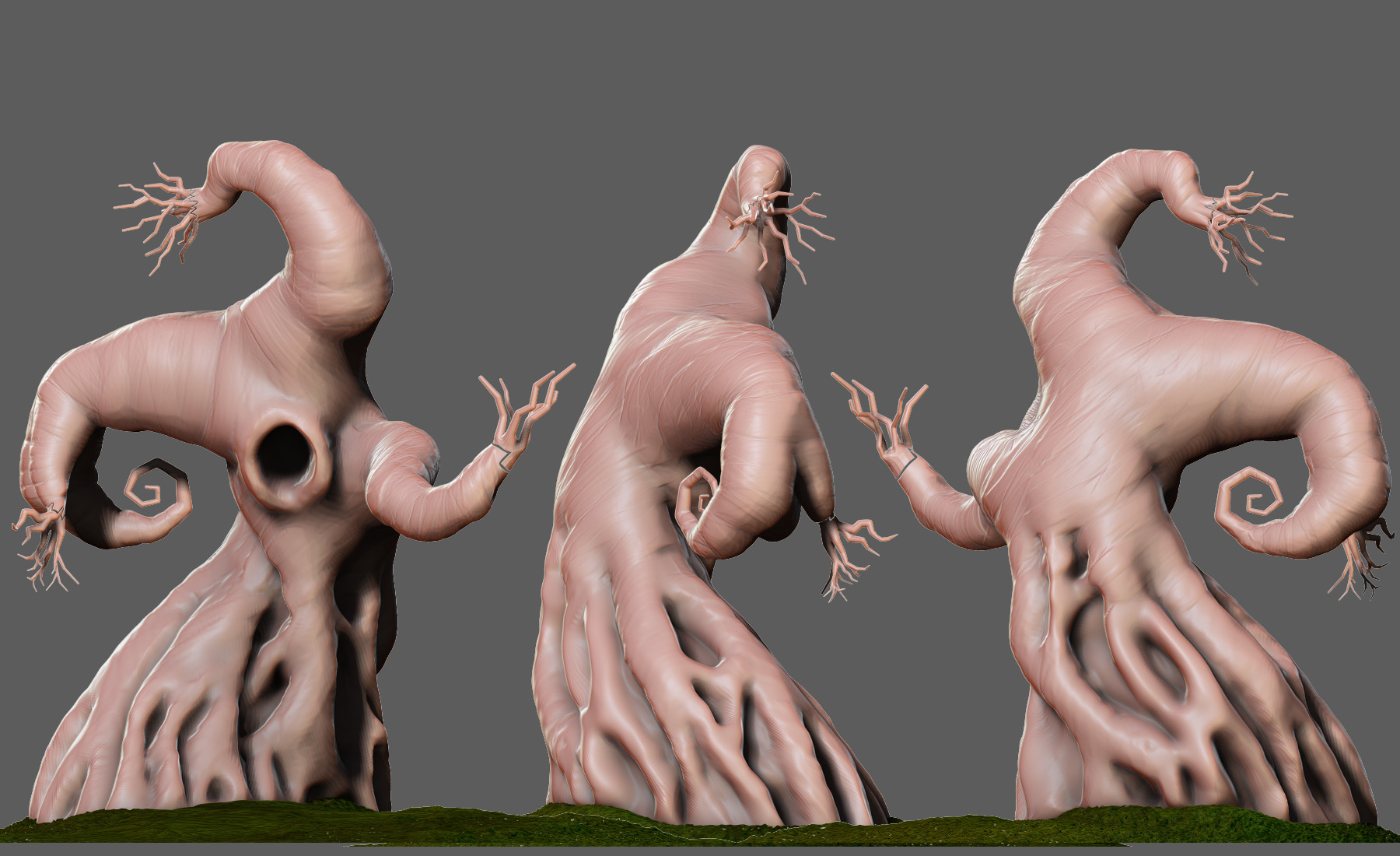

Finished all of the modeling for now (I think!). Any comments or crits so far guys? I’m hoping to actually put this one in my portfolio and get it printed after I paint everything, so the help would appreciated :slight_smile:
Thanks everybody for looking so far.
