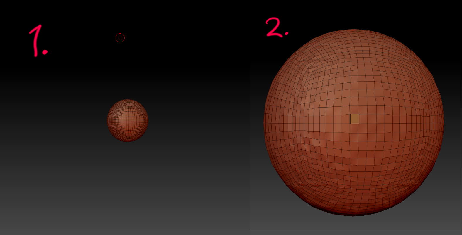

I have here a small object which im trying to model with ZModeler.
Only way to avoid most of rippling is to scale size of the object. Is there any other way to do this?

It happens at least with QMesh and Extrude functions. Objects varies from QSphere to PolyMesh3D Cylinder. I can repeat this all the time with projects no matter what is the workflow. The problem is that if object goes smaller and smaller, the ripple effect deepens. I thought this was some kind of setting problem in general.

I got it to happen too, you are using QMesh and Extrude to shrink your object right?
I think you need to use something else, that sort of not what they were intended to do.
Try using Scale in the Deformation Pallet, XYZ under Size in the Geometry Pallet or Scale with the Transpose tools.
All of those should work, differently from each other but they don’t wrinkle your object.
I actually LIKE what this does, I shrank a ZRemeshed sphere down ten or twenty times and then back up, its a neat effect!
It keeps all the wrinkles and stuff when you get it back to normal size so this is great for making semi-random lumps…

Using QMesh with PolyLoop:
  • If you work on a Sphere3D that has been PM3D’d things work fine.
  • If you Dynamesh it It works fine, effecting only one “polyloop” or in this case strip.
  • If you ZRemesh it things change, you will get odd effects, like what you are seeing, and others, for me the ripple thing only happens when I shrink the object a lot.
  • If you work on a Cube3D (or anything other than a sphere as near as I can tell) everything should work as expected.
So to decrypt what Doug may or may not have said, a pure ZRemeshed Sphere3D screws with ZModeler. Or something.

So after experimenting it looks like you can work with anything OTHER than a ZRemeshed Sphere3D and things work as expected.
Something odd about that…
If you sculpt it a little, and by little I mean a tiny amount, and THEN ZRemesh it it works fine.
This seems like a bug to me.
