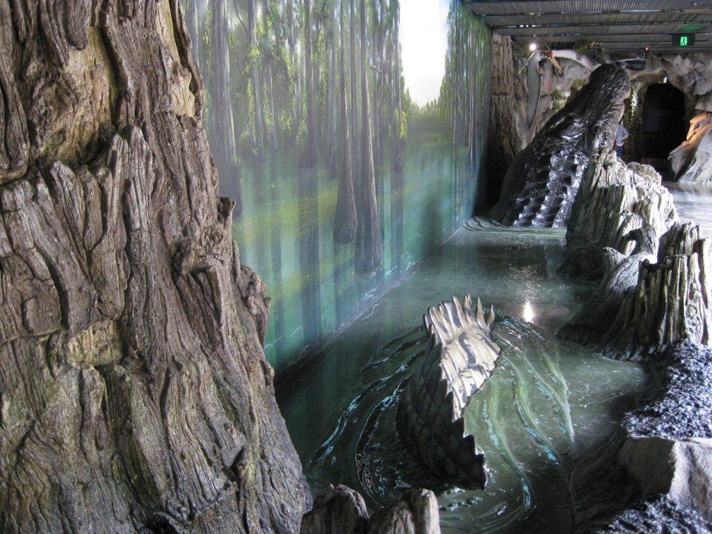

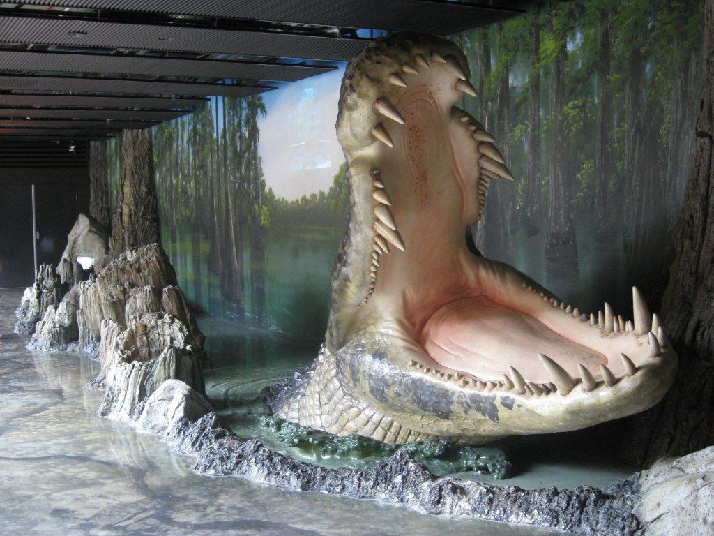

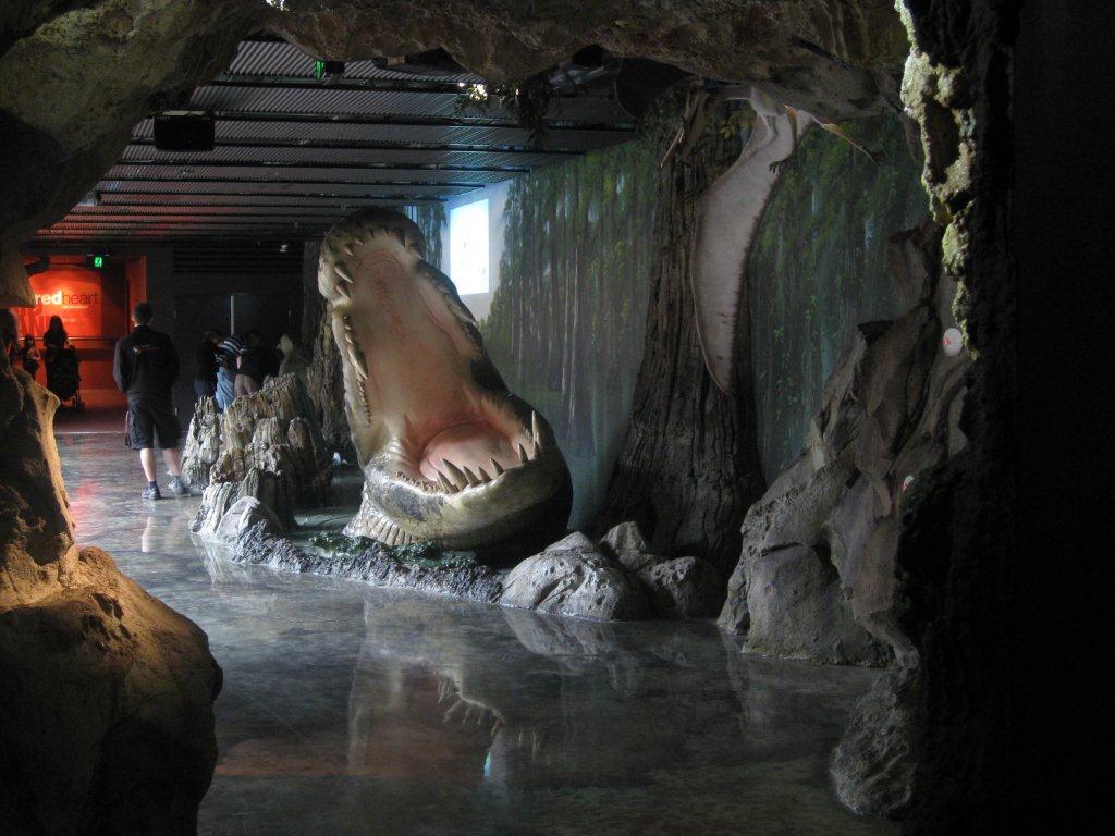

Here are some shots of the croc in situ at Wildlife World at Darling harbour in Sydney. Not much room to fit it all in.

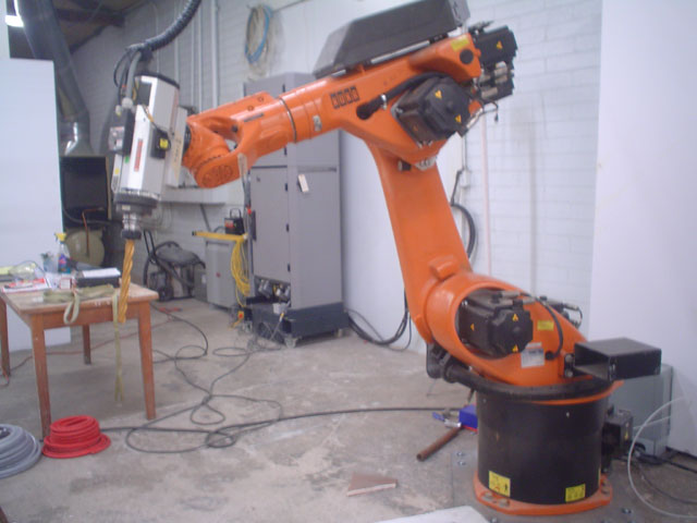

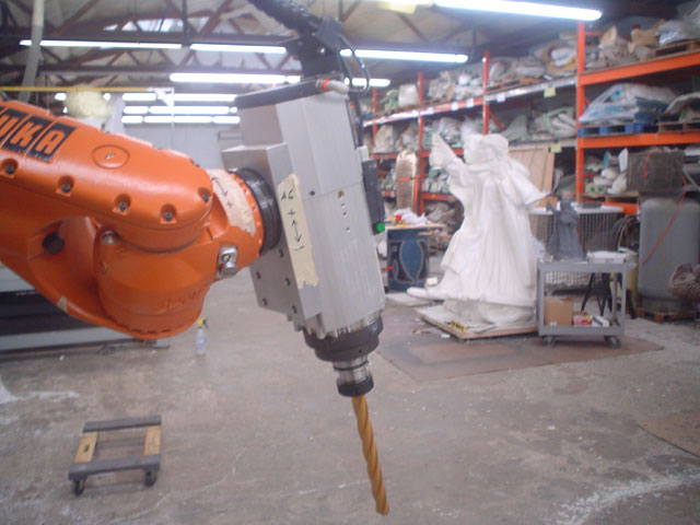

Here are a couple of shots of a newly installed robotic arm for CNC work. A little more headache to carve CAM files, but we should be able to get it running soon. I think I will ZBrush a model of itself to test it…

arbayne, it’s always exciting to get a new piece of gear. Especially a well built unit such as the ‘bot’. It’s break in period can also be very…exciting. :wink:

3Point14, 3, 4, 5 axis? Wood carving from ZBrush files is something I am going to try very soon. As far as an exciting “break in period”, one of the first movements I made with the Kuka was through the wall (didn’t even flinch, missed stud by “” that much). Quite a dangerous machine (moves faster than you would think). Post pics of your ZB to wood machine!
“one of the first movements I made with the Kuka was through the wall”
If you listen carefully… it can say ‘Wooosshhhhhhh’.
