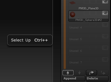

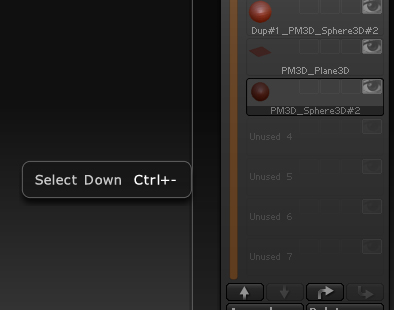

Well I was able to assign new hot keys for the down and up key in the subtool menu, I resigned them to the plus and minus buttons. So I have to hold ctrl and plus to move up in the subtool menu, ctrl and minus to move down. It still doesn’t disable this from key board though. I need to figure out how to disable the down arrow on my key board?

Maybe I’m not understanding. I go into tools subtoolmenu SelectDown button then press ctrl ,left click mouse and press delete.
then I press Ctrl .left mouse click , minus button to set new hot key.
After that I can press the ctrl minus to scroll down , but it does not fix the problem. the highlighter still scrolls down to the bottom layer by itself.
Also the down arrow key is still pressable and I can still mouse click it to move the layers down faster if i wanted to.
Sorry if I’m not understanding you right.

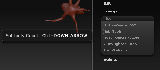

Hmm, yeah - I think the problem is you can’t just disable the down-arrow key because it is one of the standard hotkeys… but I think you can re-assign it where it (hopefully) won’t do any harm.
Try this (it works for me)…
Under PREFERENCES:Misc, - hold down Ctrl key and left-mouse click on Sub Tools item, then press the down-arrow key. That should reassign it, and isolate it so even if it is repeating, it won’t be doing anything. There might be some better buttons or obscure interface items to assign it to but at this point, just try it to see if it works.
As before, make the plus and minus keys into hotkeys for SelectDown and SelectUp… should work, and the down-arrow key problem should leave you alone.

“I think the problem is you can’t just disable the down-arrow key because it is one of the standard hotkeys”
I kept getting that message too.
I followed your instructions. You can see by the screen shots.
but no luck.
