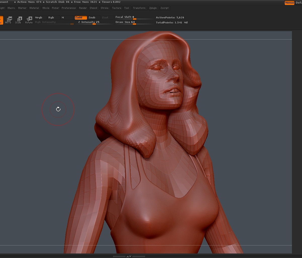

-We are still not allowed to polypaint in pure black with the flatcolor matcap (the red one is set automatically) :

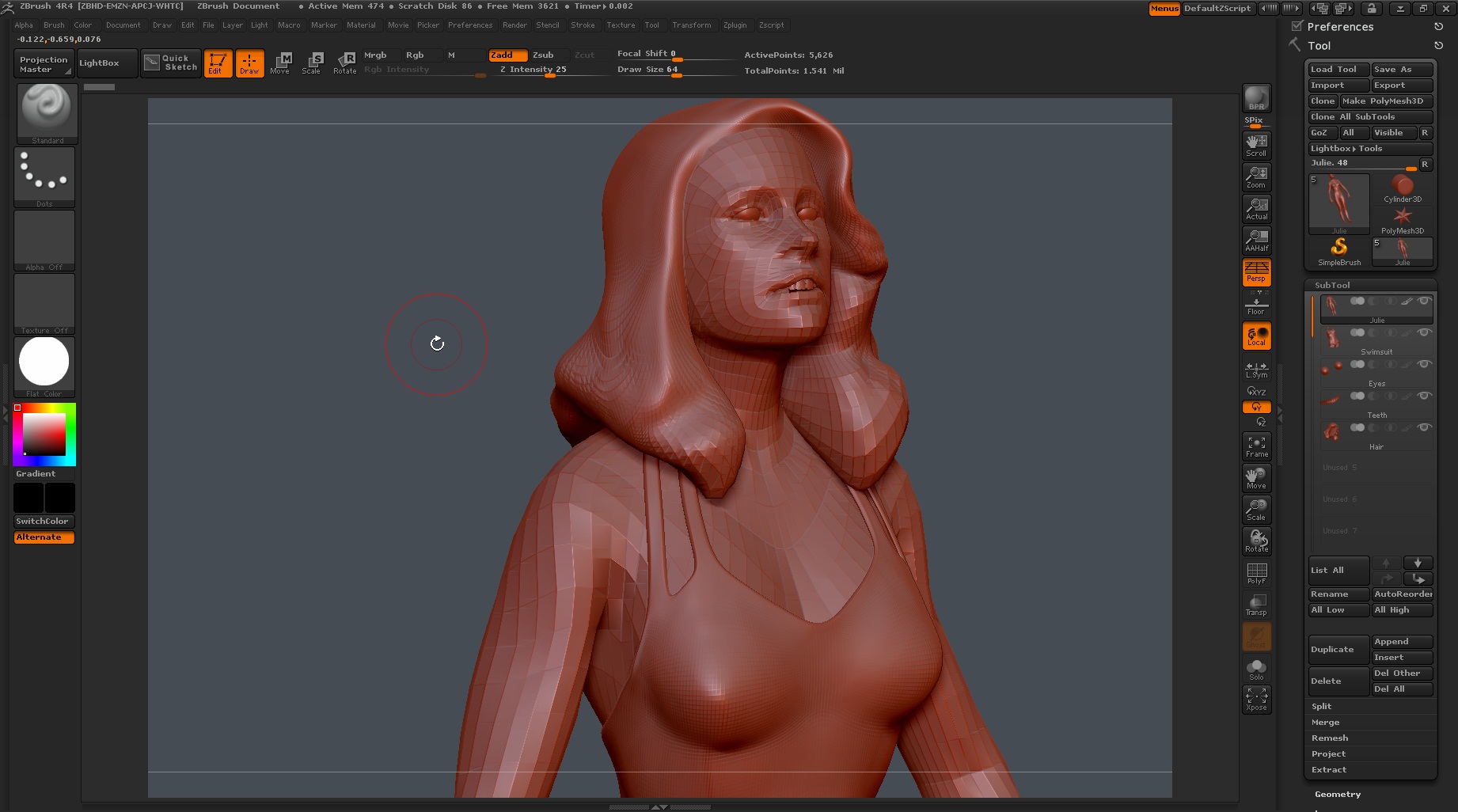

-zBrush doesn’t remember anymore the screen where you close it, zBrush always open itself on the main screen.
->Solved, I needed to store my config file.
-zBrush is always on top, which mean I can’t alt-tab, I need to reduce manually the window.
->Sometimes it works, sometimes no. A bit weird
