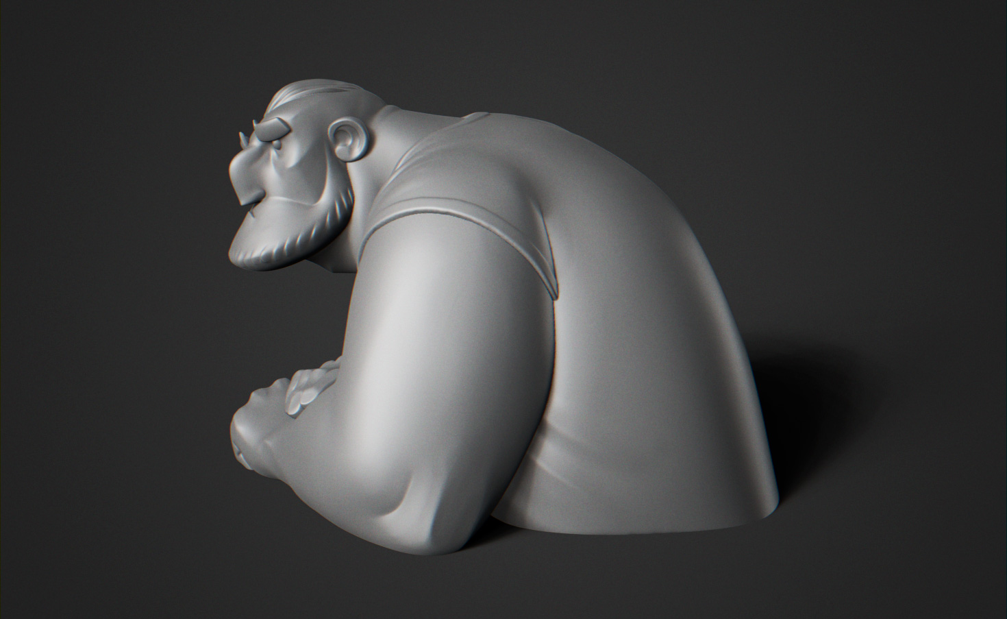

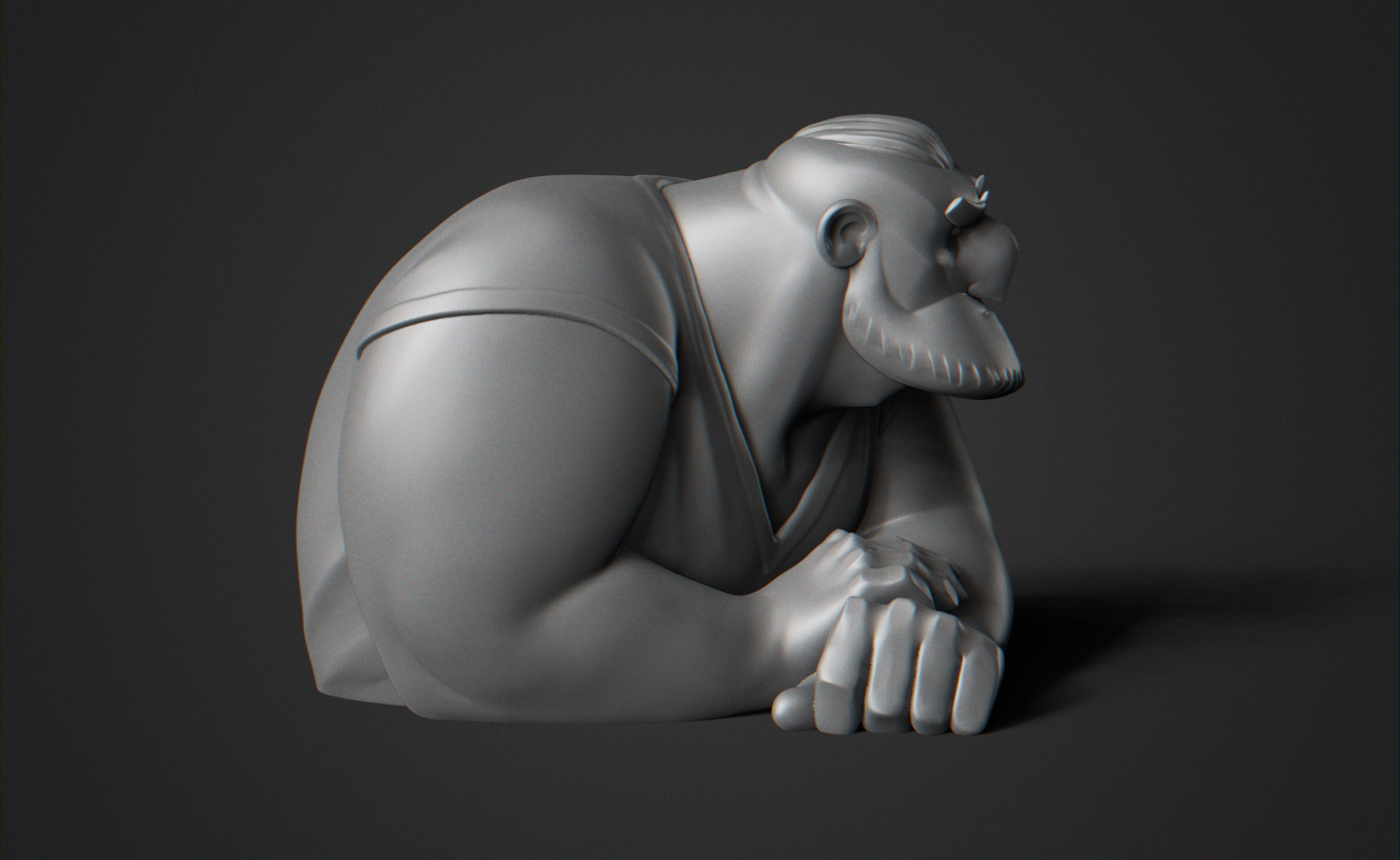

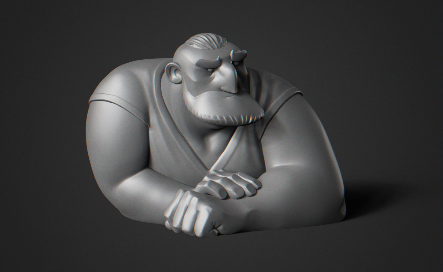

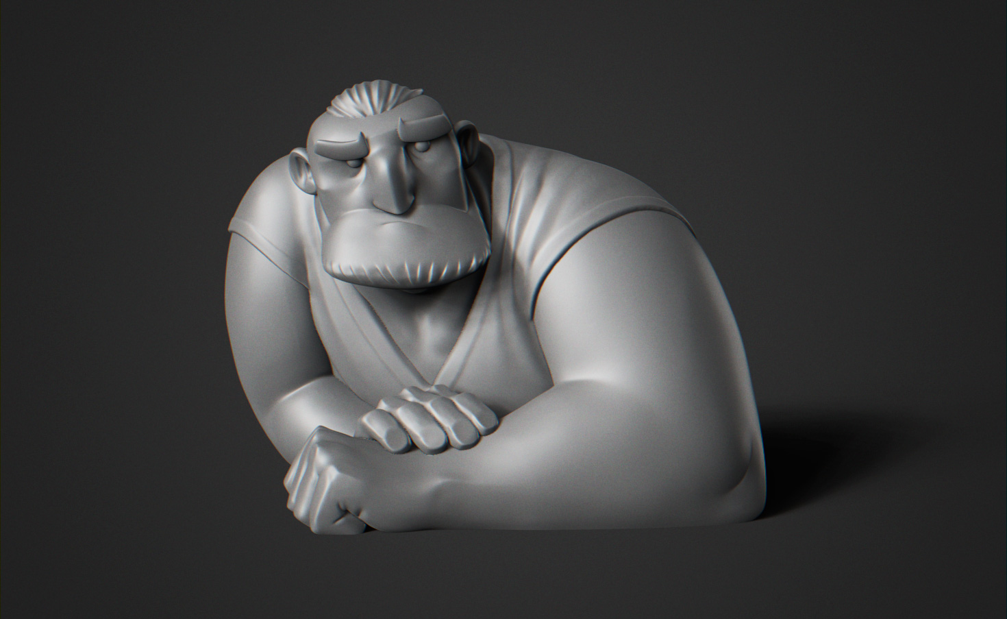

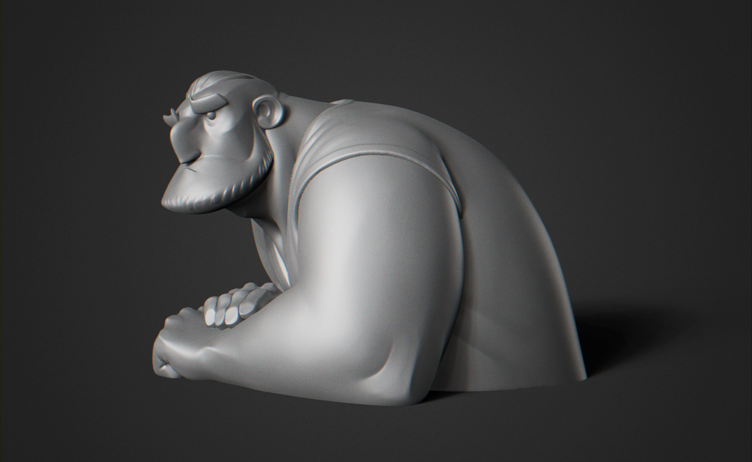

Videos as promised.
Turntable
<iframe src=“http://player.vimeo.com/video/29826220?title=0&byline=0&portrait=0” width=“888” height=“555” frameborder=“0” webkitAllowFullScreen allowFullScreen></iframe>
Sculpt
<iframe src=“http://player.vimeo.com/video/29826669?title=0&byline=0&portrait=0” width=“768” height=“480” frameborder=“0” webkitAllowFullScreen allowFullScreen></iframe>

I think you used about every technique zbrush has available. Nice work and thanks for sharing your sculpt vid.
Yeah I was trying a lot of different things just to get a handle on a number of techniques. It’s not how I would usually do something like this (typically involving ZSpheres or a rough Maya base mesh), but I’m starting to see how some of the new tools can do things to augment the ways I usually work. Like for example, I use Project All fairly often. On Egg Man’s eyelid, I did the expected Dynamesh remesh on it after adding that hemisphere piece. But before I did, I duplicated the subtool. Then I used that to Project All my details back on, because what I was finding was that I lost the sharp geometric shapes I liked from the hemisphere if I went the Freeze Subdivisions route. It’s basically the same thing but with more control. I know I’m going to use that a lot. It’s nothing revolutionary, but it just opens up a lot of options and could be good for hard surface modeling.
