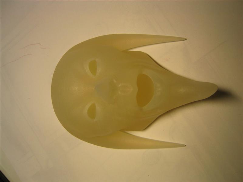

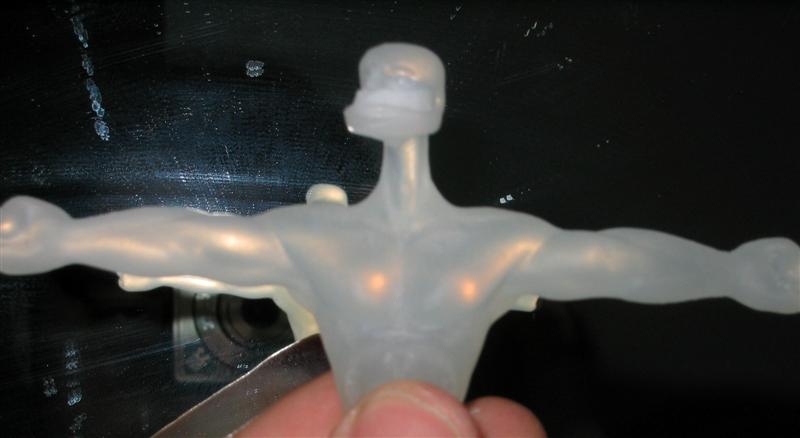

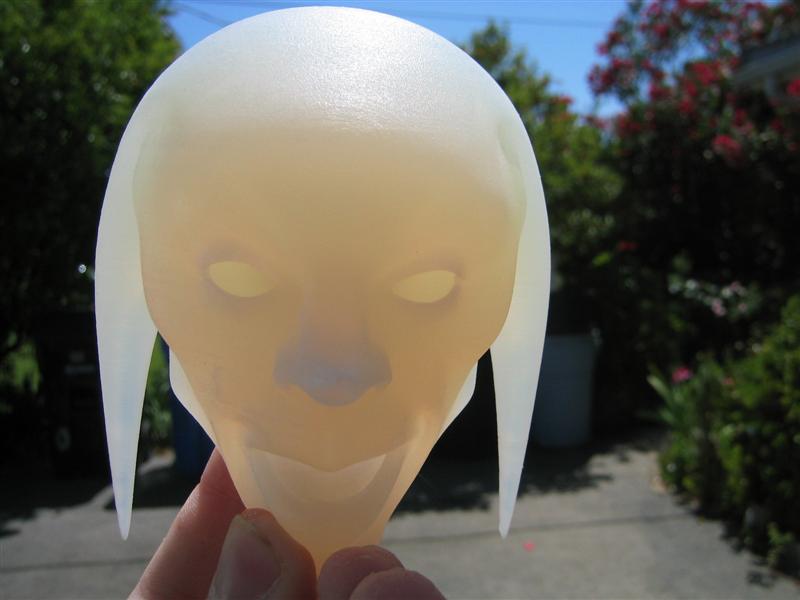

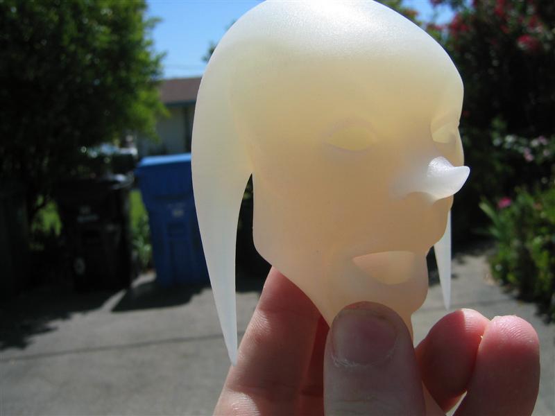

I printed these for taron on the envision printer at DesignWorks in thousand Oaks. It prints in A_B Urithan. I had a decent number of polygons and then I converted them to Nurbs with Maya. From there I can bring it into Solidworks and make bosses and fittings.
You are using the Zcorp Wax printer?

wow! what a fine print !!! i’ve heard of envision, it cost a lot more to print
in zcorp. if i’ve the $$$$ i’d want to try it in future !
did you use GeoMagic for the nurb conversion?
also, what are the bosses and fitting about? is it for buildiing the mold and cavity purposes?
What machine did you use to make these?
Envision is cheaper then Zcorp.
You guys can ask taron to post more pictures on his site as the mask belongs to him. He has it next to his computer :slight_smile:
At Art Center, where I am in my 6th term ( going on exchange to Israel next term) I learned of how to do amazing rapid Prototyping and produced some amazing things creating all sorts of techniques to get my LW/ZB models into a SoildWorks based file.
It goes like this, Model in LW, Bring it into Zbrush. Get dense enough with your detail and then export your mesh OBJ to MAYA. Use maya export convert Poly to Sub D, Sub D to Nurbs. Then bring it into Soildworks and from there you can make hinges, pivots and all those things to make a production based model. This is the technique I created and I hope you can replicate it…

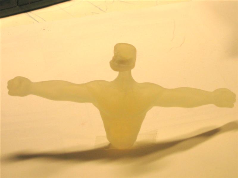

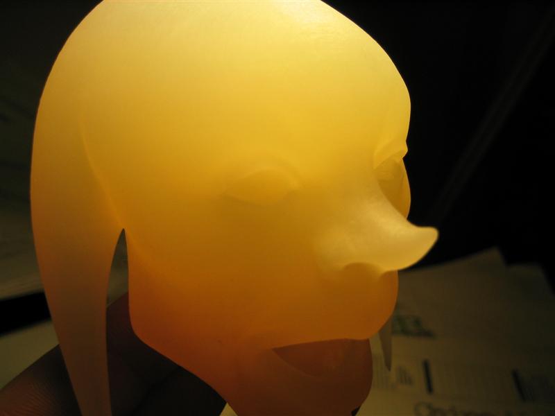

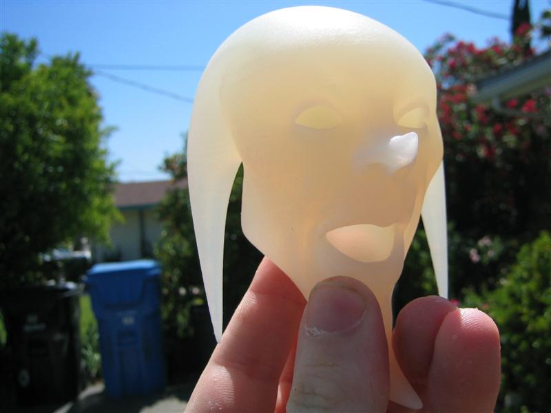

Shortly thereafter we did some prints of butch. This was taken straight out of messiah, meaning directly from the frame in the animation using messiah's exporting functions. I gave this to Neville Page. [![006 (Medium).JPG|800x600](upload://9ueXJw2zjxsZ0njsBW4zgZJsxYf.jpeg)]

Just so I make myself clear, the reason I use Solidworks is so I can make my molds digitally and tear apart the model to attach things. Its an extremely powerful program, I like it.

DesignWorks in thousand Oaks. Nice people there. They have an envision machine there that can do models pretty big. It also prints faster.
The machines themseleves are usually leased because of tax benifits. They run anywhere between 40,000 and up.
