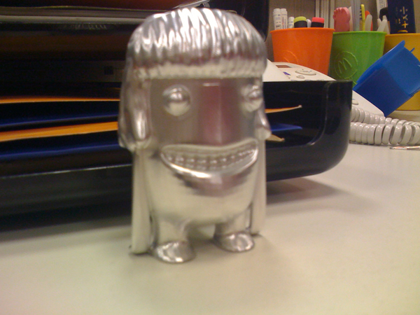

But I need to make the mould from what I’m exporting from ZBrush, and in rhino I can’t work it to make the two parts. I made a prototype in the machine of the toy, but what I need now is to make the molds, so I can make the toys in plastic.
What I import in rhino from ZBrush, I can’t make operations as booleans. That is what I need to make the two parts of the mold.
Here I upload an image of the prototype made in aluminium.
