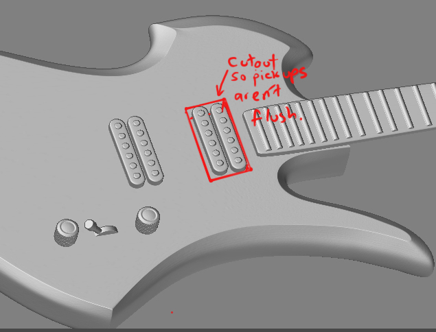

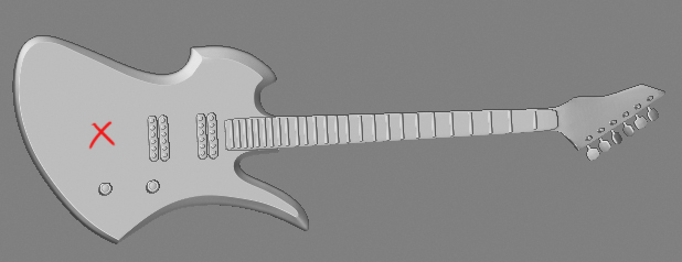

Guitars coming along nicely but I’ve run into another problem. I’ve changed the preview angle under the guitar tool so when it is first drawn it is coming in like the first pic. What I need is to change it back so it looks like the second picture. Now I know I could just change the preview again so it looks like the second picture but is there a way to get it exactly right. I need the preview so the main face of the guitar is dead flat on to me when drawn.
… move the little red cross + Shift :wink:
hmm doesnt seem to snap it to dead flat when over body. I’ve been playing around and could probably make do for now with doing it by eye. Annoying though.
you could try under TOOL/DEFORMATION - UNIFY
Tried that already spaceboy. No joy unfortunatly. I can get away with lining it up by eye for now but it is a pain as I was going to cutaway some of the body by the pickups and if if was exactly flat I could edge loop then offset on z axis but if its not dead flat the offset won’t go straight down.

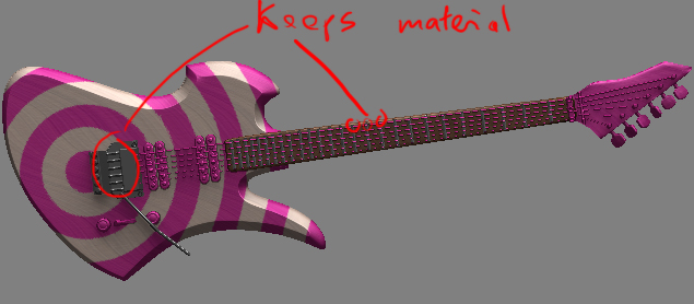

Dammit I was hoping not to post here again but best laid plans and all that. After finally getting my head around texturing (sort of) I’ve started to put graphics onto my guitar with auv tiles. So far so good.
My problem is when I drop various parts in projection master giving them a material it changes other parts to the same material when picked up. E.g. I drop just the neck which I select via a polygroup so everything else is hidden. Using the material pack 2 I select one of the woody materials and click material in the projection master. It gives it the material ok when I paint it but when I pick it back up and reshow everything else the body has become wood as well instead of what I already had projected onto it. Weirdly the bridge and frets I have given standard default metal materials which come with zbrush keep their material.
I’ve tried masking before dropping in projection master but still get the same result. Anybody solve this one for me?
The problem is you must make sure you are using a different material. You are using 1, then painting another, but Zbrush only sees the last one. So make several to start, clone or copy/paste. Then assign the info to each, each will totally cover your object (guitar). Then when in PM and painitng choose the correct one for certain parts of your object. Then when you leave you should be OK. Zbrush like many apps can only have 1 attached at once. Technically. Workarounds exist. You can search the forum for various solutions people have used. I’ve done some hair tests a few years back, had 15 hair materials to work with, each slightly different. Painted them in PM, then they all appear in the render, sorta tricky at first… :wink:
Thanks for the reply Jason. I think I understand, I’ll just have to practice and experiment more. Amazing how a something new and seemingly so simple can just flummox you. Somehow I got it to work a moment ago but for the life of me can’t figure out how. Gah.
