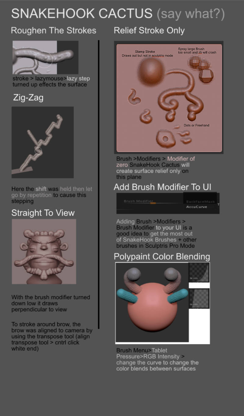

Attached some quick notes on the SnakeHook Cactus Brush as well as a Move Elastic Brush adjusted for working with low Rez quad meshes from ZRemesher (not for Sculptris Pro triangular meshes) .
Move Elastic_LowRez.ZBP.zip (9.87 KB)
Whilst this brush is good for shape design adjustments it’s particularly good for adjusting mouth shapes with good loops e.g if you have created a suggested mouth bag to drive the zremesher process with regard achieving circular loops around the mouth. From a side profile it will help you grab the nasal septum and the philtrum to help with the correct curvature and projection of the top lip. From the front it will help with smile/frown shapes as well as pinching the mouth closed. For more fulsome lips the mouth can be further closed or enhanced by dabbing the inflate brush with a low focal shift -64 from a front view.
SnakeHook Cactus Notes
The Polypaint color blending I thought was cool :slight_smile:
