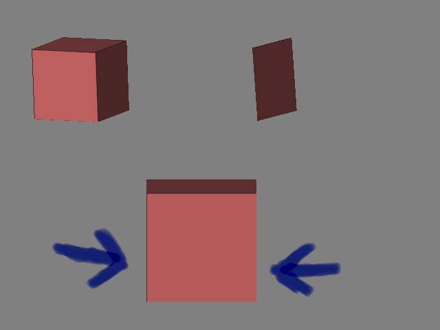

I’m keep on working with edge loop tool and… uf!!! is a bit dificult, so I’ve a question ( sure the answer is very easy )
I’ve a cube 3d and select one face, but how can I select the opposite at the same time?
Thanks for your help!!!
See you later
i’ll try to help you out as i’ve been doing quite a bit with z2’s edge loops of late (or trying to at least).
what you should do if you want to work on the opposite face as well is keep the opposite face visible and turn on symmetry on the axis you’re editing.
quickest way to choose to opposite sides would be to center up your cube then use the ctrl-shift drag method but let go of the shift key first so it turns red to hide the parts you don’t wish to work on at the moment. Make sure you ctrl-drag down the middle so that the two sides you want are not chosen.
It will help to turn on doublesided you can see right away if you hid the parts you want to hide and the only visible pieces are the sides you want to edgeloop.
