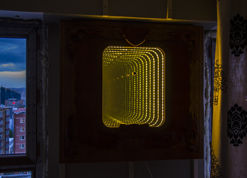

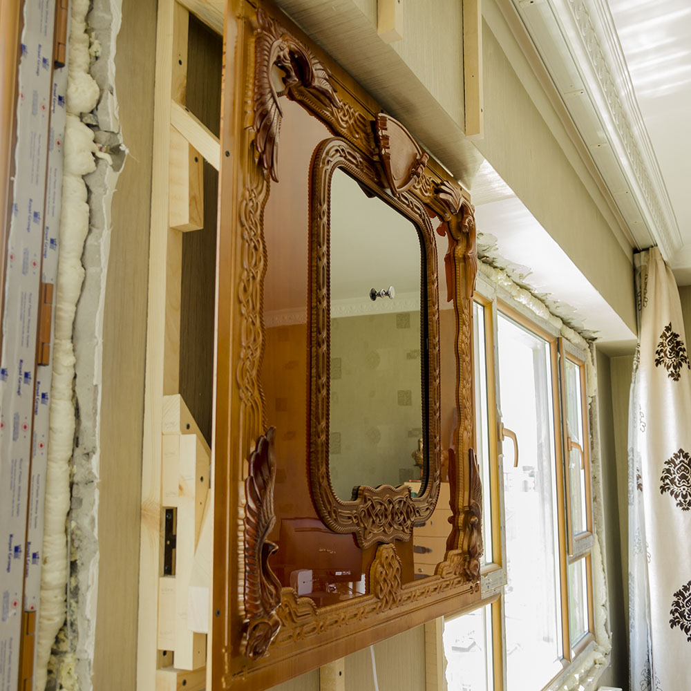

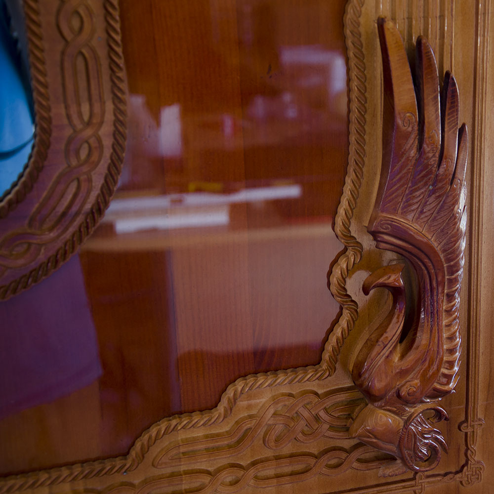

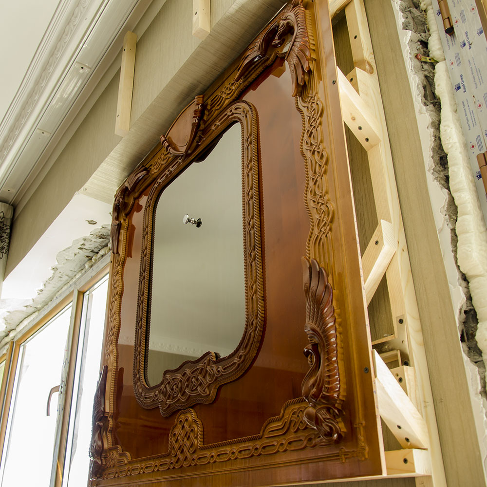

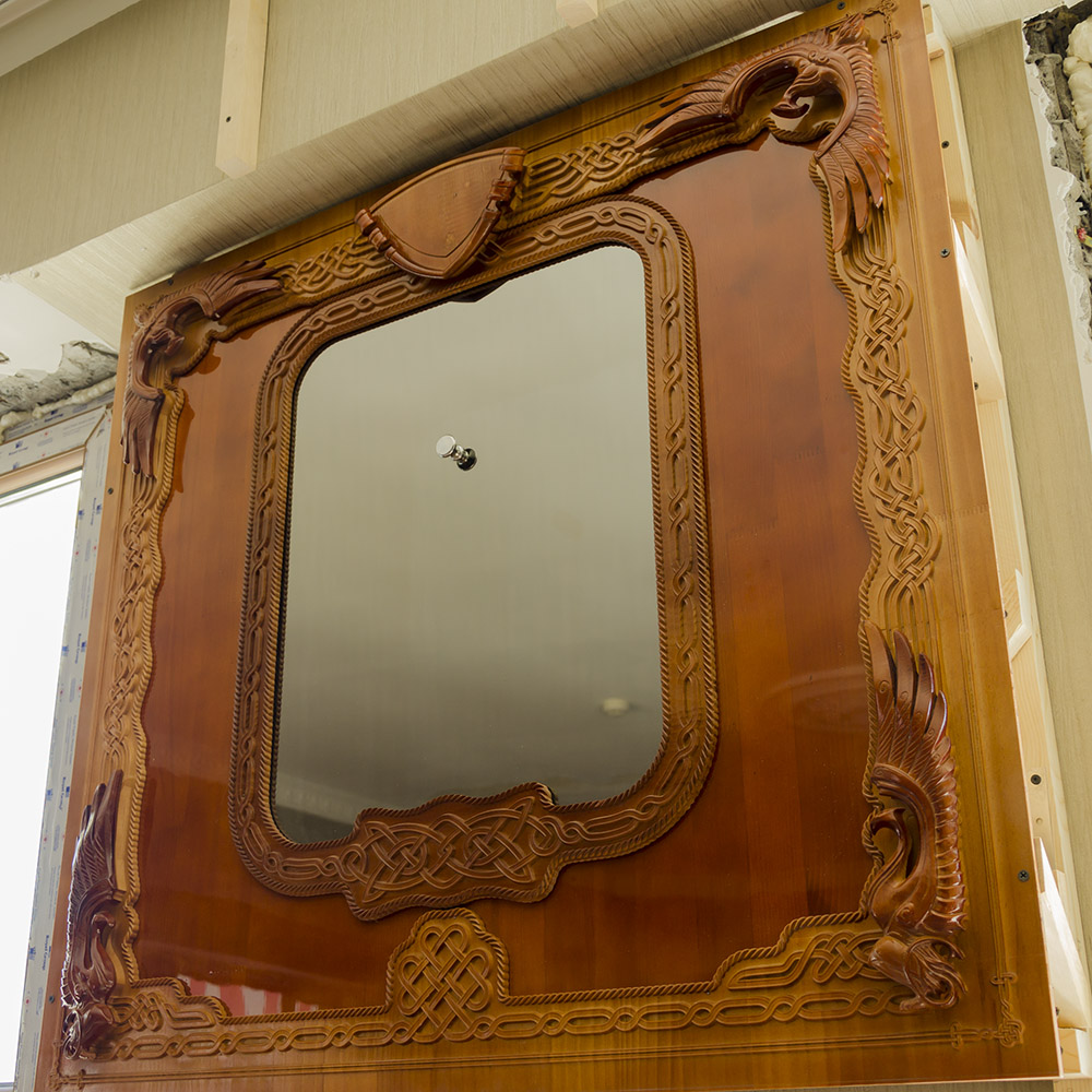

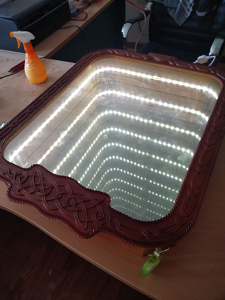

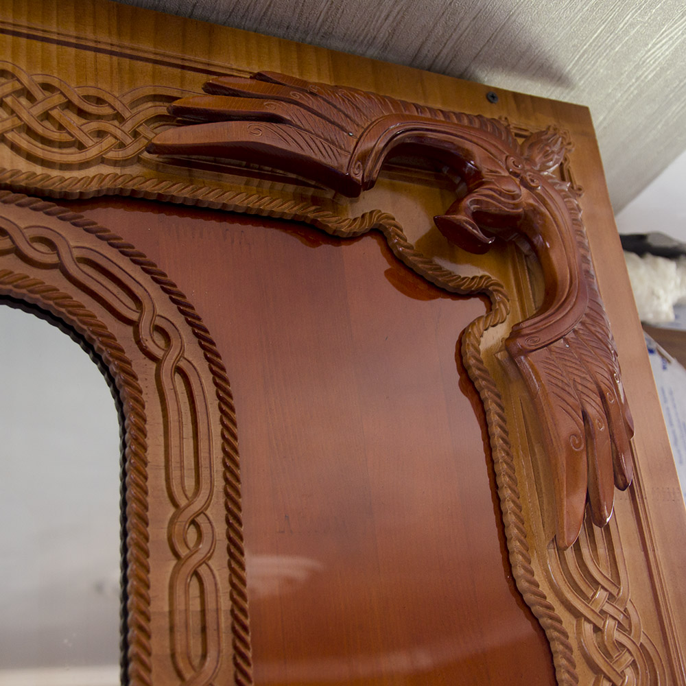

The painted parts are assembled. As you can see in the last photo, the center is not only a mirror, it turns into a portal, when the light is turned on :).

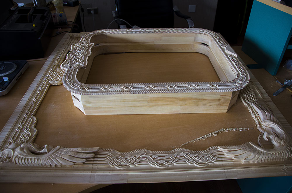

Some more progress photos of the project.

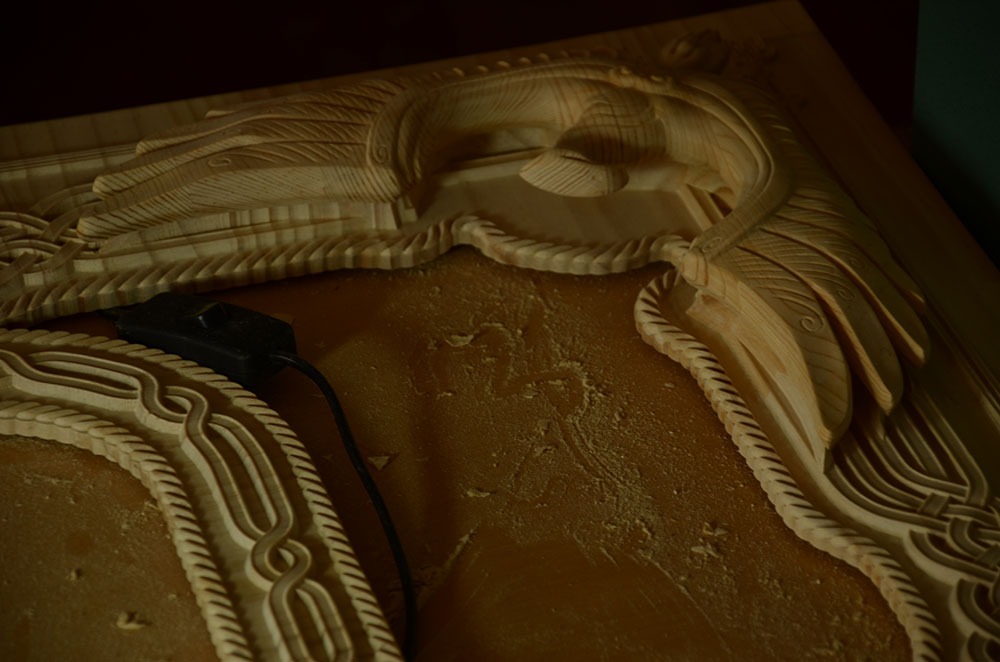

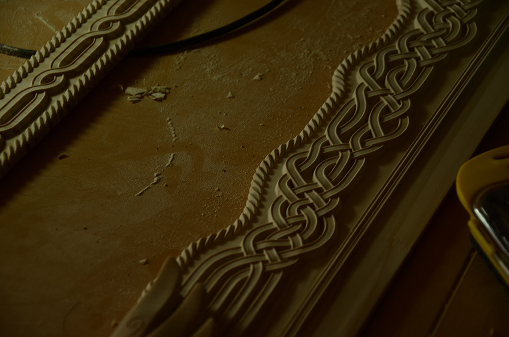

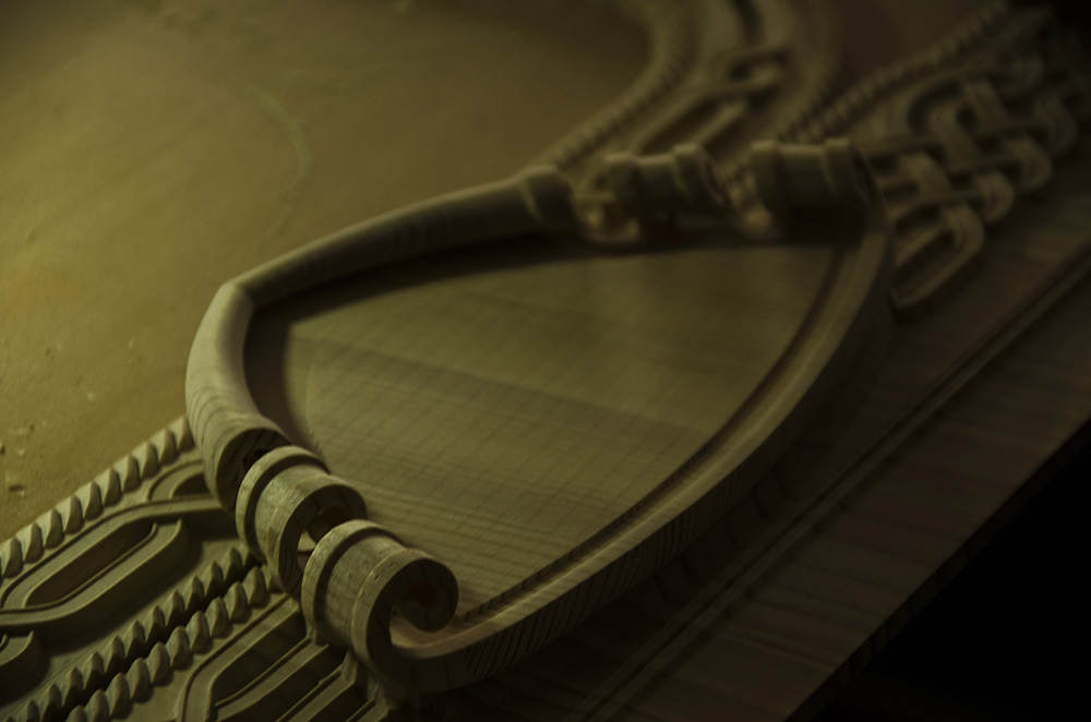

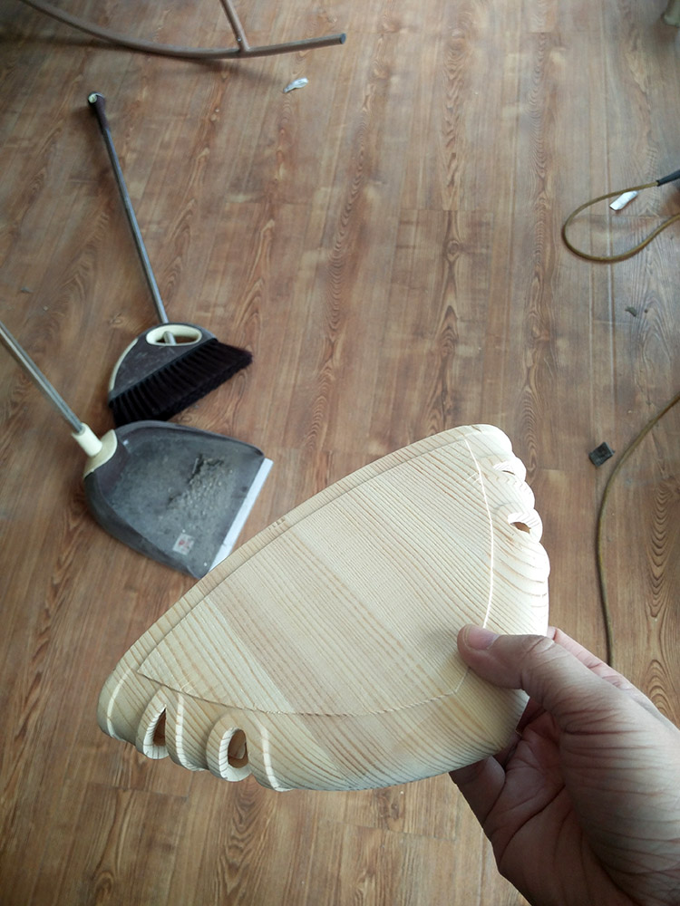

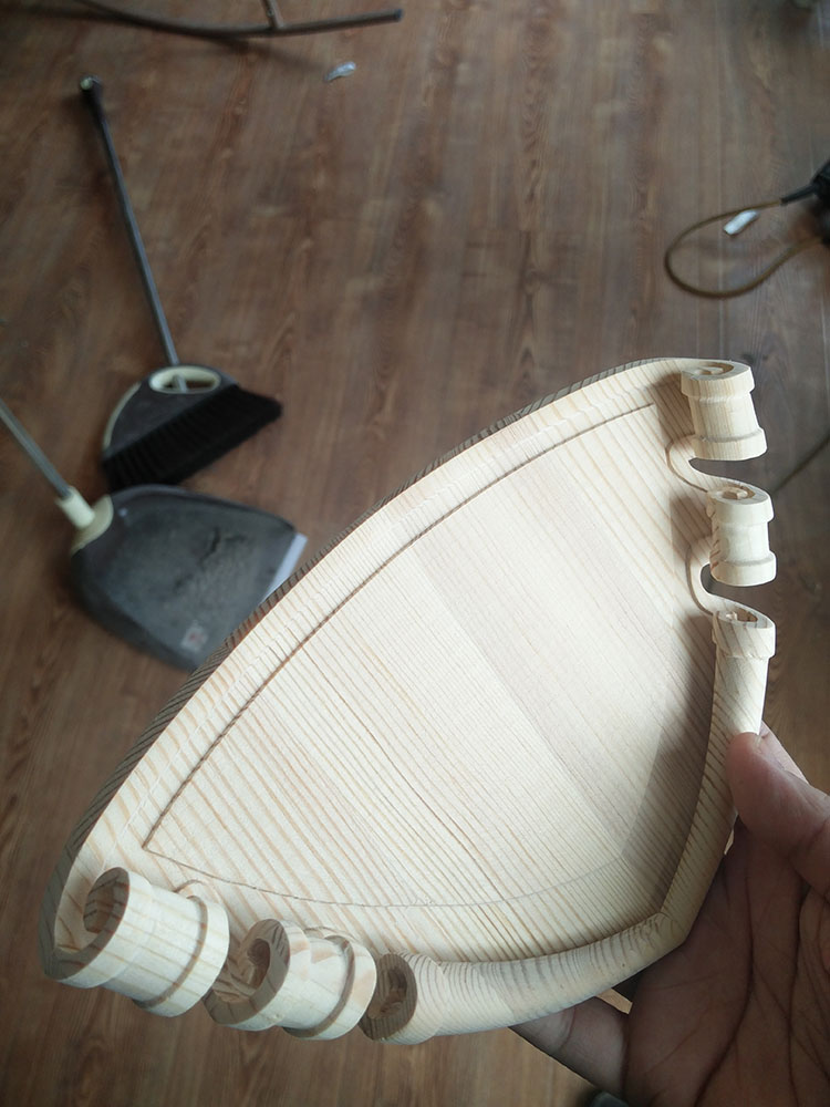

This piece is machined with the simple 3 axis CNC carving both sides of the wood.

This is real great work, well done… if I may ask, what router are you using as I will be purchasing one, but scared I buy a dud… love what I see and give me hope, still don’t know how you got the hollow parts on the shield as I assume you are using a 3 Axis?
@Sigmund Hentze
First of all, thanks for your compliment. I don’t have a branded or super fancy CNC router, in fact, it’s an unbranded imported one from China. Although the work area is big, 120x240 centimeter, a 3 axis machine. But with 3 axis CNC, you can carve from both sides, carve and when ready, flip it and carve the other side. Of course, there must be precise calculations happened, otherwise your 2 carves won’t match, if you see hollow parts in my works, they are carved from both sides and/or partly done and assembled. Depending on where you buy your machine, your life actually could be easier than mine. Mine bundled with a Chinese software, the interface is in english and the documentation is auto translated from Chinese, from zero to very little helpful, because of that. There are free programs like mach3 etc, if you are a beginner, i suggest you to learn and use programs, which internationally supported. Chinese CNC machines are actually compatible with international programs like above mentioned mach3. but i already comfortable with the bundled one now. I made some mistakes like, breaking the bits, miscalibration etc at the beginning, i think you will do same things, but no worry, i never had any instructor or experts to teach me, but here i am now :-). Good luck.

Would really appreciate it if you could share photos of your fixtures and techniques for gripping the stock while cutting the other side so as not to damage the first cuts.

Thanks. For the 2 sided machining, i always draw and define vector areas (in Adobe illustrator) and tell the router, which areas should be machined first, so the router does not machine away just everything mindlessly. And for the backside, i always machine 1 mm less deeper than it actually should be (sometimes 2mm, when i want to be extra careful), and this way the parts won’t be completely separated, when the wood isn’t deformed, 1mm thick edges can hold the entire parts sturdy enough to be machined from both sides, speed is important too, fast moving big bits can break the 1mm holding edges, but for the finishing passes one always use thin bits, so not really dangerous with them. After it’s machined from both sides, i separate them using handheld dremel and sand the excesses.
